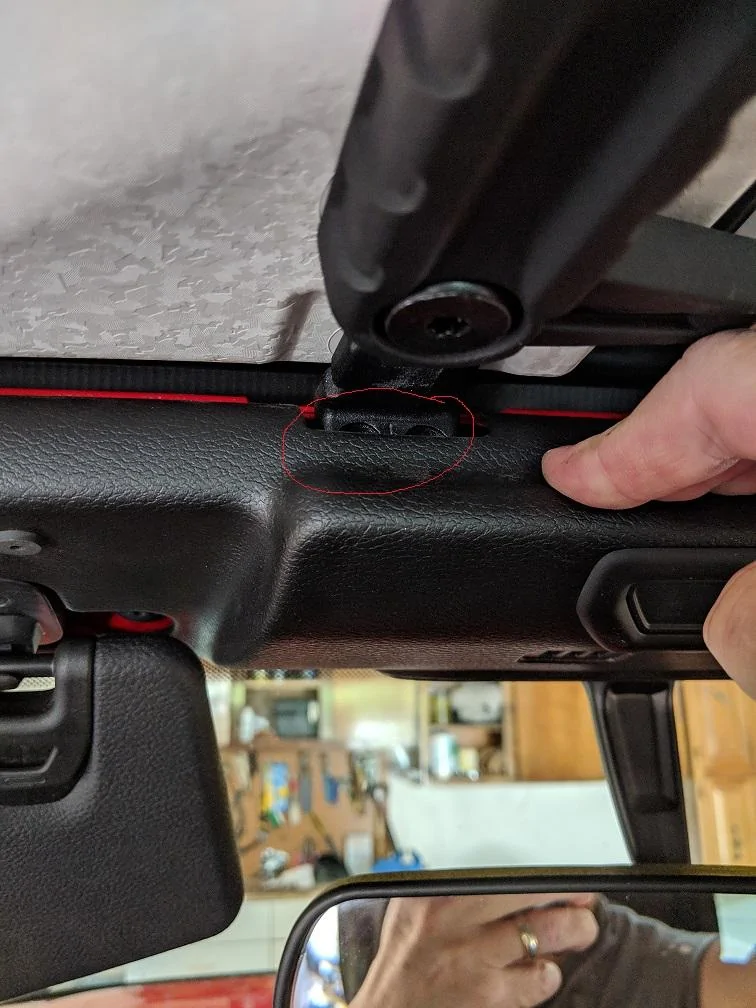

Hate to take this all the way back, but I can't access the specified Torx screws. I don't see how it's possible to pop down the trim panel. Maybe I'm not trying hard enough but don't want to break it. Has anyone done this?
Torx screws are just to the left of my finger in this picture.
Yeah...you just have to pull down harder to sneak in the torx wrench. Do worry it wont break:) I just adjusted both my panels down to the lowest setting as the holes are slotted...didn't seem to help any with the wind noise though.

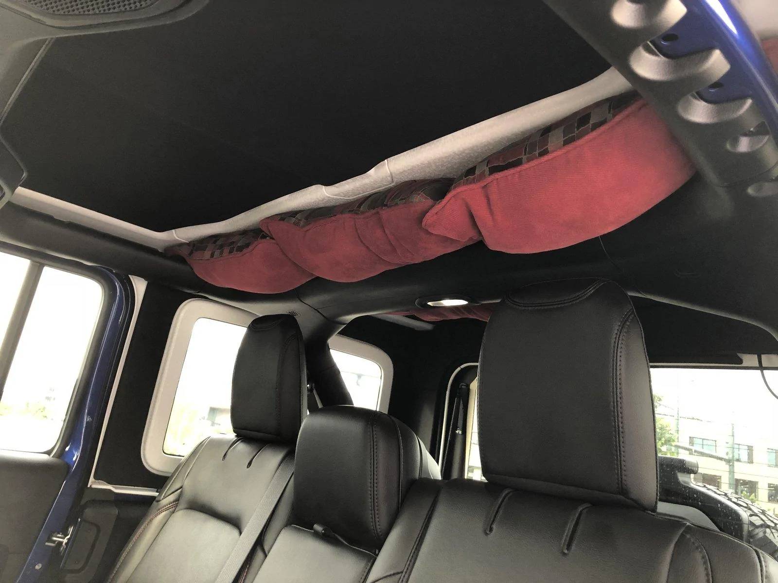

Within driving a 100 feet in my new 2018 JL Rubicon I noticed a buffeting sound. The sound is similar to what you hear when you open one rear window driving down the highway, some have described it as a helicopter sound, low frequency and more of a feeling vs a loud sound, hurts in the ears and head. The sound is rather invasive for me and is most noticeable driving at slow speeds. Bumpier the road, the more buffeting that seems to occur.
Trying to diagnose the problem I tried many things:
  • Reseated the freedom panels
  • Reseated the windshield
  • Reseated the hard top and verified bolts were tight
  • Inspected all the door seals
  • Verified the windows rolled up all the way
  • Sound intensity didn’t change with AC on fresh vs recirc
  • Opening windows a little bit didn’t change the intensity
  • Even with all the windows open I thought I could still hear it although much harder to notice with the additional noise from outside
I had a feeling it was from the hard top flexing as the Jeep went over bumps in the road. I test drove a different JLU Rubicon from the dealer and heard the same sound, this provided a little data that this wasn’t isolated to just my vehicle. A couple people from the sales team said they could hear the buffeting but apparently was difficult for them, perhaps hard to describe the sound or it impacts everyone differently.

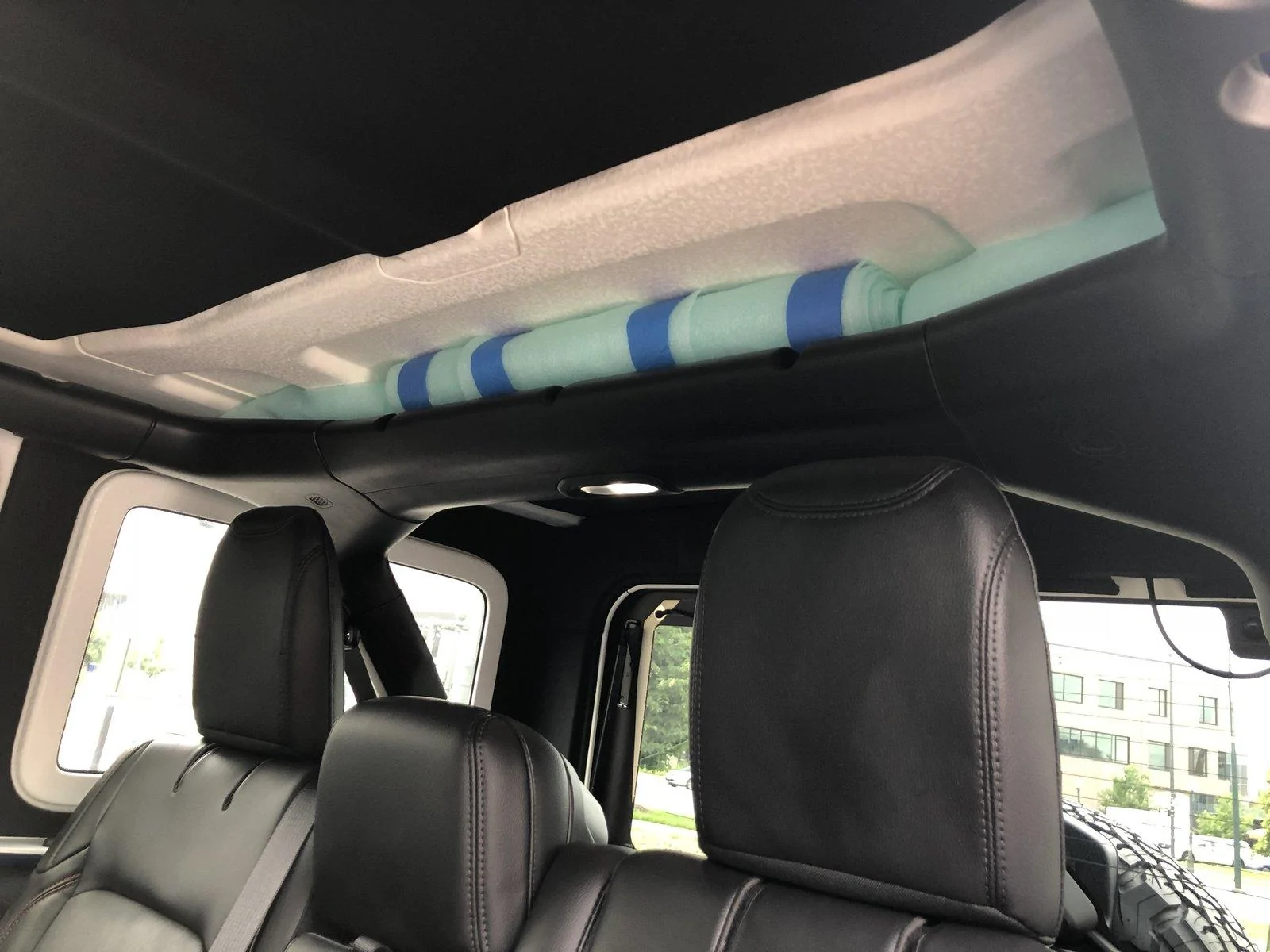

To test my theory of the flexing hardtop I took some hard foam and pillows to wedge above the roll cage and support the hardtop. Adding support over the sound bar didn’t make a difference, adding support over the rear seats made a huge difference! The section over the rear seats is the largest unsupported section of the hardtop, the pillows would push up on the hard top as well as limit it’s movement driving down the road. First time in a week of owning my JLU Rubicon is silent!! Normal road noise, etc is audible abut the buffeting sound is gone or severely limited. Driving to work the next day was glorious!! The JL really is a solid and silent vehicle, I’m impressed.
Although pillows shoved over the roll bar isn’t a long term solution it does focus efforts for the dealer to find a solution. My guess is the lighter hardtop doesn’t have as much material to prevent this type of movement. Not sure on a long term solution, seems that is up to FCA. For now I replaced the pillows with packing foam to provide relief pending a real solution.
Hope this helps others who hear the buffeting sound gives a test to see if they have the same hardtop flex issue. I’ll pass this info along to the dealer on my visit to get it documented.

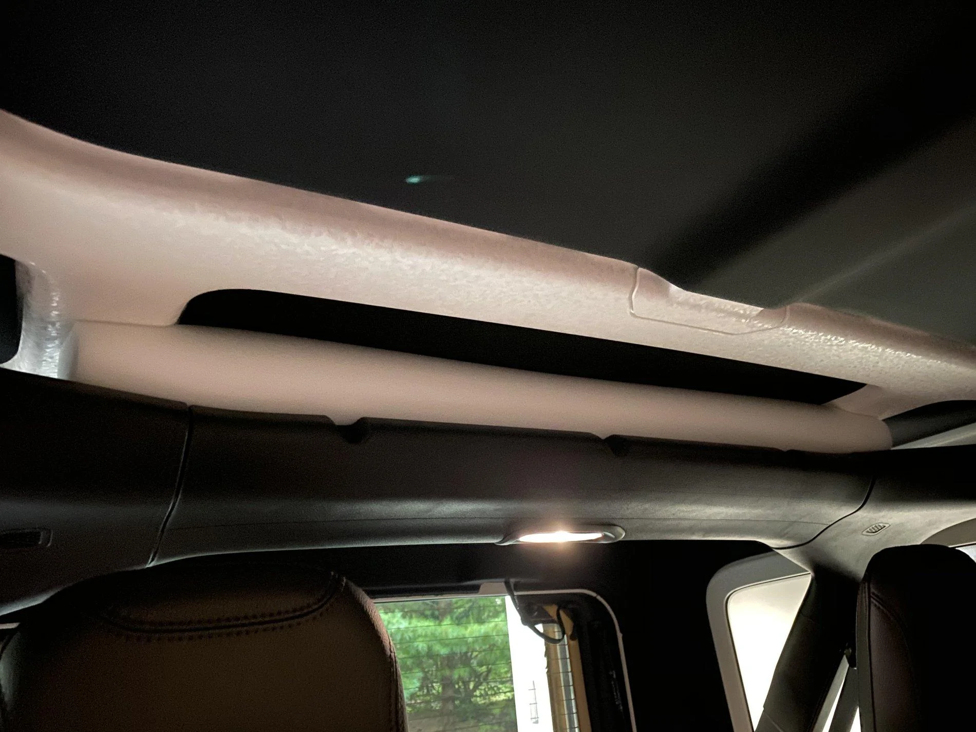

Has anyone found any new solutions to this problem. Specifically, the issue with the buffeting feeling. I adding padding to support the roof and that helped but it is still there. I was considering getting the bestop sunrider. I was hoping that would allow at least some flexibility and reduce the buffeting even more. However, I want to find a real fix that doesn't make me hate having a hard top.
I noticed the hardtop buffeting sound the first day home and ended up with this long term fix. A 3ft by 3inch round piece of foam. It secures the hardtop on the two ends with pressure and eliminates the buffeting entirely. I later inserted sound inserts as an extra measure but this foam roll did the trick to stop the buffeting.
That is a shame you had to do that. My 2020 JLRU with the hardtop is very quite with NO buffeting and in the 6 weeks that I have had it, its been on the highway a lot and up to 85 mph, back roads, etc. I have no issues, and this is my 3rd Wrangler and 2nd one with a hardtop.
Take yours back. Something is wrong.
