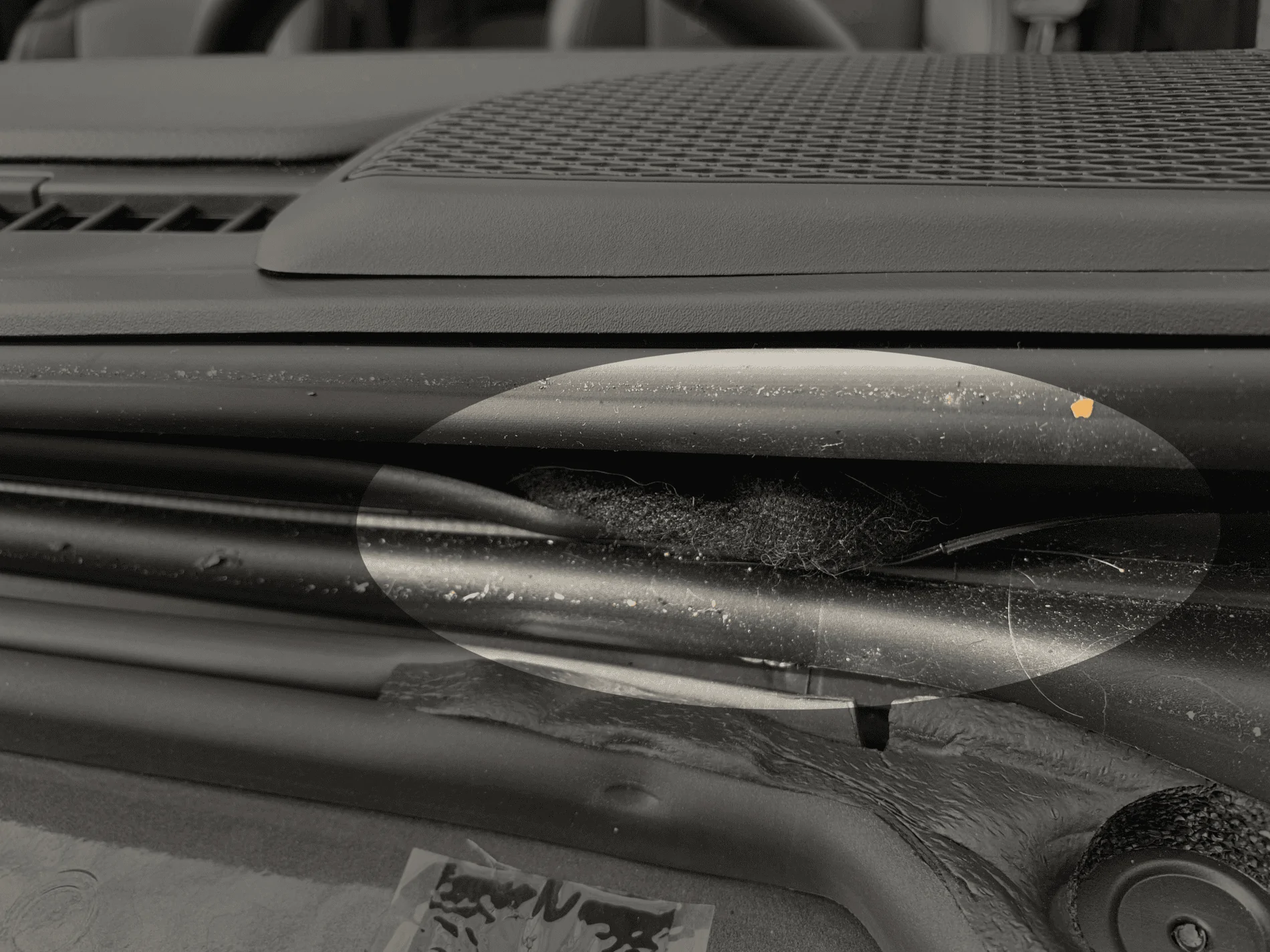

Hate to take this all the way back, but I can't access the specified Torx screws. I don't see how it's possible to pop down the trim panel. Maybe I'm not trying hard enough but don't want to break it. Has anyone done this?It's kinda self explainatory, but look at the middle latches on the freedom tops (mirror area) , the clip they latch to can be adjusted down (slotted)with a Torx screwdriver. The trim panel "pop"s down for easy access. A little movement goes a LONG way..
Seguerski did a good video on youtubeHate to take this all the way back, but I can't access the specified Torx screws. I don't see how it's possible to pop down the trim panel. Maybe I'm not trying hard enough but don't want to break it. Has anyone done this?
Torx screws are just to the left of my finger in this picture.
