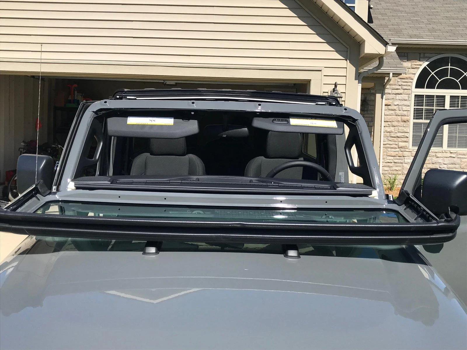

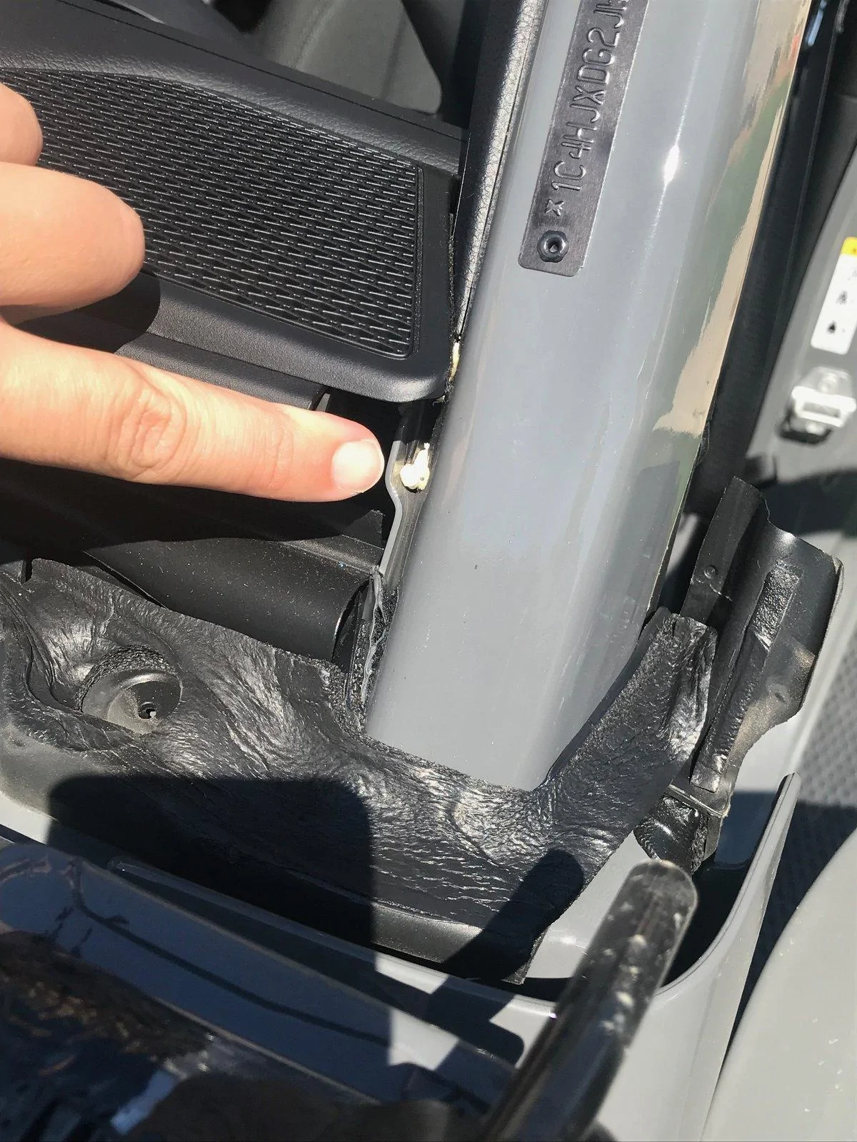

I too have noticed what seemed to be higher than expected levels of wind buffeting/static/crackle with my JLU Sport S hard top. Looking over TSBs for noises, I saw the one indicating foam at bottom of windshield may be folded, so I took the windshield down today. I noticed that FCA must be aware of something, as there was spray-foam in the corners right by the speaker, but not enough to actually seal anything (one section of spray-foam was dislodged and was just laying there when I lowered windshield):
Jeep Wrangler JL Hard top wind noise IMG_1104
I had some foam padding laying around, so I crammed it in as seen here:
Jeep Wrangler JL Hard top wind noise IMG_1106
I then, used some of my own spray-foam to fill in any gaps smaller than I could cram foam into:
Jeep Wrangler JL Hard top wind noise IMG_1107
Finally, I made sure all weatherstripping was even and positioned correctly on both sides.
Official road test will happen tomorrow as I left the front panels off after putting windshield and wipers back.

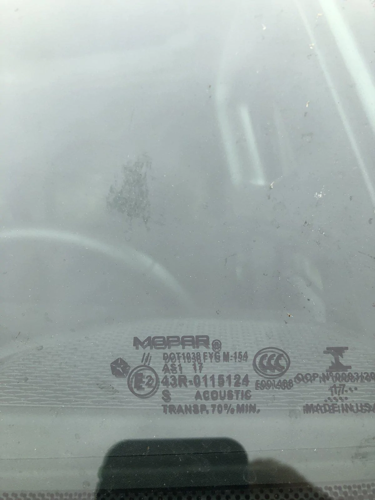

I will report back...I asked my dealer about the acoustical windshield and they said the jlus and rubicon has acoustical glass. I'm convinced the sound is coming from the seals around window/door or windshield. You?
I asked Jeep Cares about the Acoustic windshield. They confirmed and re-confirmed ALL JLs have Acoustic windshields now. They said they reconfirmed after I questioned them. ALL model JLs have it.
Keep us posted on your findings!
So the early model JLs didn’t have the acoustic glass? Mine was built in December 2017.
viper88
Nick
Apr 22, 2018
5,379
5,443
IL
Not sure? They should have "acoustic" stamped on them. Initially I thought I read only certain models had it. I had them re-confirm which they did. Jeep Cares re-confirmed ALL models, Sport, Sport S, Sahara, Rubicon, all have it. Hopefully their info is correct.
It does say acoustic after looking at the fine print!

Sound levels decreased, but not gone... Going back to the drawing board on this to better isolate what needs to happen.
