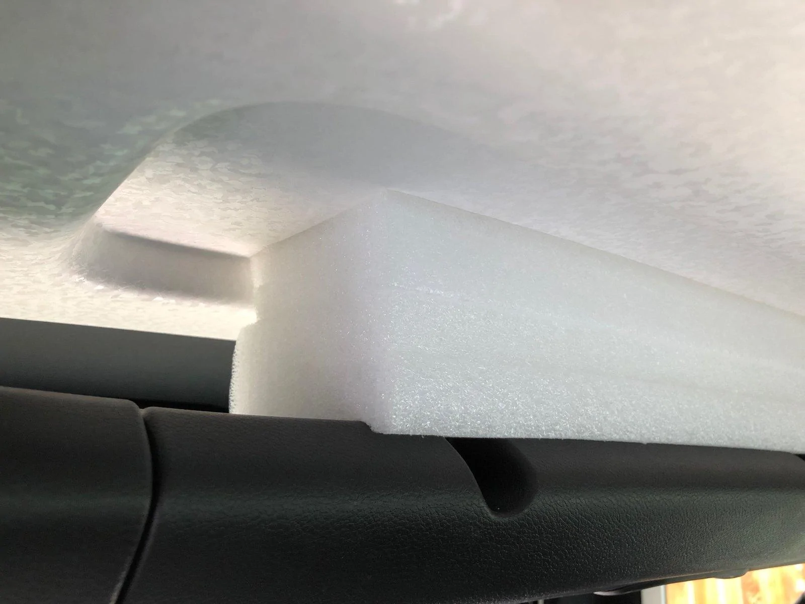

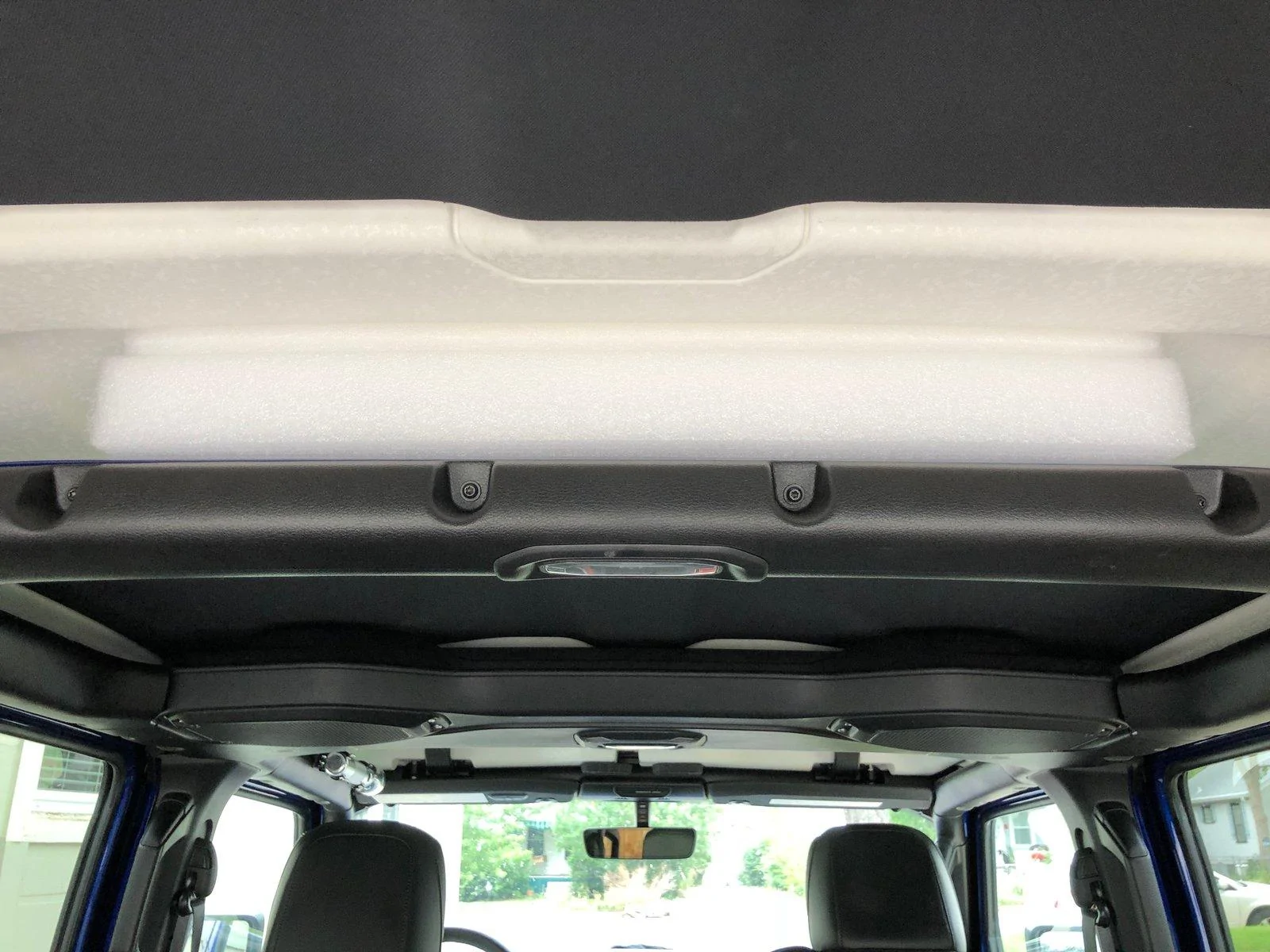

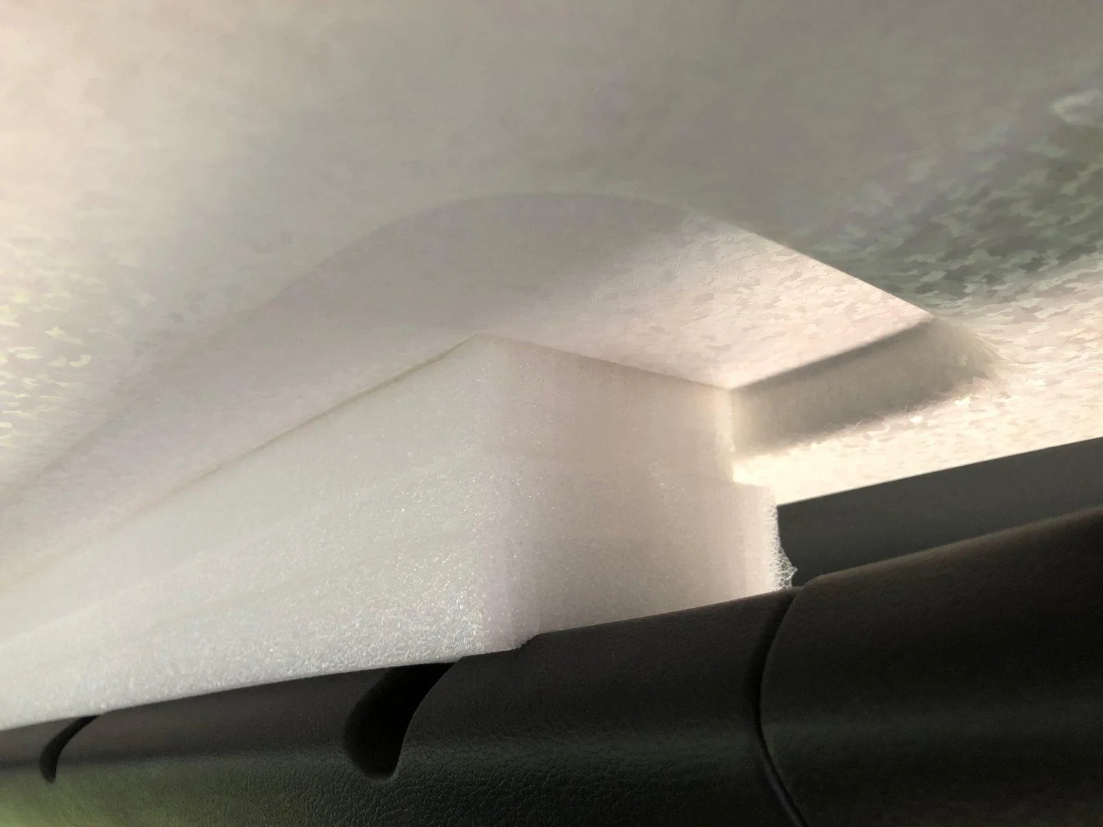

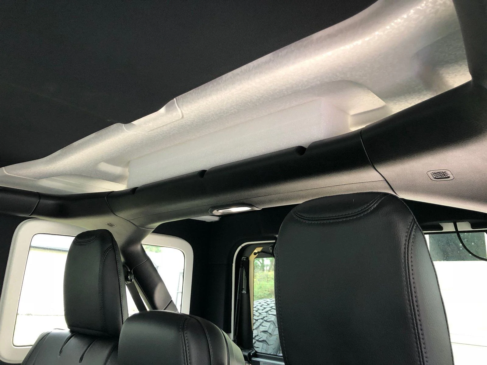

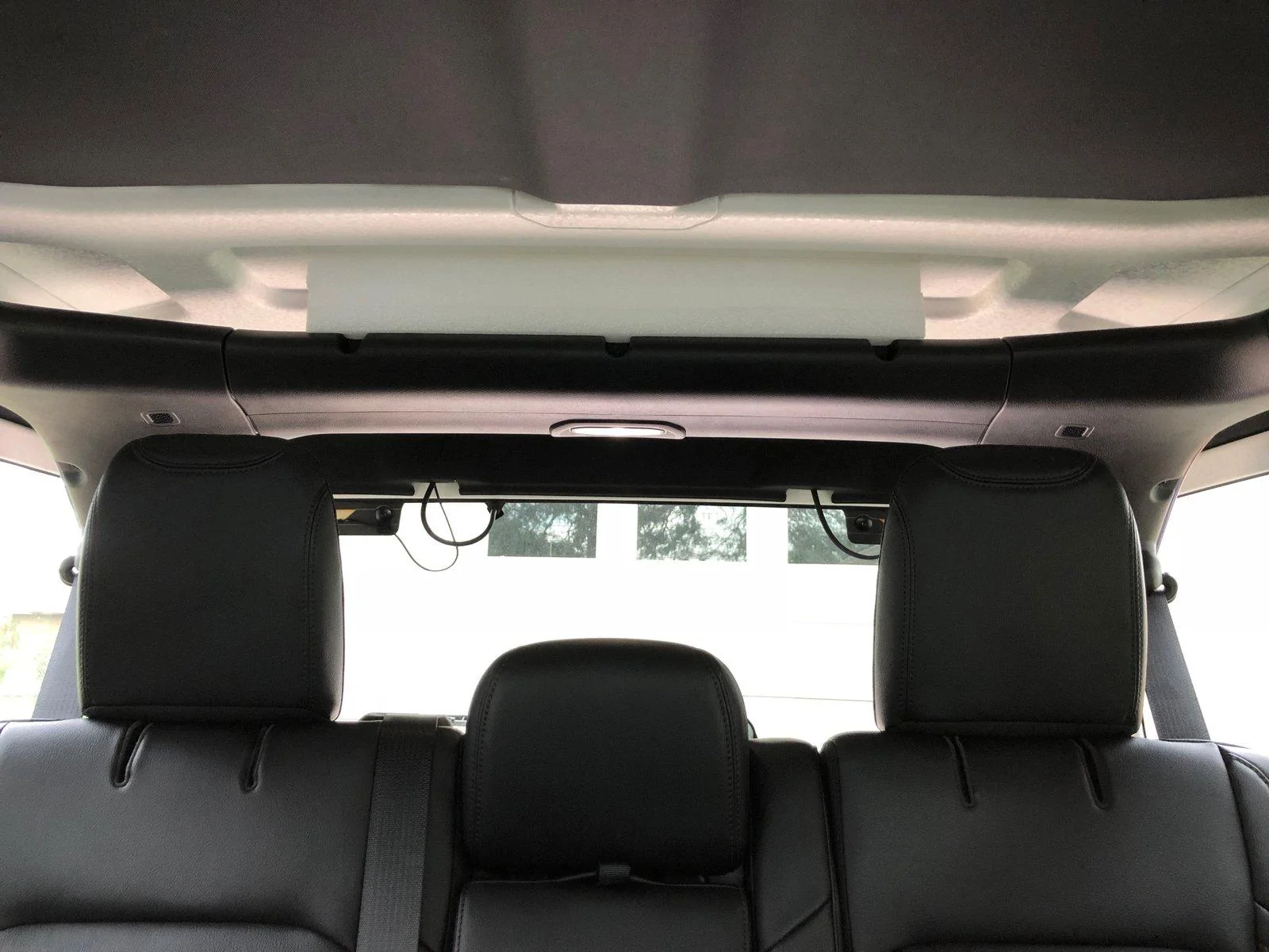

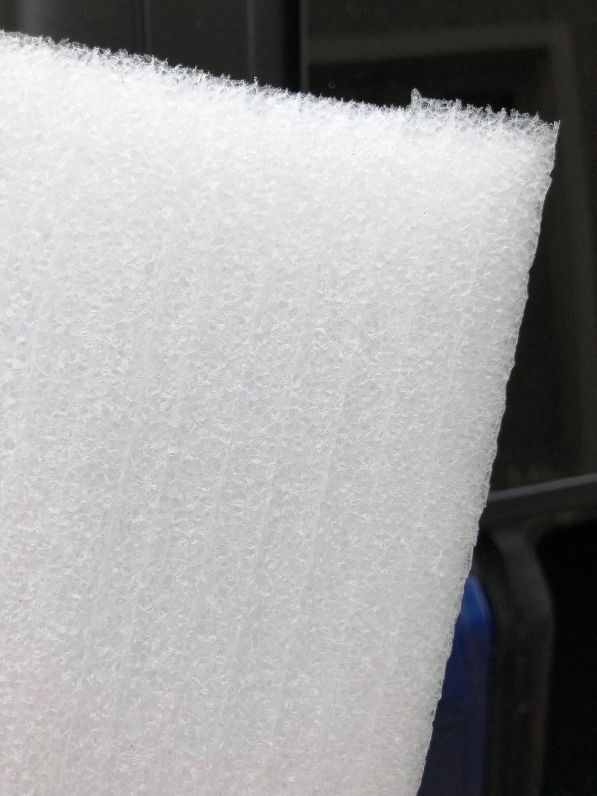

Buffeting Sound Update
I did take my vehicle in to the dealer to see if they could hear my buffeting sound and to get the issue documented. I’ve since upgraded my foam that mitigates the problem very well and it doesn’t drive me crazy. Obviously not a permanent solution but it does reduce my urgency and increases my driving enjoyment immensely!
I found some polyethylene foam that was used as packing material. Polyethylene is rigid, flexible, and won’t break off in chunks. I stacked two pieces to end up with a 24 inch long, 4 inch deep, 3.25-3.5" tall block. When I put that over the rear roll bar in the middle the pressure you’d feel in your head at low speeds and over bumpy roads disappears. This is the data I use to be pretty confident it’s the hard top flexing that is causing the issue.
When I took my JL into the dealer they did remove my old foam blocks, inspected all the hard top and door seals, drove around trying to duplicate the sound. Unfortunately they said they couldn’t duplicate the sound. My guess is the description that was written on work order didn’t translate well to what they should hear/notice. Also probable the sound/feeling impacts people differently and it didn’t bother them.
Either way here is a reasonable solution for the moment that doesn’t look half bad.
