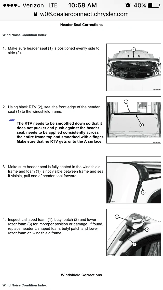

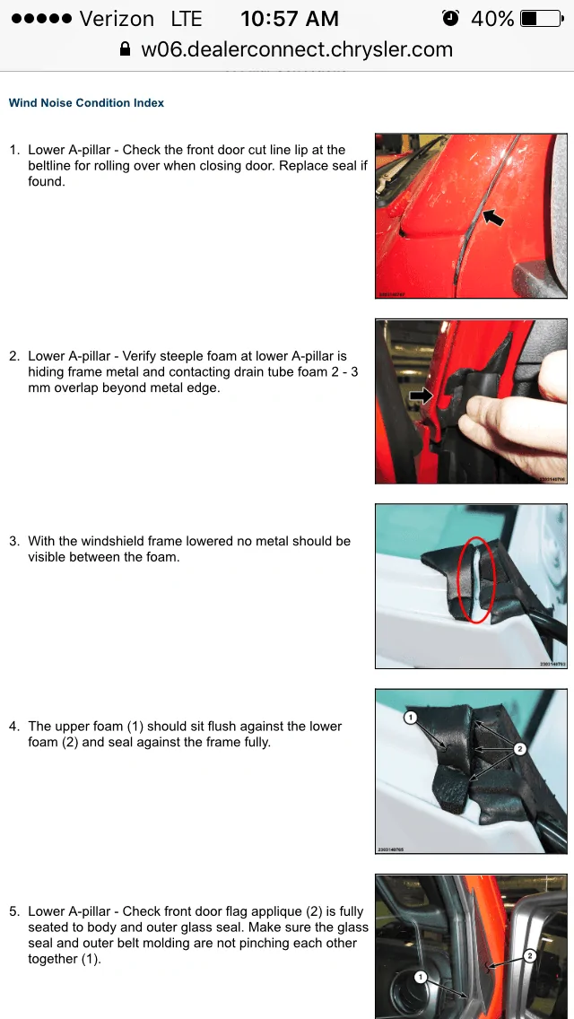

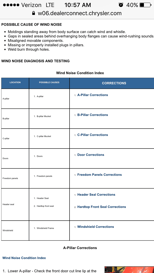

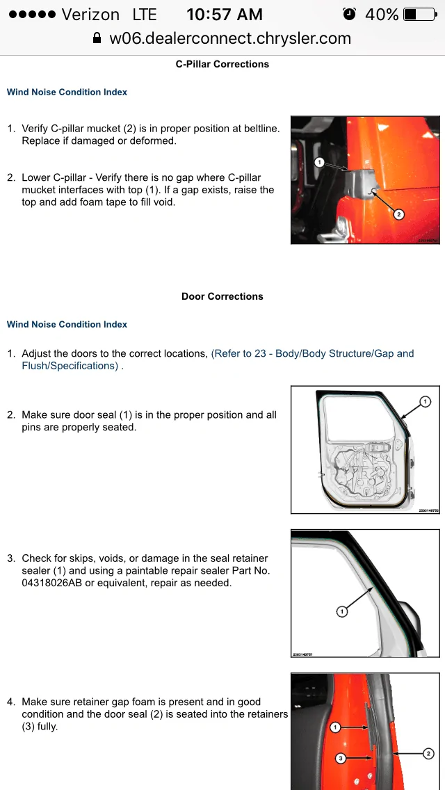

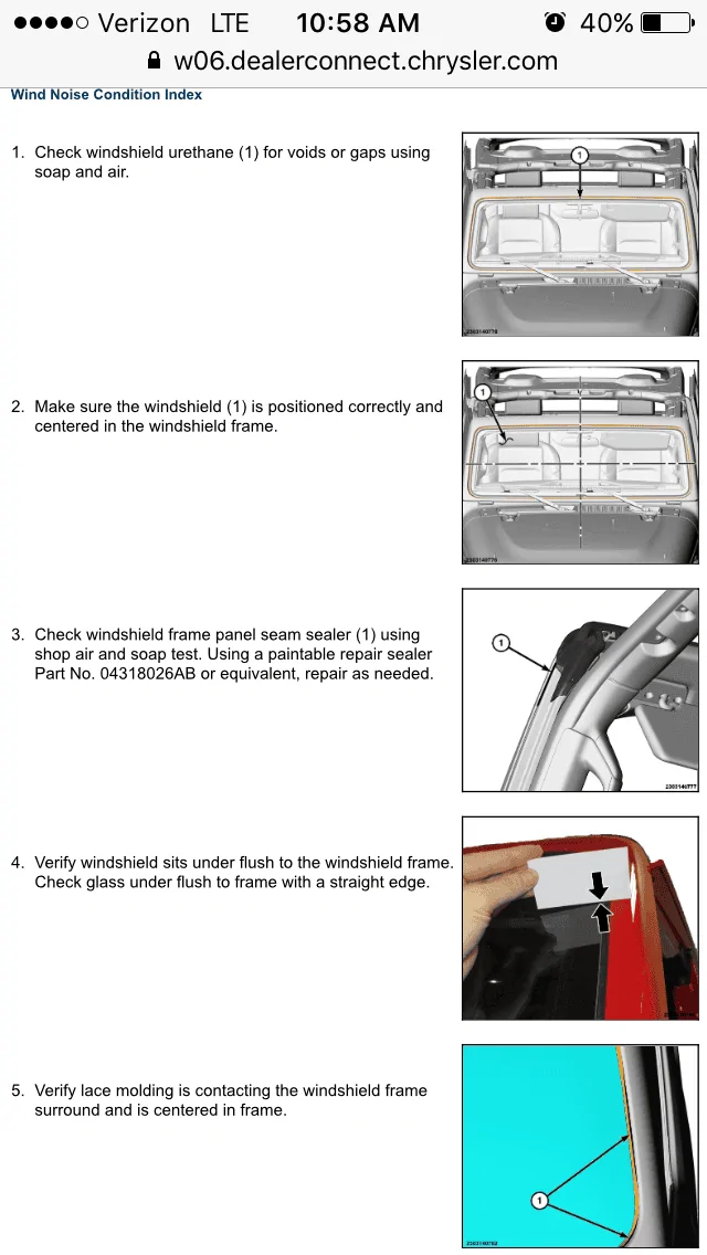

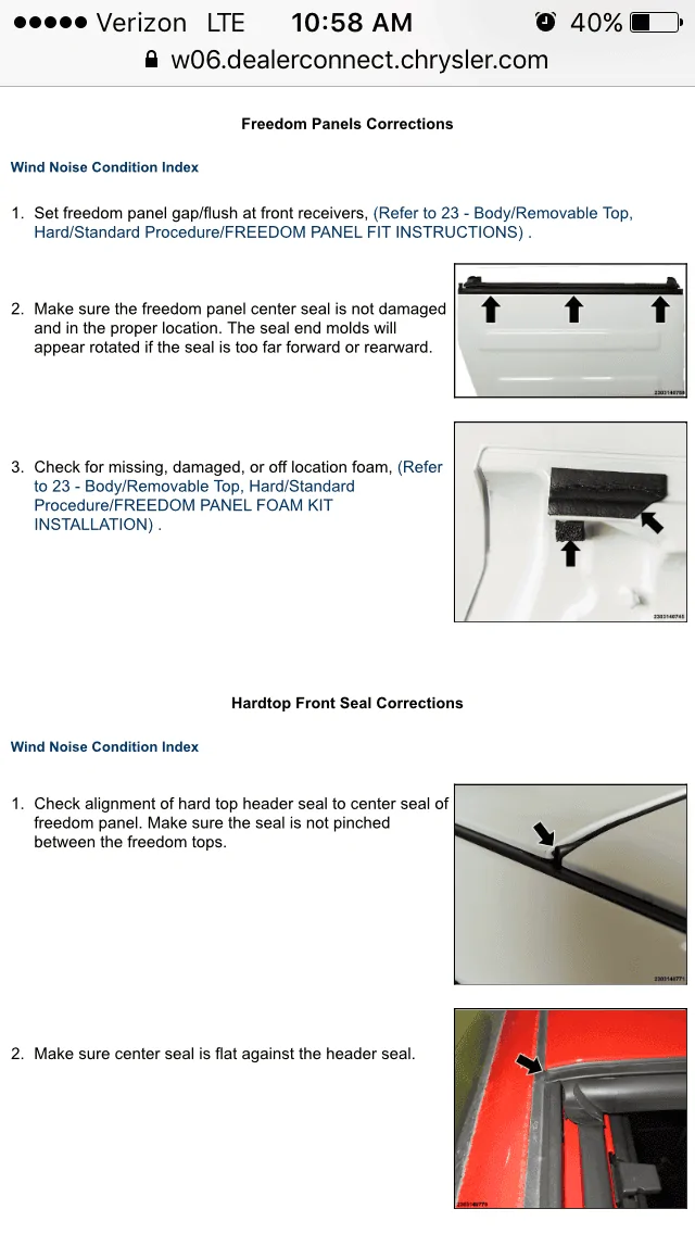

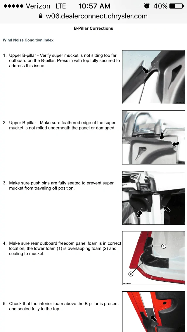

Talked to a friend at Jeep. There is an issue and Jeep knows it. Here are the screen shots he sent me. I'm dropping mine off on Friday. I'll be gone for 10 days on vacation so that should give them plenty of time.
Jeep Wrangler JL Hard top wind noise IMG_2015
Jeep Wrangler JL Hard top wind noise IMG_2012
Jeep Wrangler JL Hard top wind noise IMG_2014
Jeep Wrangler JL Hard top wind noise IMG_2016
Jeep Wrangler JL Hard top wind noise IMG_2013
Jeep Wrangler JL Hard top wind noise IMG_2017
