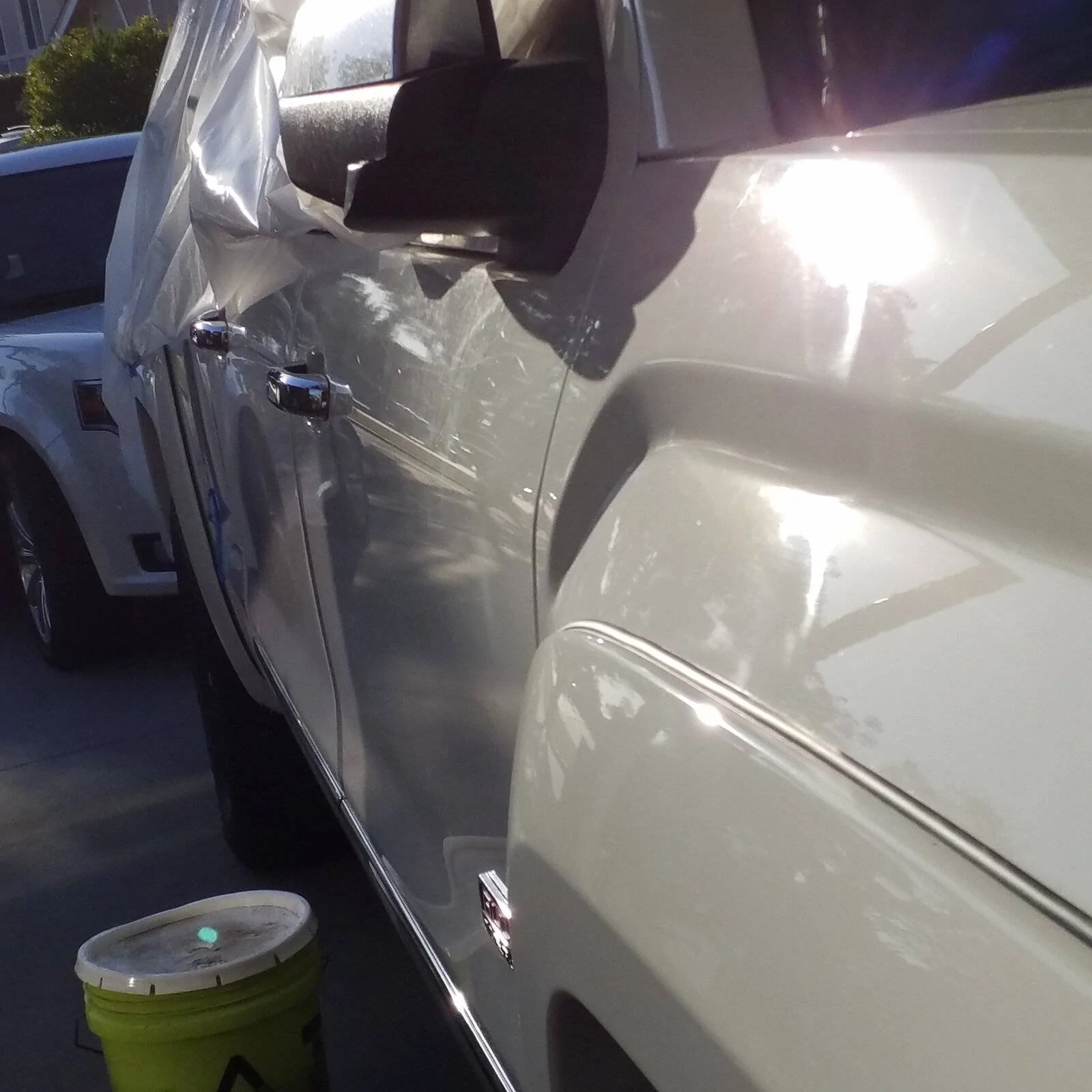

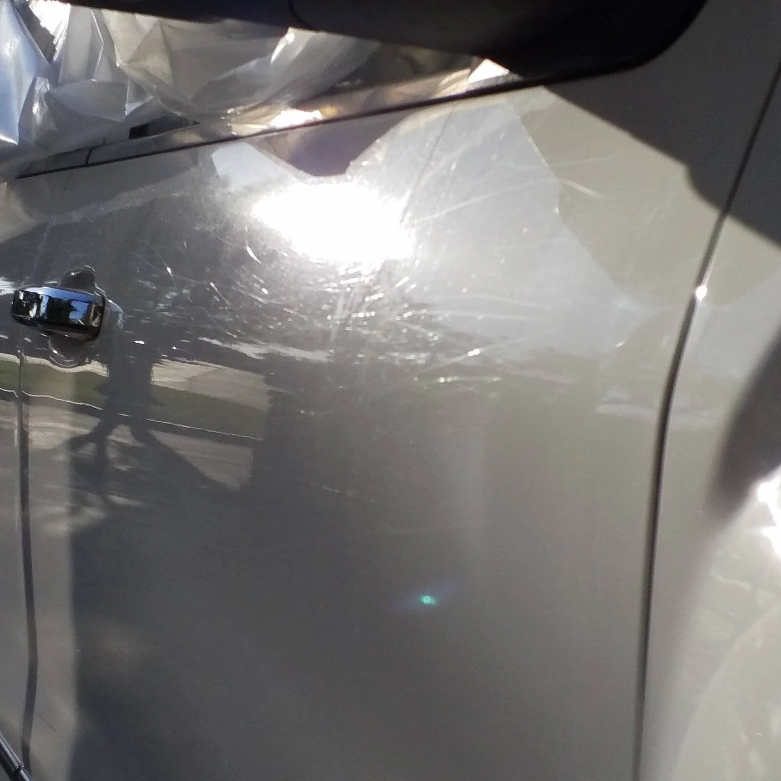

Not a JL, but here's a couple pix of my correction work. I'm not shooting for showcar, just respectable. I'm not taking 100% of the scratches out, leaving a trace of some of the deepest, but I am getting all the sanding and swirl out.
These first 2 pix are the damage.

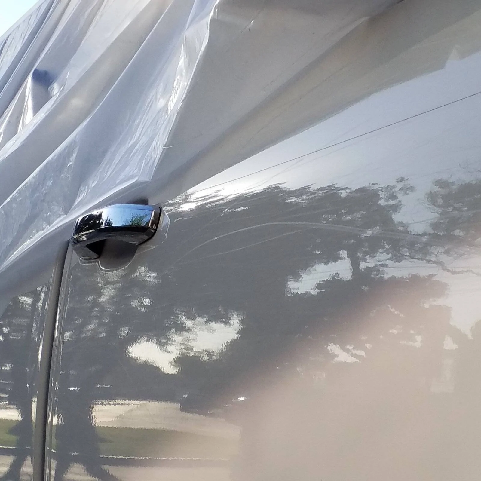

This picture is after removing about the same damage as the previous pictures.
Again, I had to wet sand with 2500, buff with a wool cutting pad on a rotary, with aggressive compound (V32 Chem Guys), then foam rotary with V36 (fine grade compound), then DA random orbital with V36. I just didn't feel the need to go to V38 (extra fine) which would be good for a dark color.

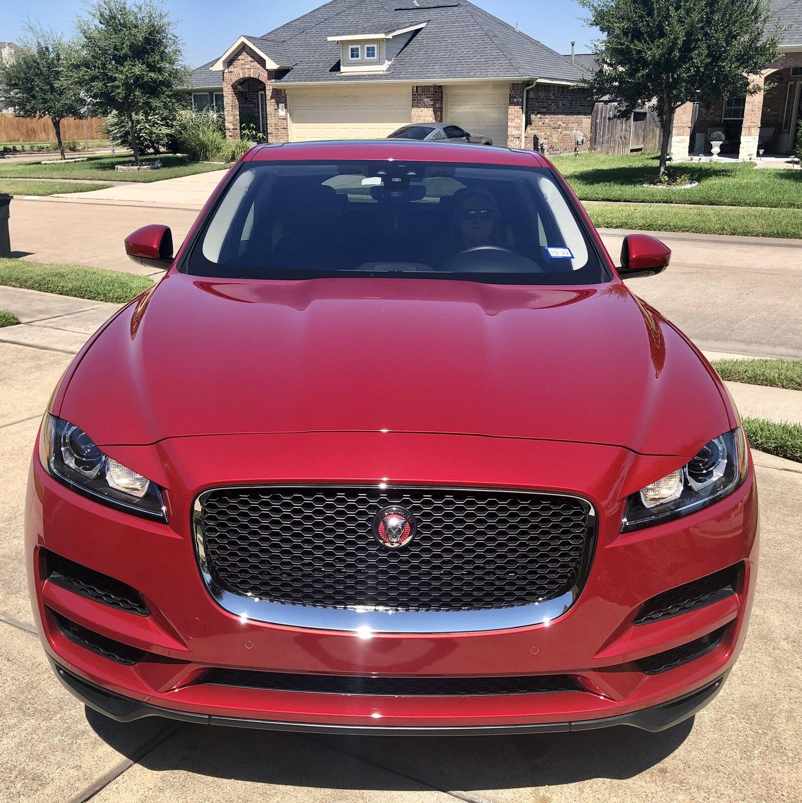

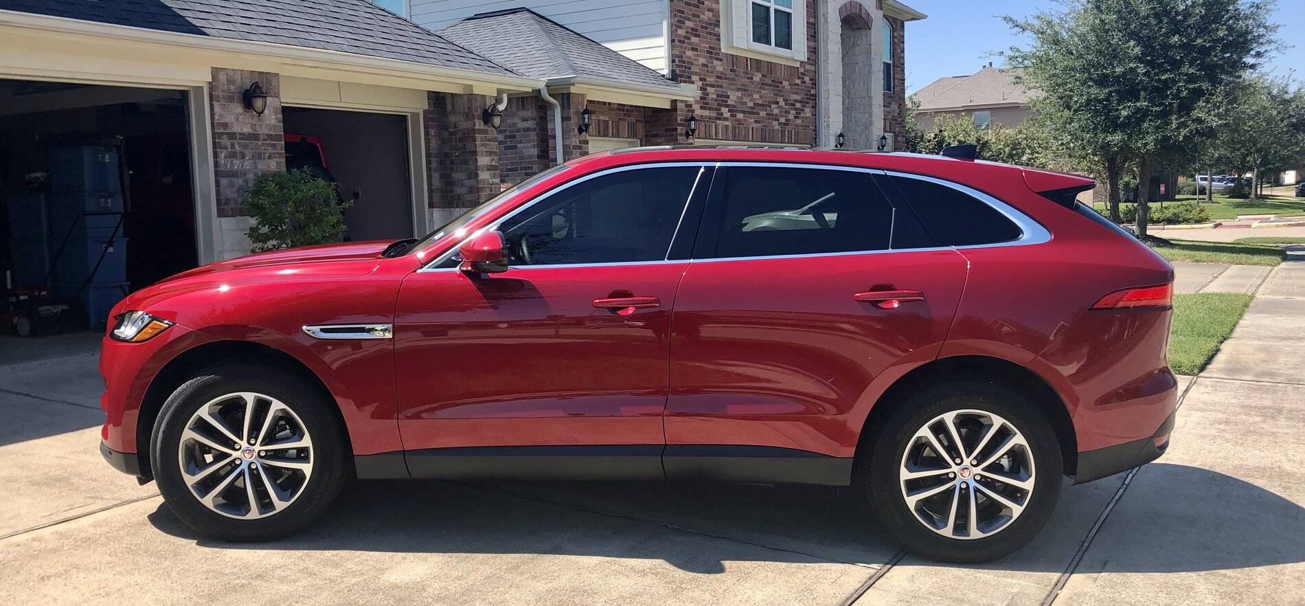

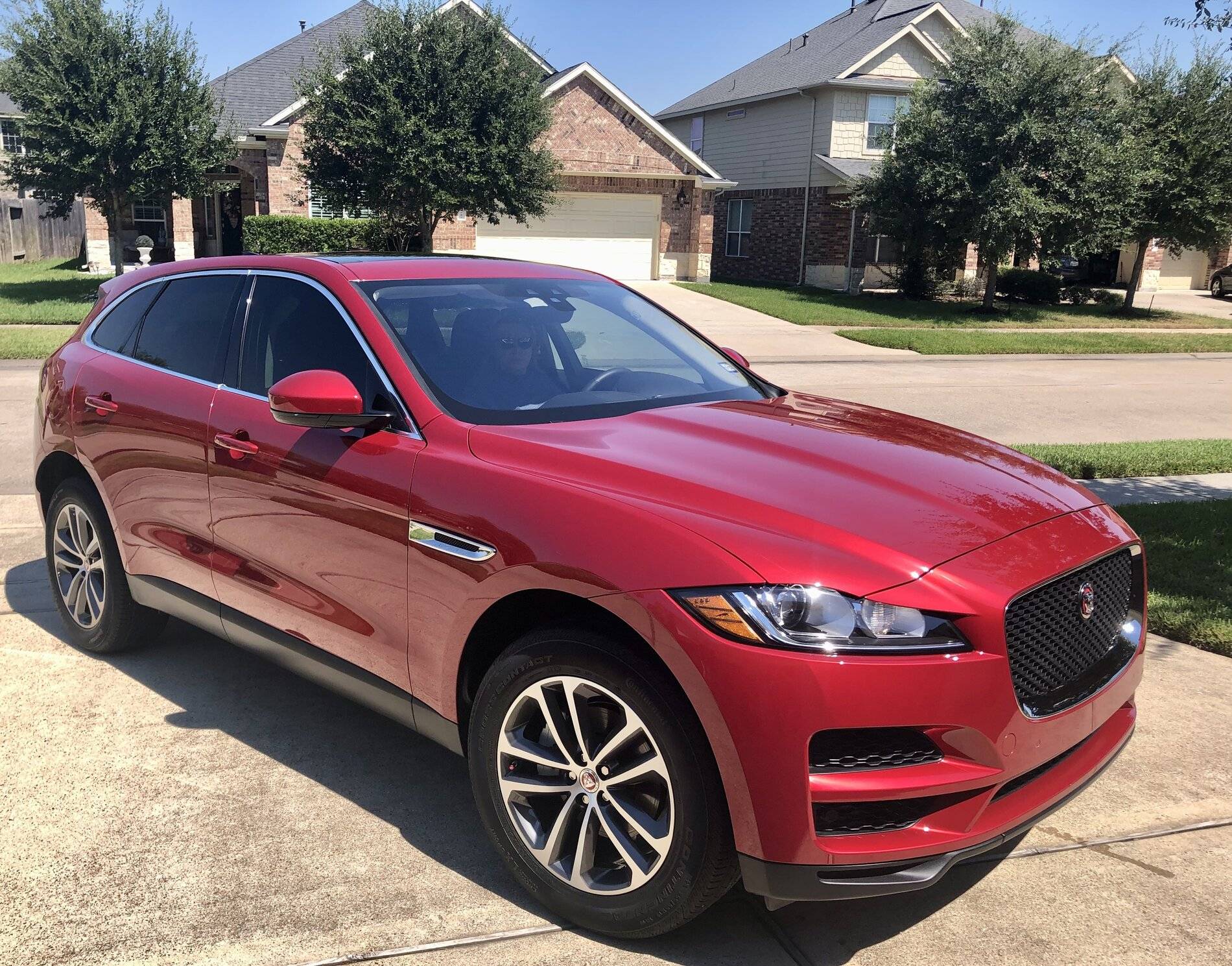

Well guys my plan was to detail the Jeep but last minute but I got some marching orders that require me to travel the latter part of next week and will be gone a week and it’s supposed to rain all next week but I wanted to try the buffer and all my supplies so I did my wife’s ride, it’s a 2020 and only has 5500 miles on it and is garage kept and she does not work outside the home so it will be in the garage all next week.
Started off with a good wash of wheels and tires with a dedicated sponge and wheel brush then rinse all clean
Then filled the bucket again and washed from top to bottom then clayed and washed again
Started with a LC CSS white pad and the 3D One and and figured out real fast I used to much polish as it got slung everywhere ( lesson learned ) anyway did small 2 x 2 sections and did (3) sets of cross hatch passes and wiped off ( used 2 pads ) for the whole car and I changed when they looked dirty and they did which surprised me.
Then I switched to a LC CSS blue pad and did a finish pass using the 3D One and did (2) cross hatch passes and wiped off all, according to the 3D One folks this polish can achieve different results just by switching pads.
With the above I used a lot of MF towels just to be safe
After I got the above all done I used some of the Pinnacle Sourvern detailer with several MF towels just to wipe it all down to ensure all the polish was gone.
Changed the pad to a LC CSS black pad and used it to apply the Pinnacle Souveran Carnauba liquid wax, read this was a quick way to apply and it makes short work of it as I went over the whole before wiping off and it wipes off so easy.
Finally after all was done I used the Pinnacle Souveran Detailer and misted it onto a clean MF towel and wiped the whole car down and then did all the normal stuff like windows and trim dressing
All in all took me like 7 hrs but I can see now how power polishing and high quality products make a huge difference, the paint looks like its inches thick
So much for a my initial budget ?
I know it’s not a Jeep but just have to share some eye candy, overall super pleased with the final outcome, the Griots G9 is super nice for a great price …vibration is very acceptable even on the highest speed of six and super balanced and is reasonably quiet as I had a some tunes in the background playing and was easy to hear.
Hopefully in a few weeks when I get back I can get after my Jeep and post of some pics using the same process but will try the Megs Hybrid Ceramic wax and detailer to compare.
Big thanks goes out to all that offered advice and a bigger thanks goes out to Jeremy @Chocolate Thunder for taking the time to answer all my questions over the past few weeks
