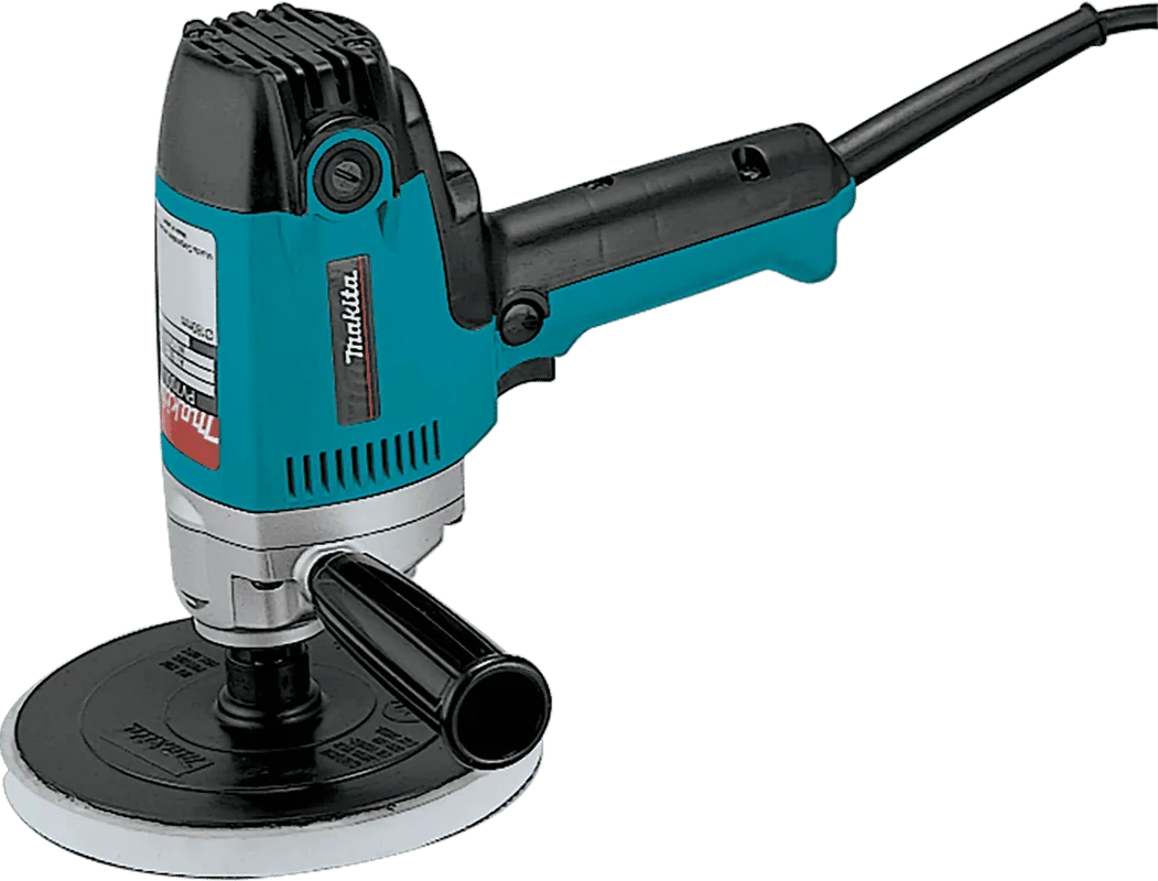

I ended up ordering a Makita PV7001C. I wanted to order a Flex 14-2-150 but it was just over the top on cost for my infrequent use and I figure the PV7001C is about the same (light) weight as the Flex and should work well and be more user friendly, adaptable/flexible than a big full size Makita or Dewalt buffer, albeit not as powerful.

You seem quite knowledgeable. But you know I’m obliged to say it, please be really careful using a circular. You’ve been warned! :LOL:

I hear ya. I've used rotary buffers in the past, before orbitals became popular. I've had a couple rotary buffers over the decades, but they seem to have gone by the wayside. My Torq 22D just can't efficiently deal with the mass of scratches on both sides of a crewcab.

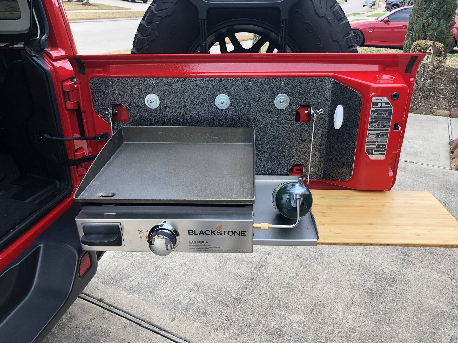

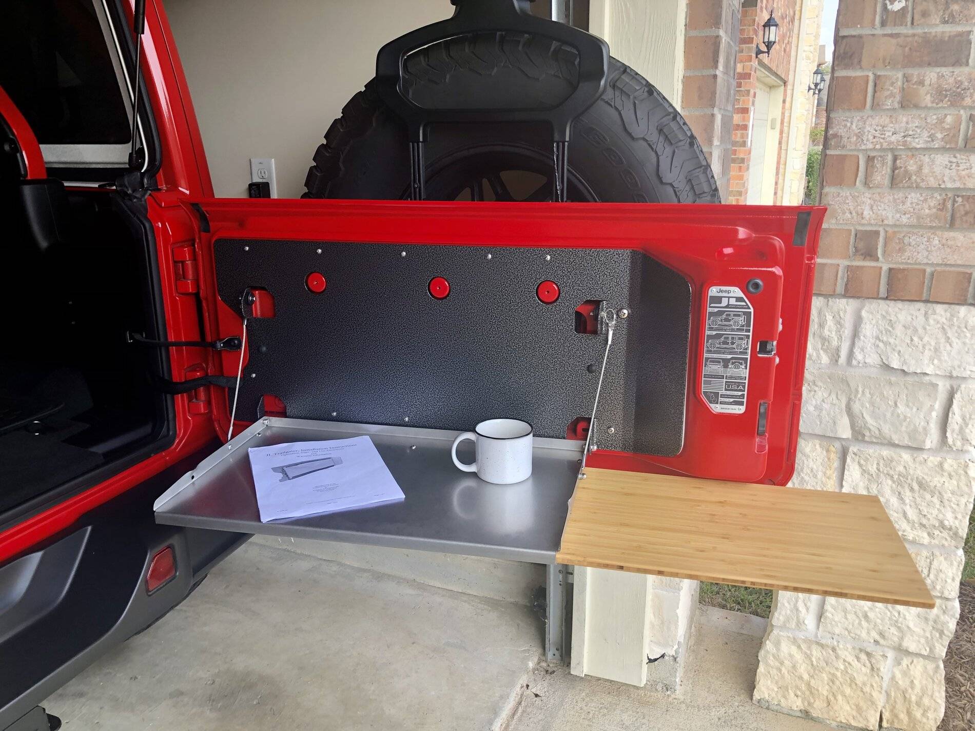

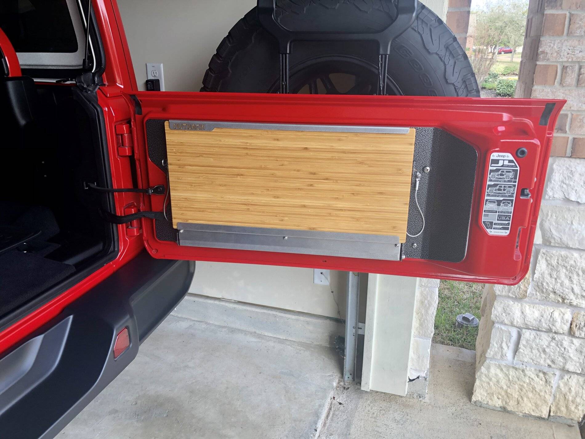

For now it’s baby steps for me learning good habits to build on and my tailgate table is from Outback Adventures

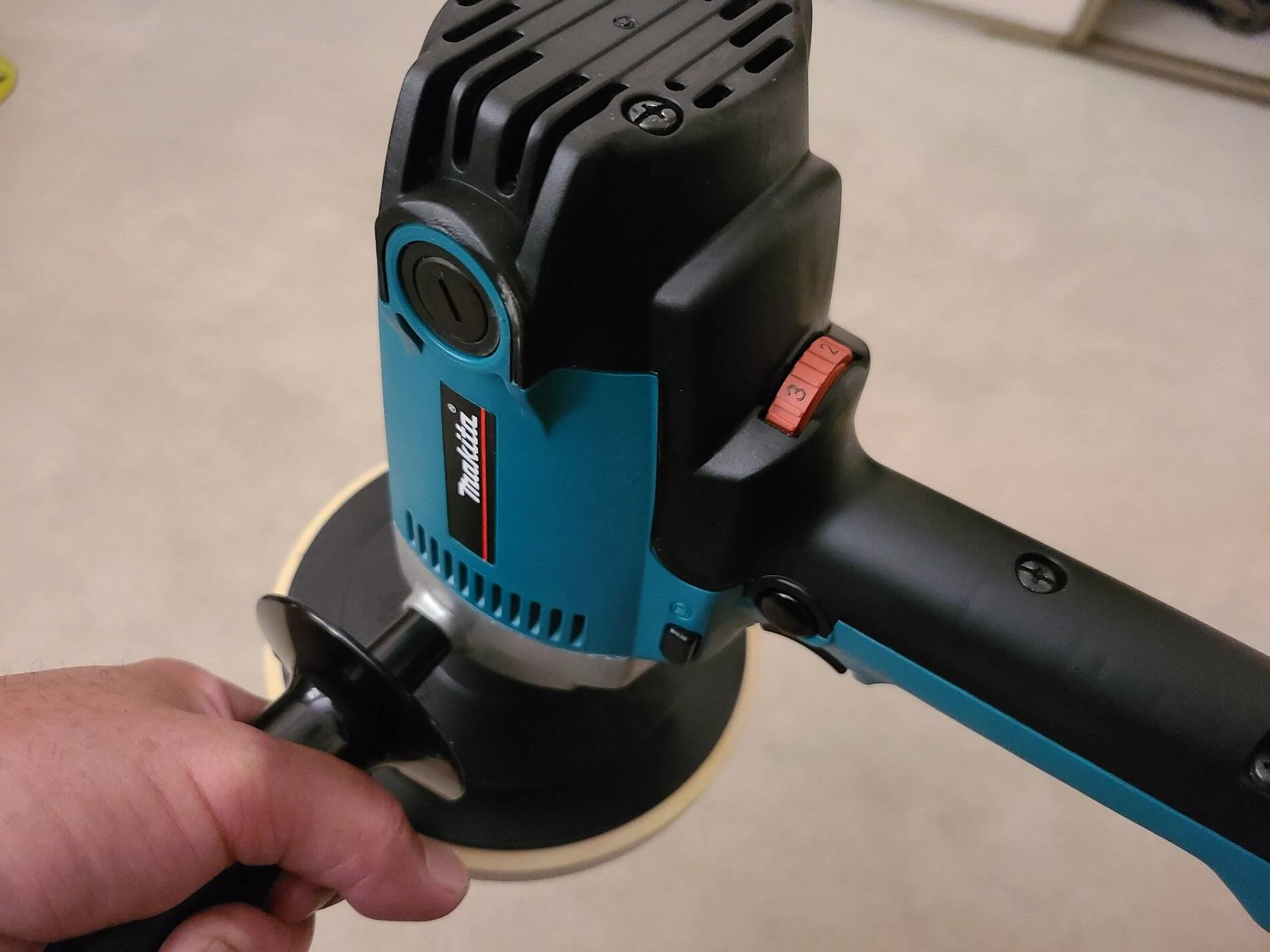

My Makita rotary showed up. I put the included 7" backer on it and spun it up. It has a spec decal that shows it runs up to 2350 instead of their website that states 2000. That extra range may help when running smaller diameter pads. My scale shows it's right at 5lbs. It feels very ergonomic, but using it will flesh that out. I'm going to ditch the 7" backer and run 4", 5" and 6" pads, because I have a good selection of them and I really don't see the need to get more pads. I'm looking forward to a cooler day this week to try it out.

That tailgate table is the one I've been thinking about for a while now.
Any noticeable (lack) of venting with the way it covers a lot of the tailgate vents? That was probably my only concern with the table.

No venting issues on the tailgate table, it has a foam edge on the back side edge and then there is a cutout for the cable so it may vent a little but I have not noticed any issues.

A bit OT, but after using the Makita PV7001C rotary for a day, I am very pleased with the ergonomics and the performance of this rotary. It's not for someone new to paint correction, but it is very controllable and relatively easy to handle for those of you experienced enough that are seeking a lightweight but decently powerful rotary. I used it with 6" microfiber and foam cutting pads today as well as a 3" microfiber cutting pad. I really like this machine.

That thing looks like a beast..for me I think it’s best I stick to a smaller less aggressive machine and pad as @Chocolate Thunder suggested, the G9 and a combination of white, blue and black pads using the 3D One and Pinnacle yielded great results on my wifes car and I will likely use the same on my Jeep, I may have to go up to an orange LC CSS pad for the hood but will do a test section to see how it goes with the white first, I figure the less aggressive I can be the better off my CC finish will be, also still undecided on the 3” polisher, I can get the majority of the work done with the G9 but a 3” would be ideal for lots of tight areas like around the windshield frame, hinges, grill etc.. but it’s a added expense for the polisher and pads for the hobbyists detailer like me.

Sounds like your dealing with paint that is in relatively good condition. For a small area detalier, you might consider using a common variable speed electric drill with the less aggressive pads in 1", 2", and 3", along with finishing polishes. I don't think you can get in trouble very easily with that type of setup. In the really small areas, an orbital is impractical. It's either a small rotary or hand polishing.
The new Makita rotary is what I'd call a midsize polisher. It has about a 950w motor and is 5 lbs. More than enough for my needs. The big ones are 7-8 lbs and 1400+watts. I can't handle a big polisher like that for very long. But, yes, compared to the G9, the Makita PV7001C is on the other end of the scale. Different tools for different tasks. My truck paint has been badly damaged and there is probably 3 to 4 times the painted surface area compared to my JLUR.
