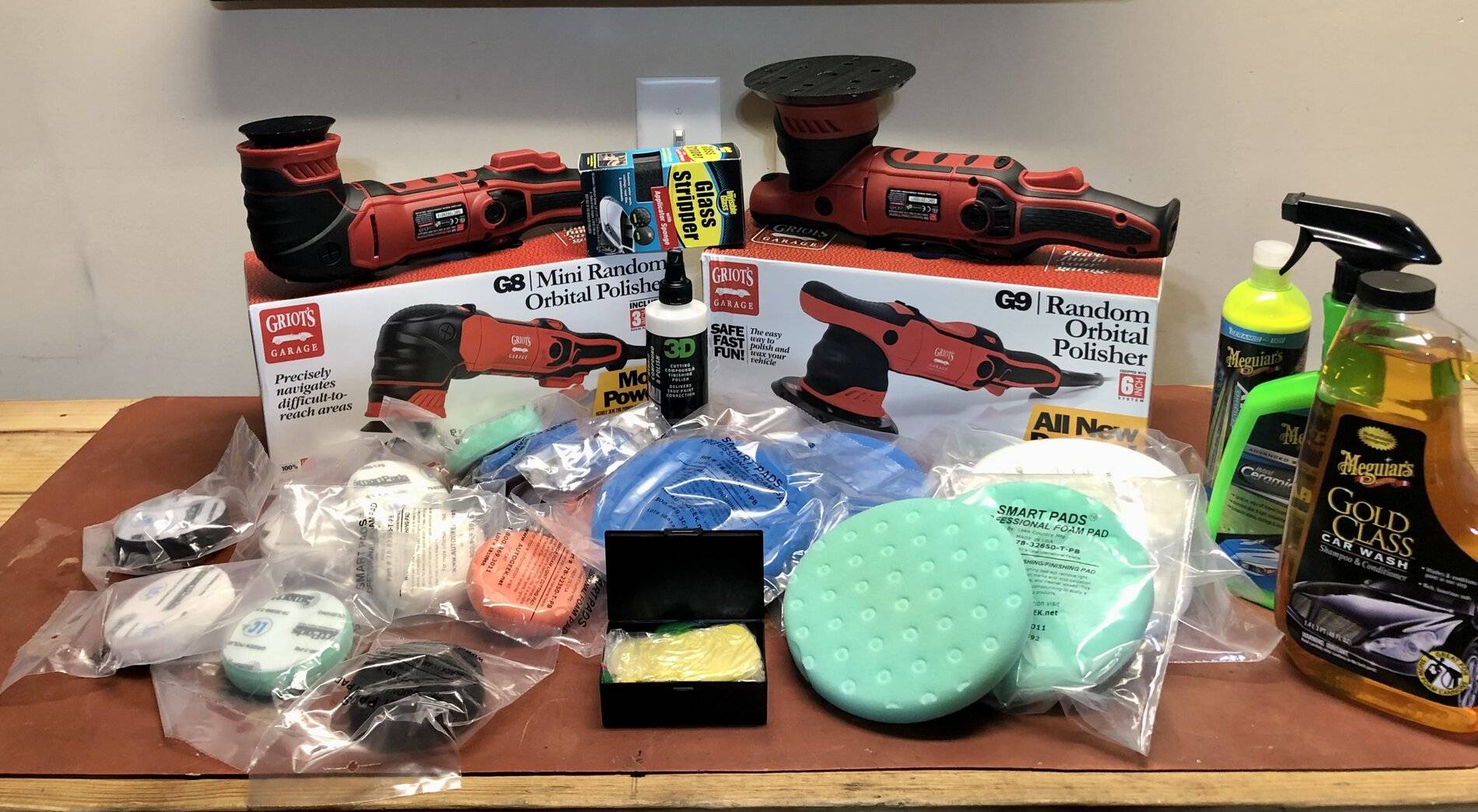

Well guys I made the decision to get a mini polisher to add to what I recently picked up
I did my wife's vehicle several weeks ago and used 6.5” pads with a Griots G9 with LC CCS pads and had to do some areas by hand so after looking at the Jeep I decided after doing some searching and reading and chatting with some guys like @Chocolate Thunder to get a mini polisher and added the Griots G8 mini and will use 3.5” LC CCS pads as well, it comes with a 2” backer to but I don’t think I need to go that small so will not get pads for it yet.
So in a few weeks when my schedule allows I will:
*Chemical wash (Wheels separate)
*Dry
*Clay
*Megs 34 wipedown
Paint correction (3D One using LC CCS pads *Orange, White, Green/Blue for correction, may have to use orange on just the hood but will see what a white pad does first and step down use the 3D One using different pads
Wipe with Megs 34, was thinking about a IPA wipedown but changed my mind.
** 3D Poxy sealant** this is optional and still seeing if I can use with the Megs wax
Megs Hybrid Ceramic G200416 ( cure time and compatibility I’m checking on using it with the Poxy )
Megs Hybrid Ceramic Detailer G200526
Will take some pics as I go and then some finish ones, it was suggested to me to consider a ceramic coating but I like to detail so if I did the ceramic coating it would reduce my relax time washing and waxing.
