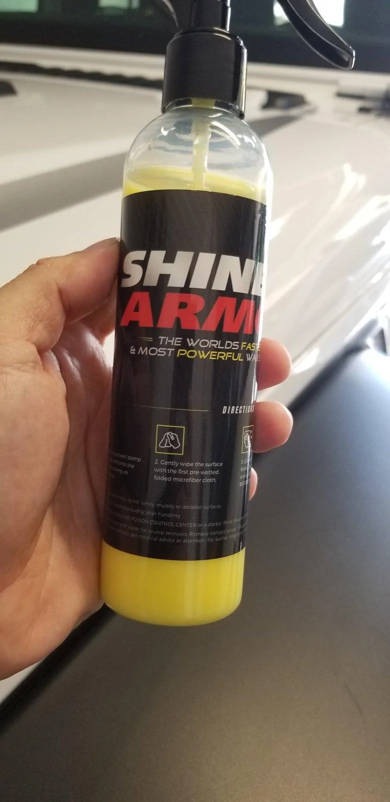

Highly recommended this liquid shine armor liquid wax. Leave the car super shiny after a nice wash.
Looks like you still have plenty left.
I’ll PM you my address LOL

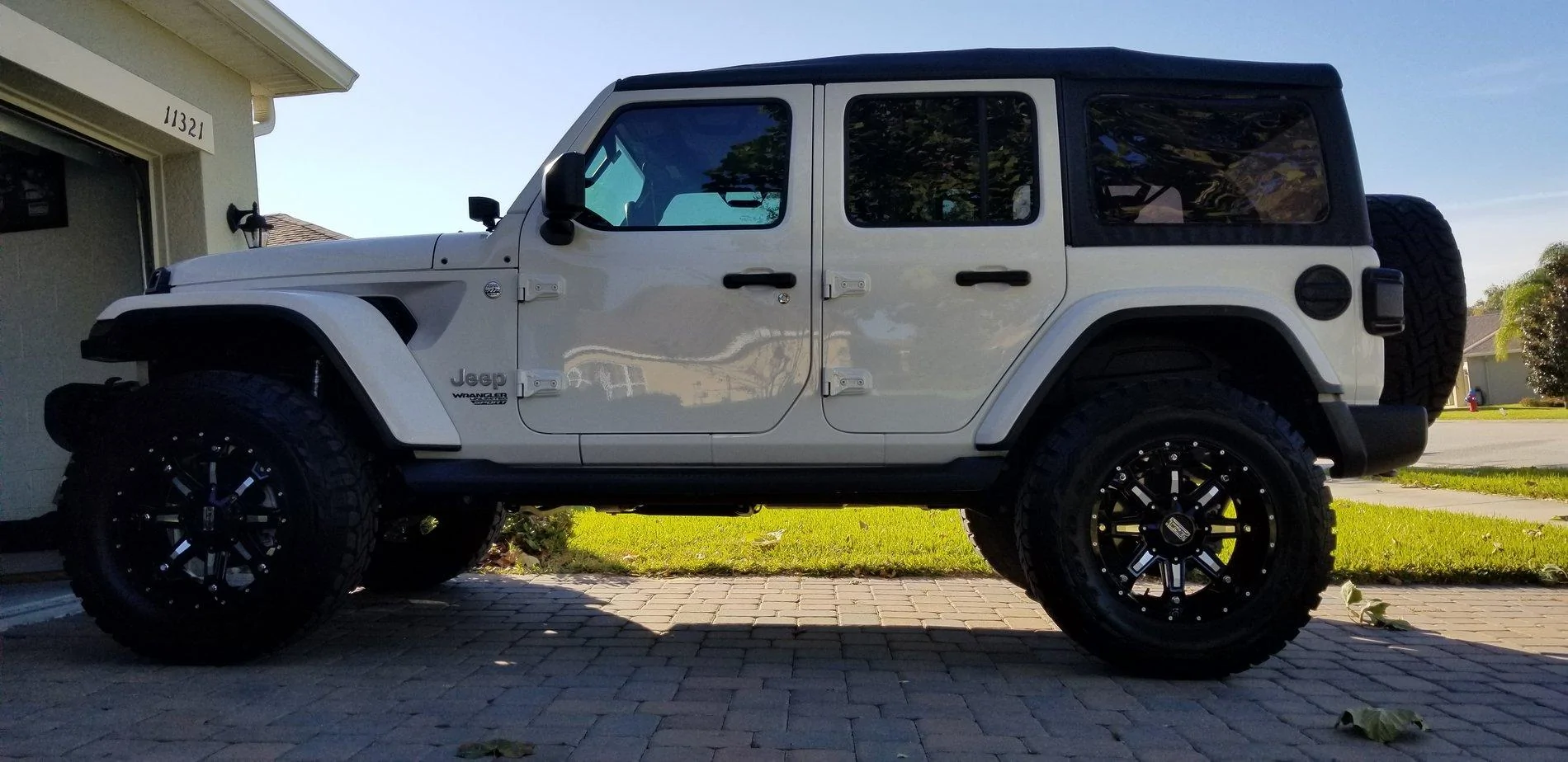

@Roky I love the new pic. If the jeep isn't on the trail. That is its second home. Every now and then I do 3 fill ups in the same day.

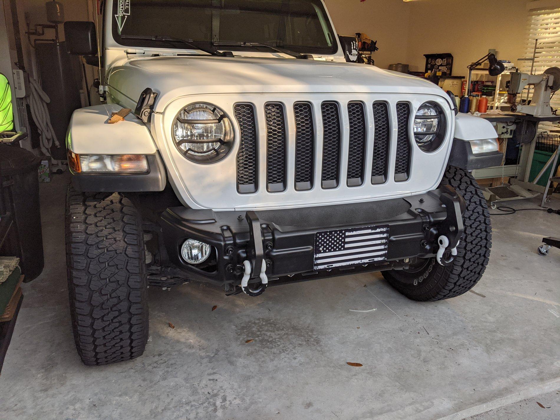

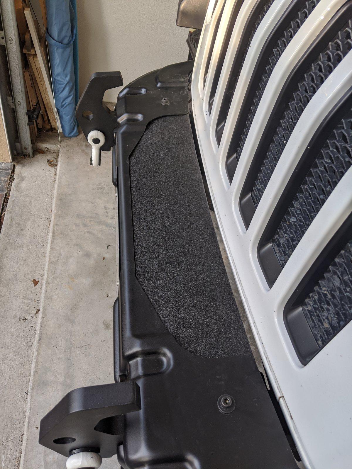

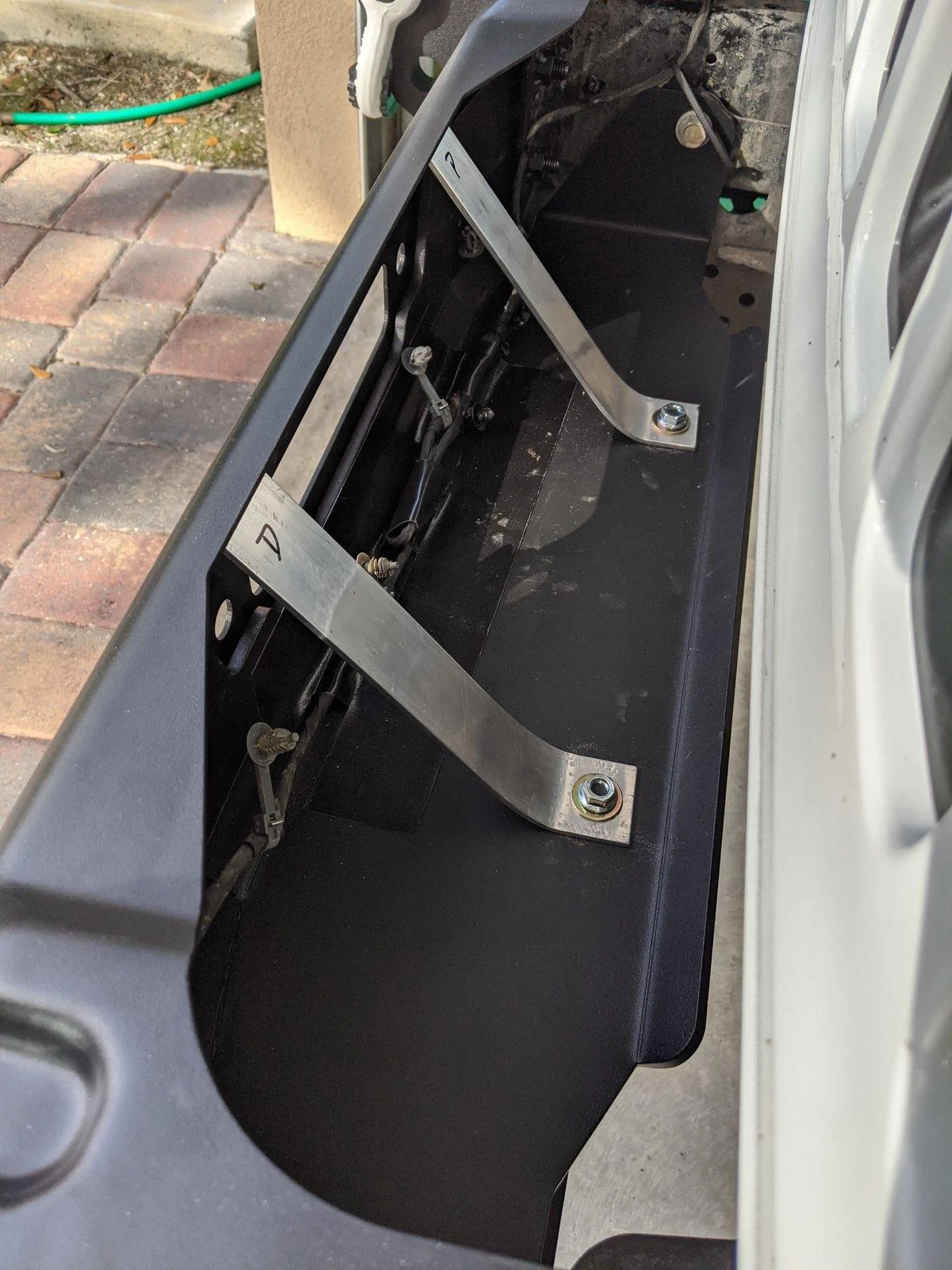

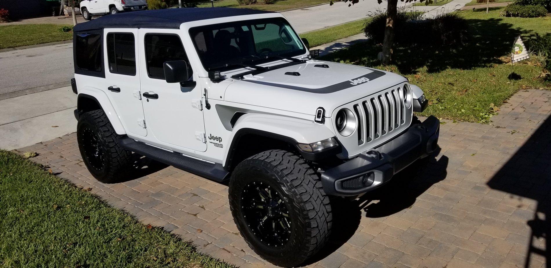

I finished doing the DIY 'Winch Delete' mod on my new Rugged Ridge Arcus front bumper. I wanted to hide the fairlead opening as well as the big void in the top where a winch would go. I might eventually install a winch, but this set-up will work for me for the time being.
The top plate is a piece of 1/8" thick ABS plastic. I didn't want to drill holes through the powder coating (I suppose it wouldn't have been a big deal, but I avoided it nonetheless), so I came up with a way to use the existing over rider holes to fasten the sides, and spring loaded aluminum straps for the front. 1/4" thick material probably would have worked better, but since this is in an area that 'shouldn't' see too much action, I think it will be okay. ..and it's not like I have a fortune invested.

It looks great Randy!

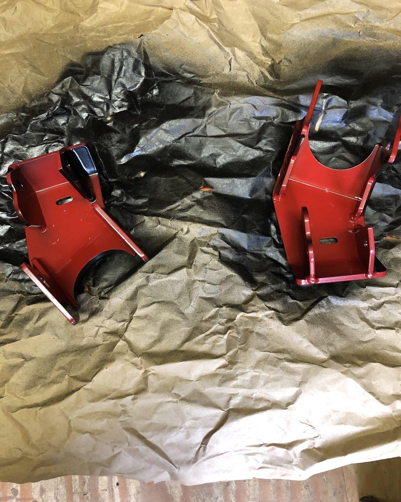

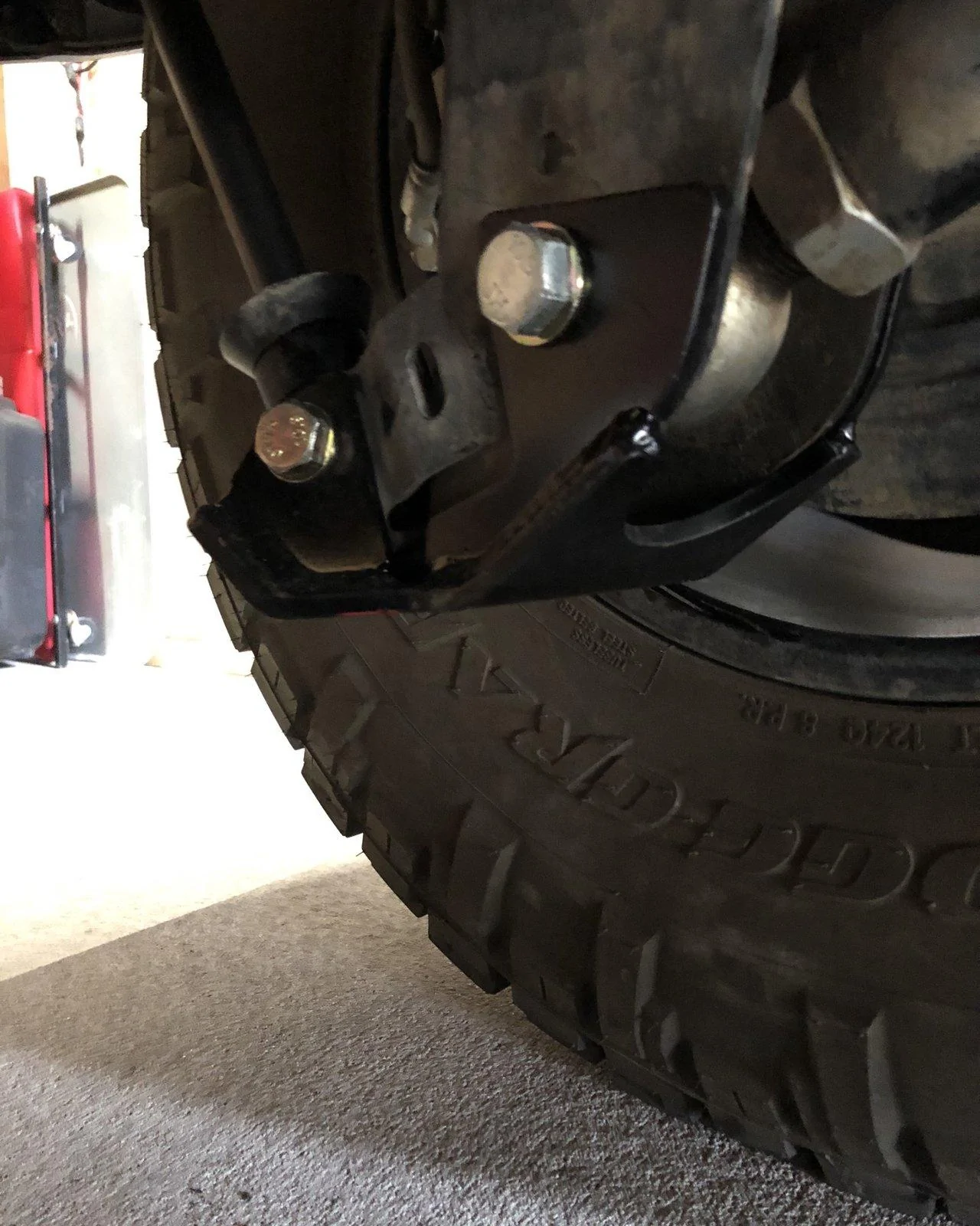

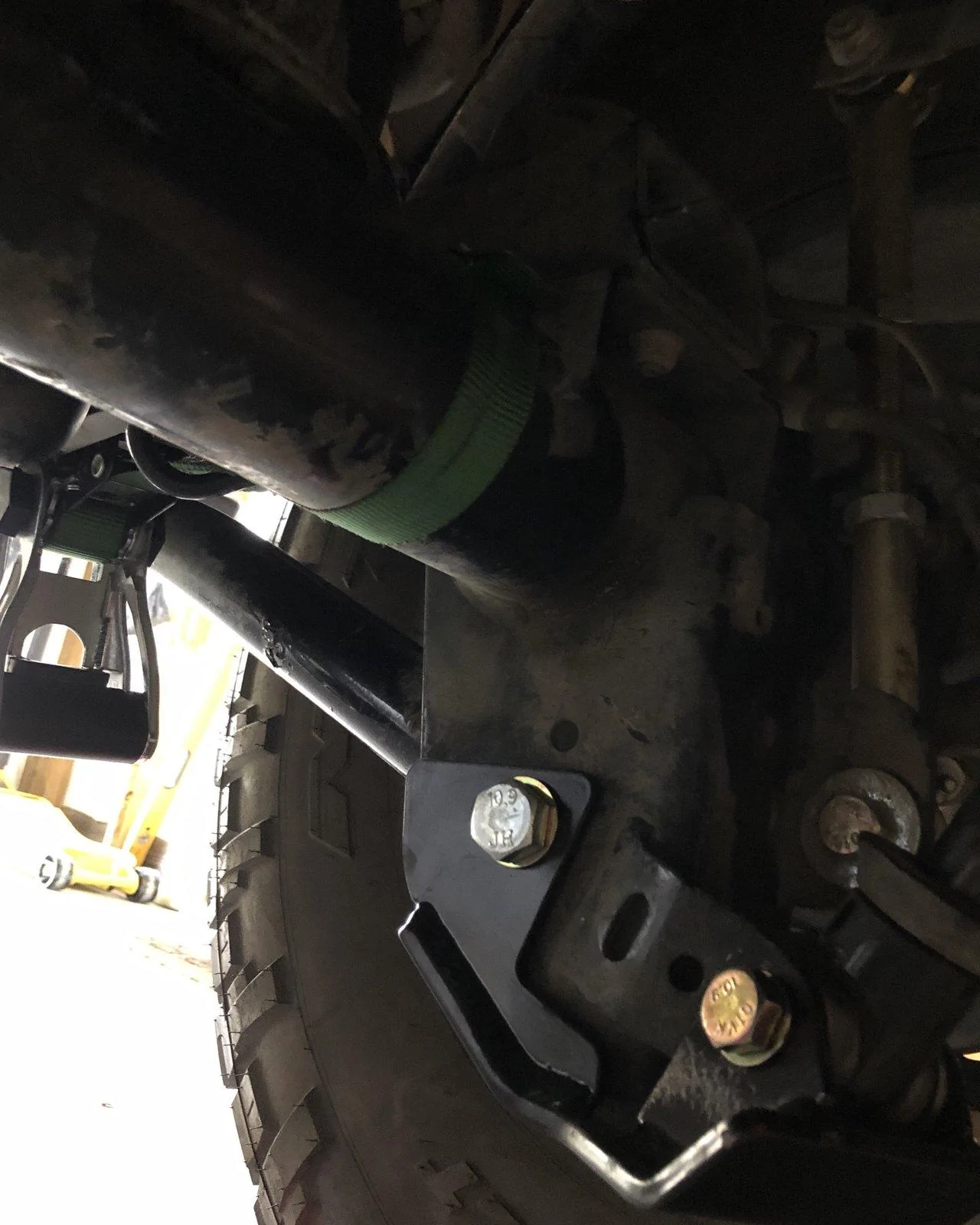

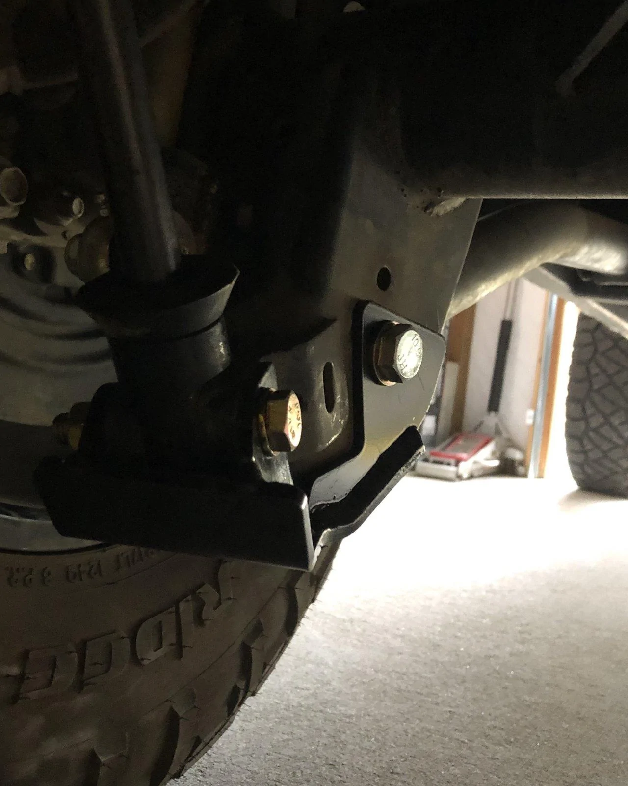

Got all my low hanging fruit skidded now, just finished up the shock / control arm skids. Had to paint them though, was to much red.....:facepalm:
Had use ratchet strap on one side to get the bolt in, otherwise pretty simple.....:)
