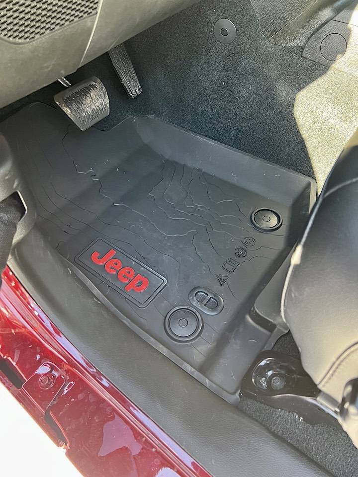

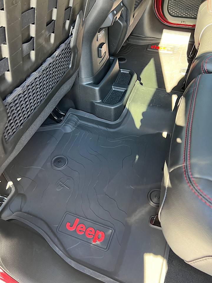

Installed! Thanks to this thread! And the rear is slick too because it’s in 2 pieces but locks together in the center.
Jeep Wrangler JL Floor mat drain holes 149DB285-03C0-47A2-A2B3-A19276A9C265
Jeep Wrangler JL Floor mat drain holes B2FF9486-42D4-4DA4-B06E-F41684D44C1B
