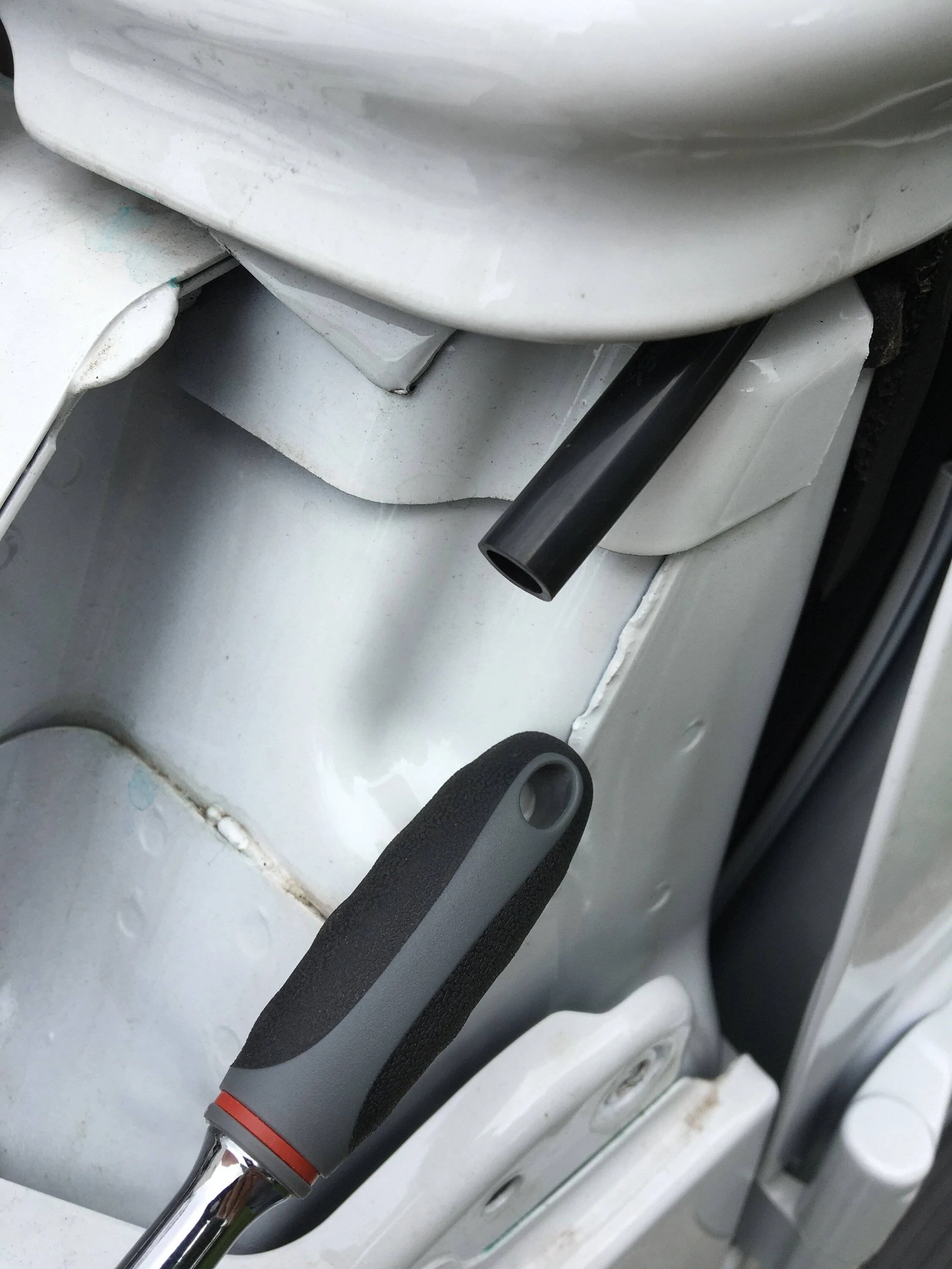

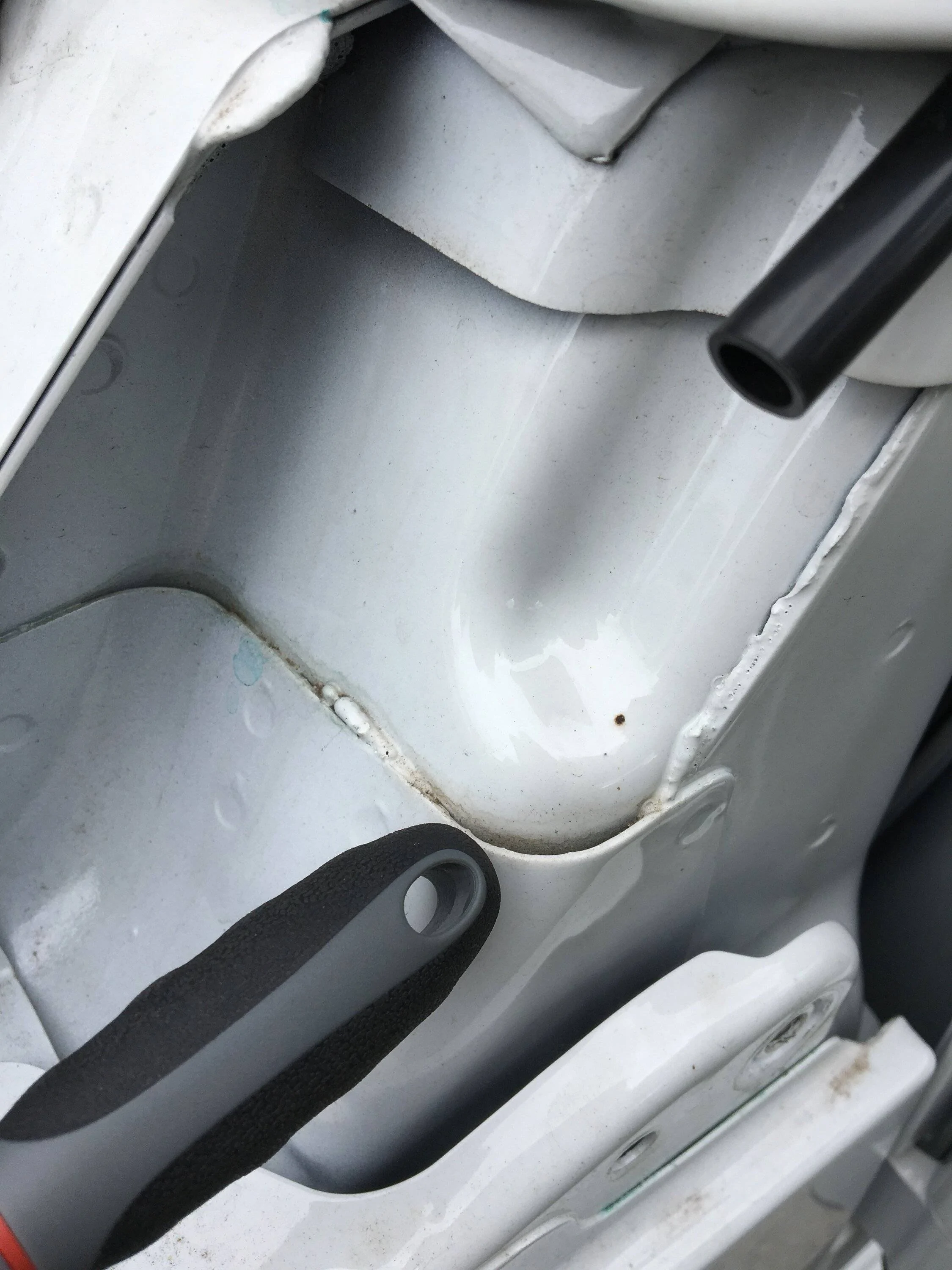

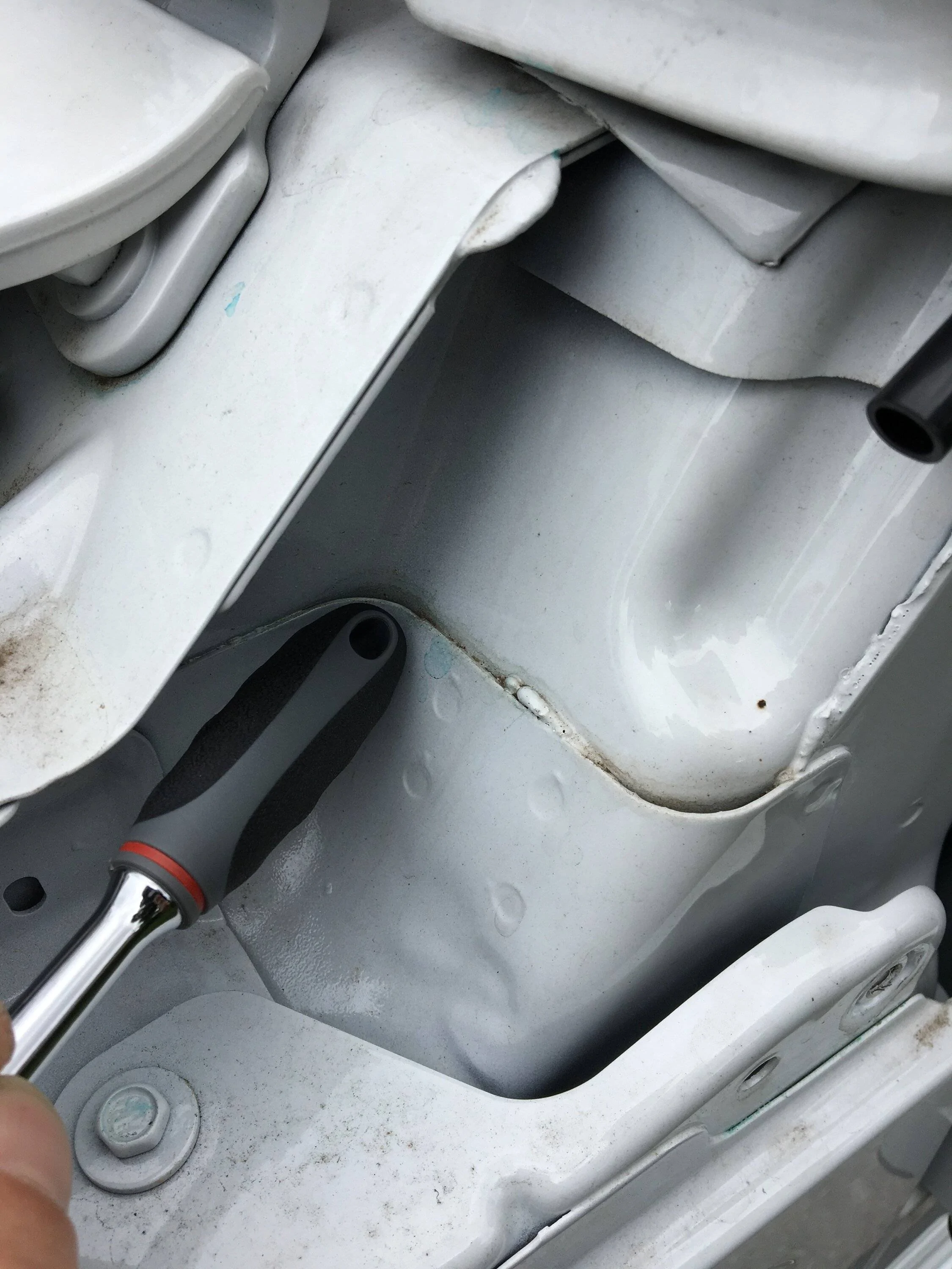

im sure you have already checked the normal spots for leaks - tops and drains in the windsheild track /corners
but have you checked the seams under the cowels?
i had the same issue with heavy rains as well , narrowed it down to the seams under the cowels.
either they were not sealed or not done correct, possibly a monday at the plant lol
i pulled the covers and used autobody seam sealer on both sides. problem solved
it may not be the same for you but its worth a shot
u can see my pix where the seams are open . and where im pointing to look and where the drain tube is, water just went right into the open seams . hope it helps

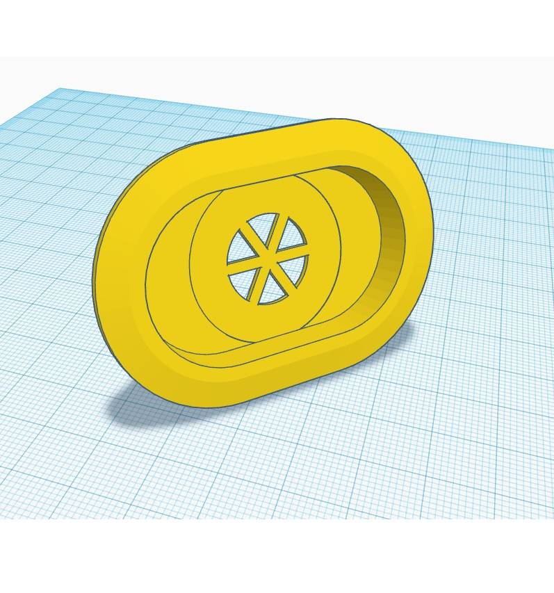

good luck with the leak , i know how they can drive some1 crazy lo
if your idea does not work i can possibly try to make something that will let the water out , but not let it in very easily . made a fast mock up idea/ plug based off the rear cargo one sort of. it will need a diaphram of sorts as the flappy part and im sure more measurements/modifications
just for sh%t$ and giggles of course
Jeep Wrangler JL Floor Boards Drain Plug Idea 1
Jeep Wrangler JL Floor Boards Drain Plug Idea 2
