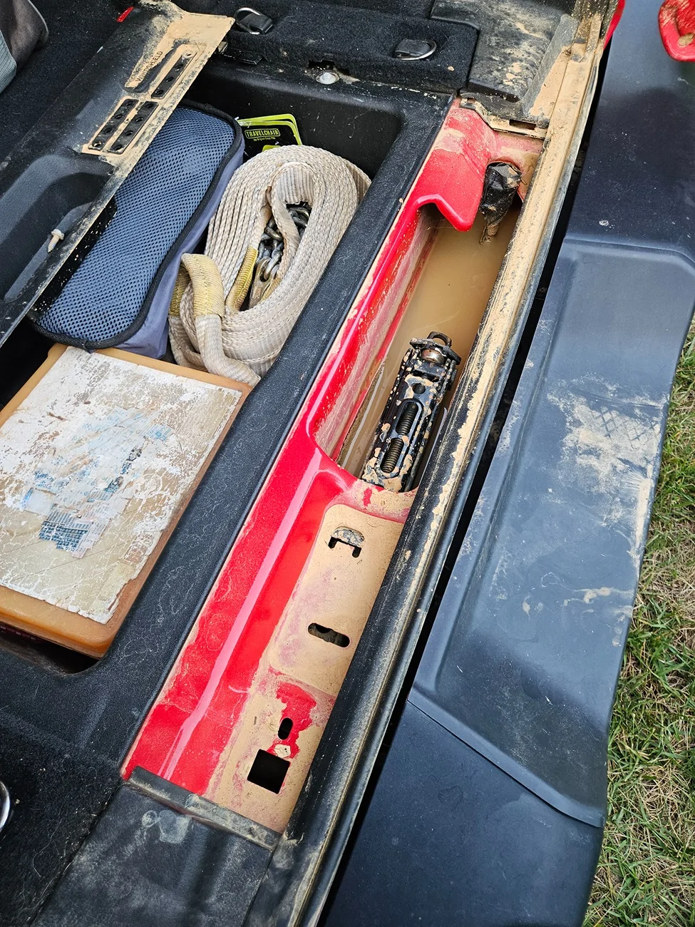

Before I plunged my hand into the pool of water, I figured it would be smart to ask the Google. In the end, I found a drain plug identical to the one in the original post.
I forgot all about the jack storage area, but today noticed water moving thru the windshield screw holes in the jack storage cover. I was putting the Jeep back together after yesterday's downpour.
