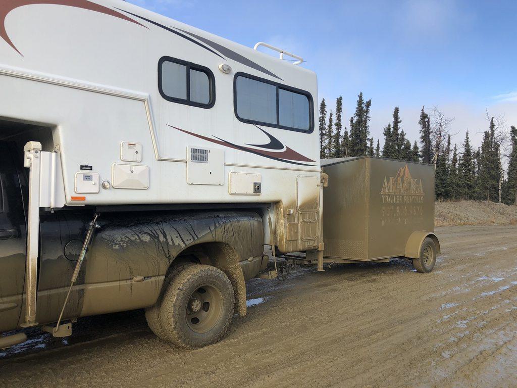

I have a heavy Bigfoot truck camper in the back of my Dodge Cummins Dually. It is just below GVWR and will be the rig I will tow my future diesel wrangler with a Rockhard bumper. I guess I'm going to do everything wrong. :LOL:
Jeep Wrangler JL Flat-tow Set-up nkIRtW9h

Heres some pics of mine. Sometimes I tow a trailer.
Jeep Wrangler JL Flat-tow Set-up IMG_0424
Jeep Wrangler JL Flat-tow Set-up IMG_0427
Jeep Wrangler JL Flat-tow Set-up IMG_0467
Jeep Wrangler JL Flat-tow Set-up IMG_0464
