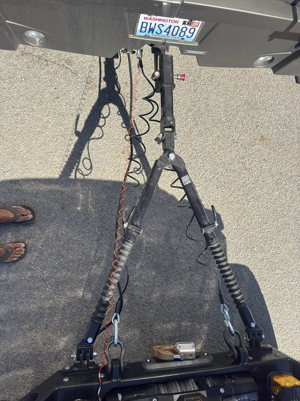

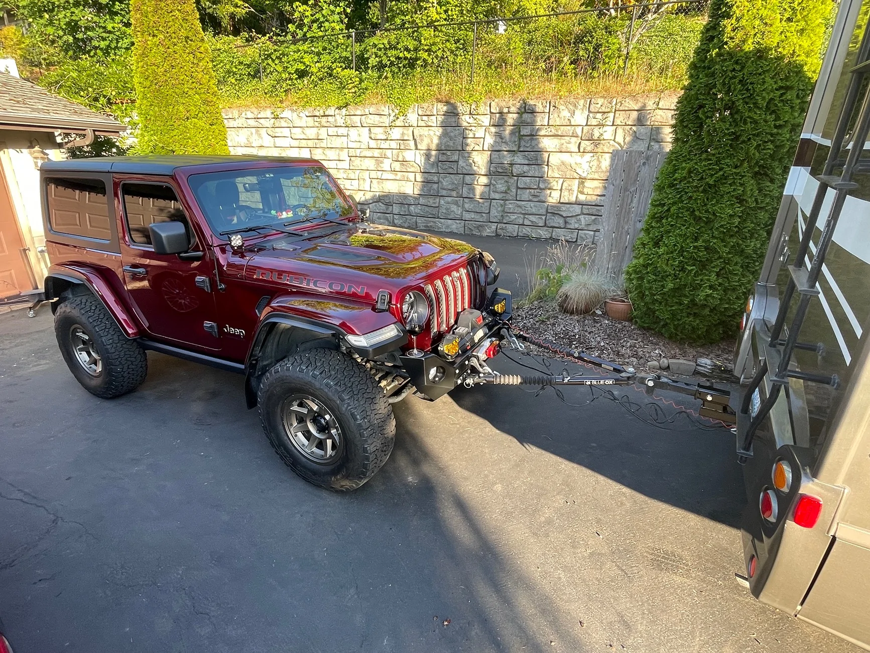

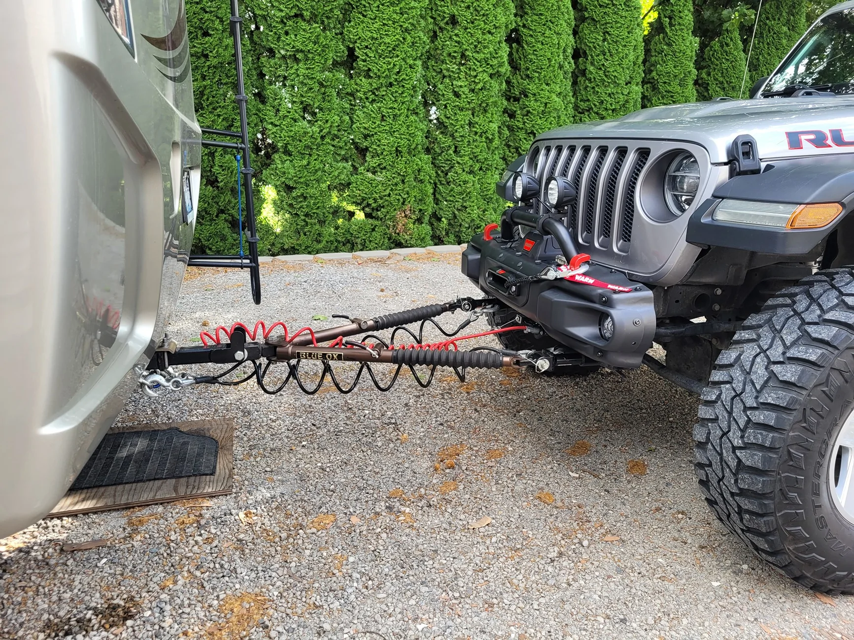

Another vote for RockHard4x4 aluminum bumper. Paired with Blue Ox aluminum tow bar and a Demco Stay n Play braking system. All over the west and mountain passes. Quick to connect/disconnect.
Jeep Wrangler JL Flat towing set up IMG_4875
Jeep Wrangler JL Flat towing set up IMG_4473
Jeep Wrangler JL Flat towing set up IMG_2599

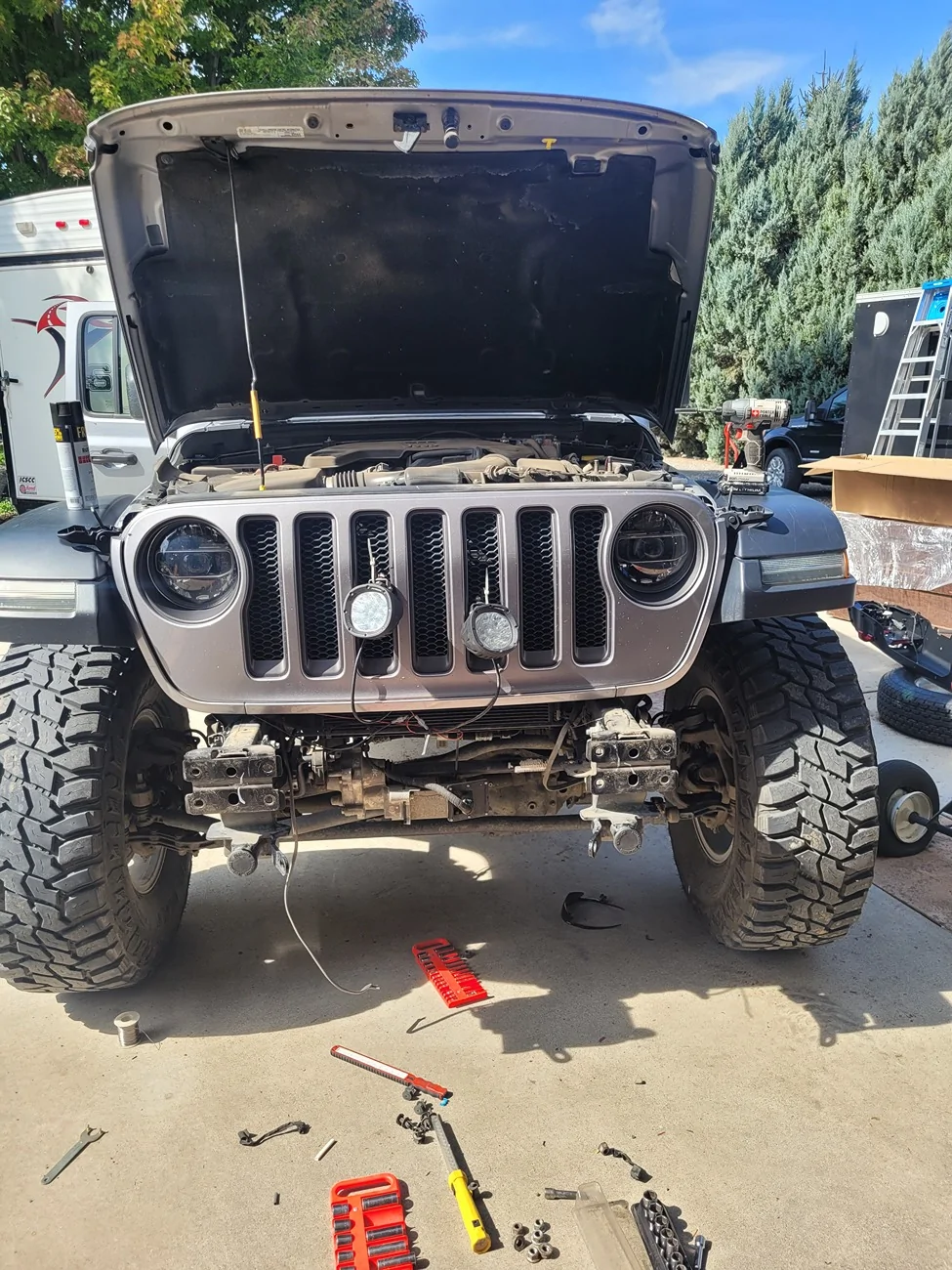

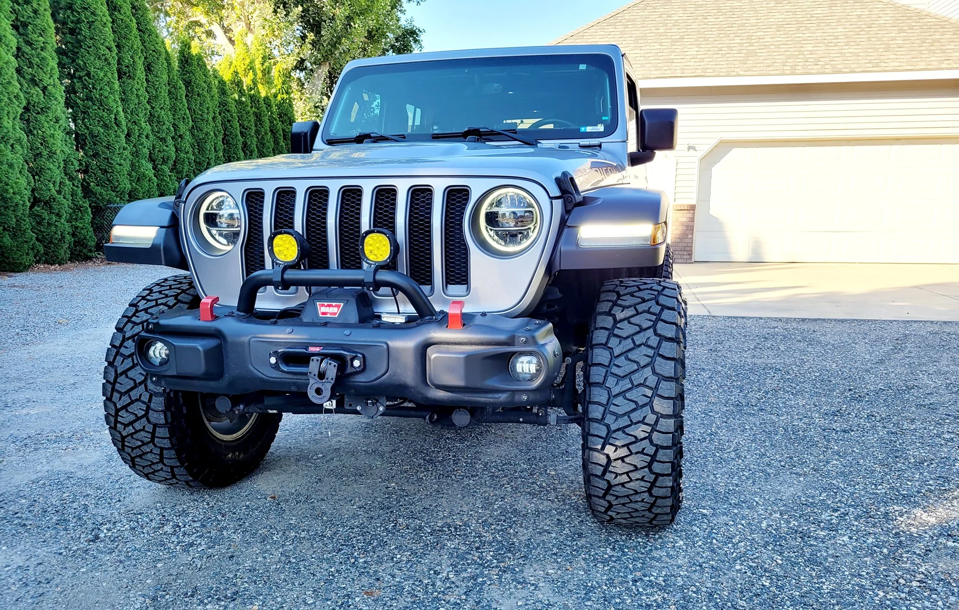

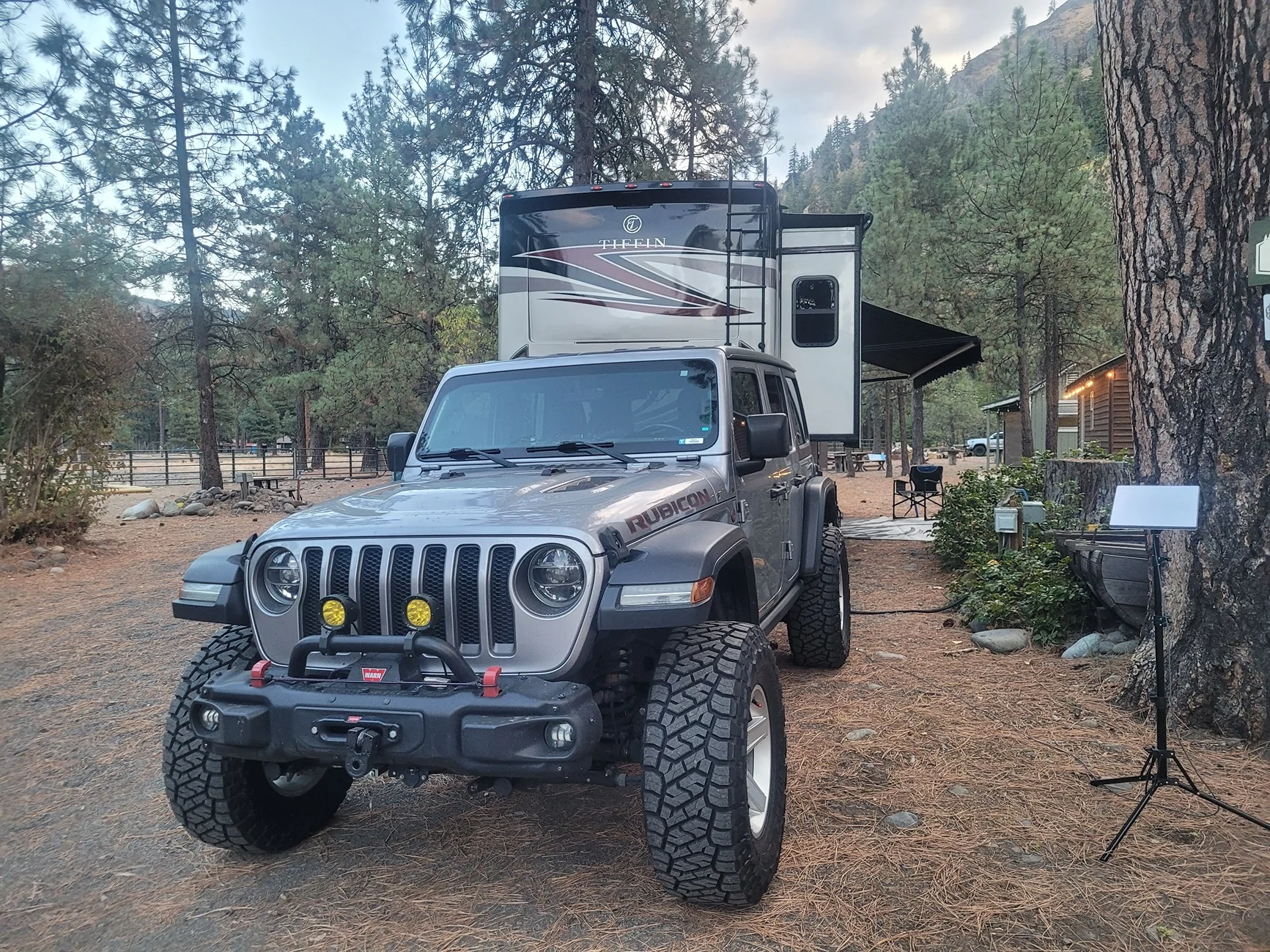

Roadmaster direct connect baseplate mounts. Many years and thousands of miles. Barely noticeable when ends are removed. With the towbar connection under the bumper, no hitch riser is needed with my lifted Jeep.
Jeep Wrangler JL Flat towing set up 20251010_180318
Jeep Wrangler JL Flat towing set up 20250810_082210
Jeep Wrangler JL Flat towing set up 20230928_131117

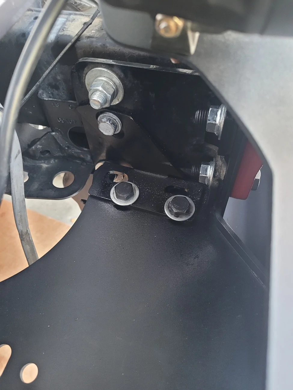

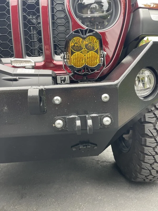

The best I've got. I shaved a little off the inside of the winch plate so it would fit in between the Roadmaster mounts which sandwich the frame. I use a Demco Stay-in-play brake, which is great. Previous Jeeps I used the RVI3, which was also great for a portable. The first pic you can see the inside of the Roadmaster direct connect mounts that capture the frame on both sides.
Jeep Wrangler JL Flat towing set up 20230922_172723
Jeep Wrangler JL Flat towing set up 20230922_130735

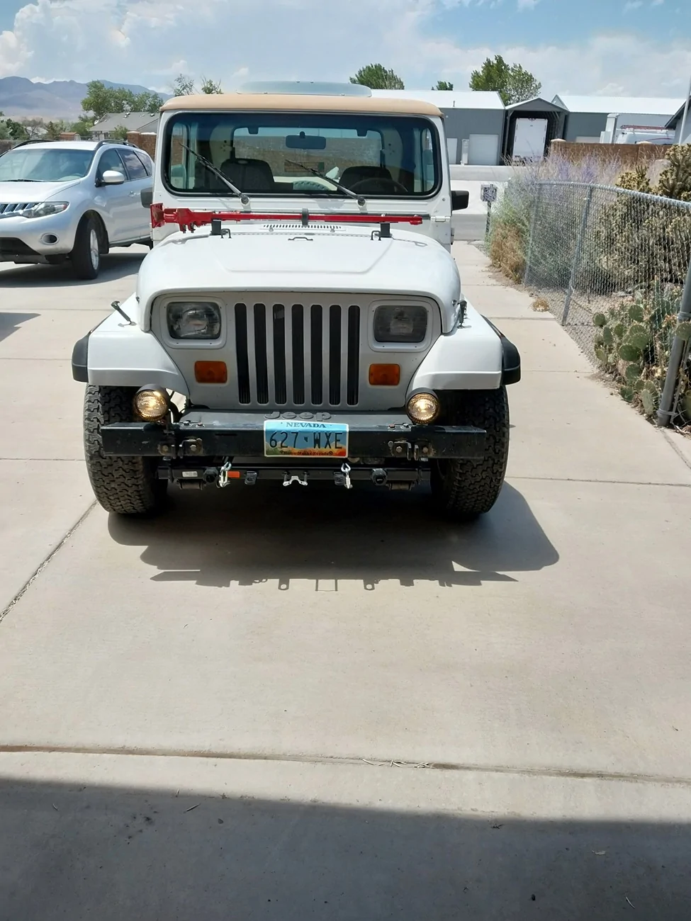

I have NSA Tow and Brake life time replacement parts made in usa and i like their Brake set up easy setup
Jeep Wrangler JL Flat towing set up 20260619_133306
