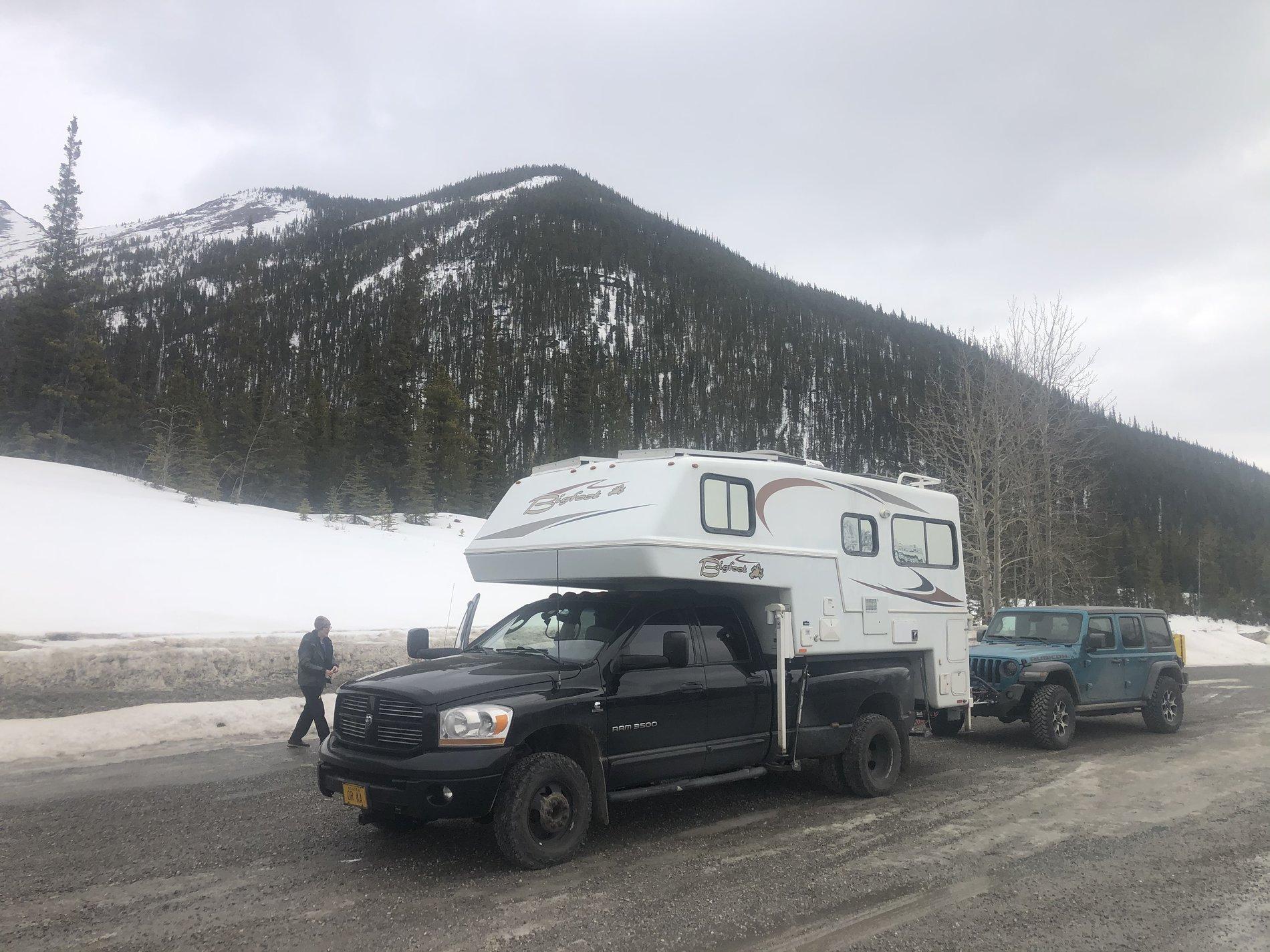

KINI loves her Rockhard Aluminum Bumper. Made a 4,000 mile trip through Canada to our home in Alaska without issue.

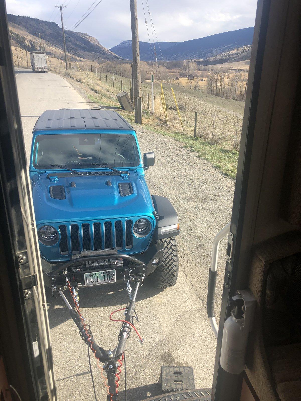

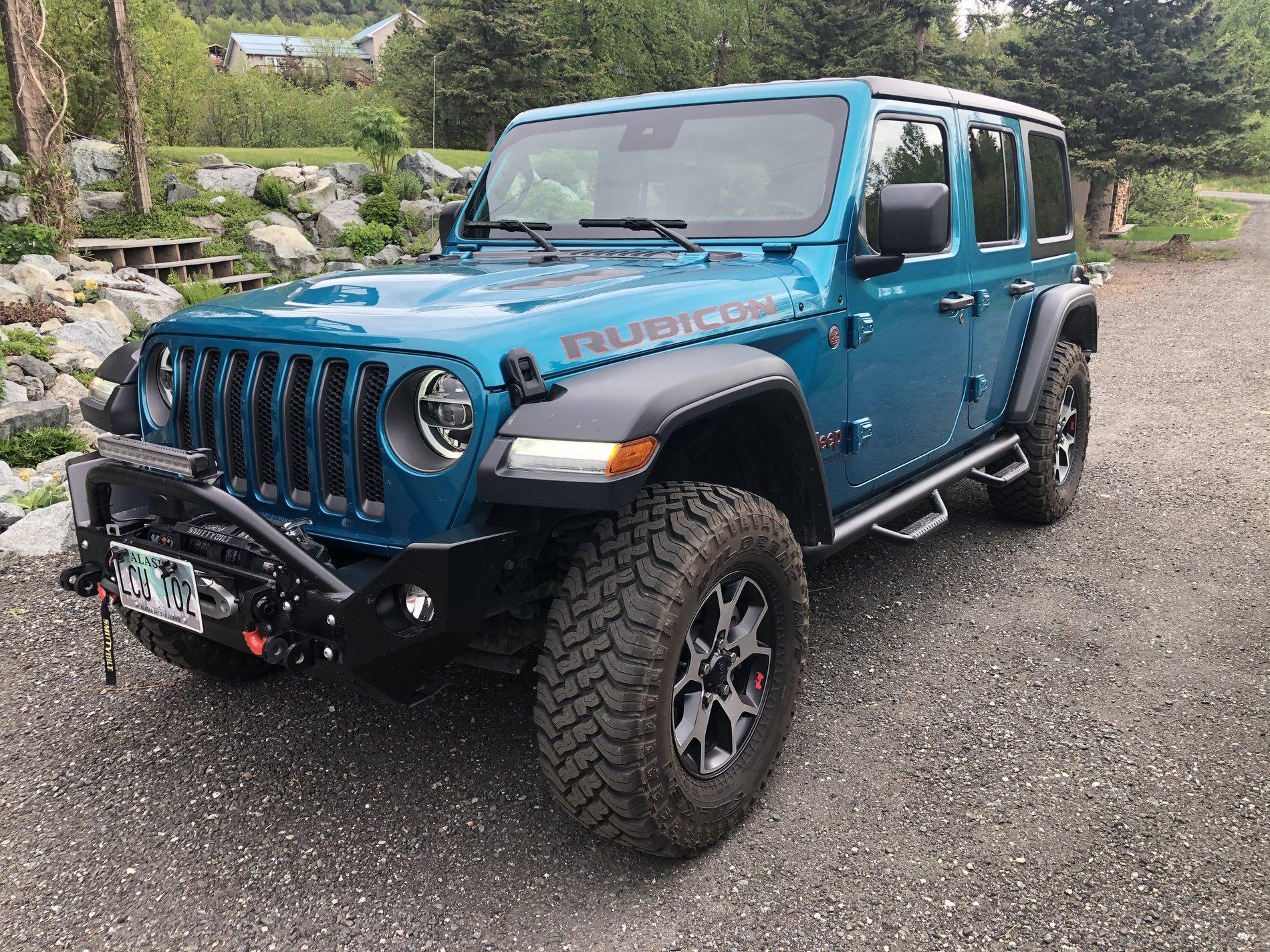

Another Rock Hard Patriot aluminum bumper here. A Blue Ox tow system and cool Tech wiring harness.
I'm basically copying your set-up. Do you like having your electrical plug mounted where you placed it? Would you do anything different? Thanks
Thanks for those pictures, I'll have a similiar setup once my flat tow setup is complete. I have a 2011 Dodge 3500 crew cab dually with an arctic fox truck camper, and plan to setup my 2018 JLUR to flat tow. Enjoy!
