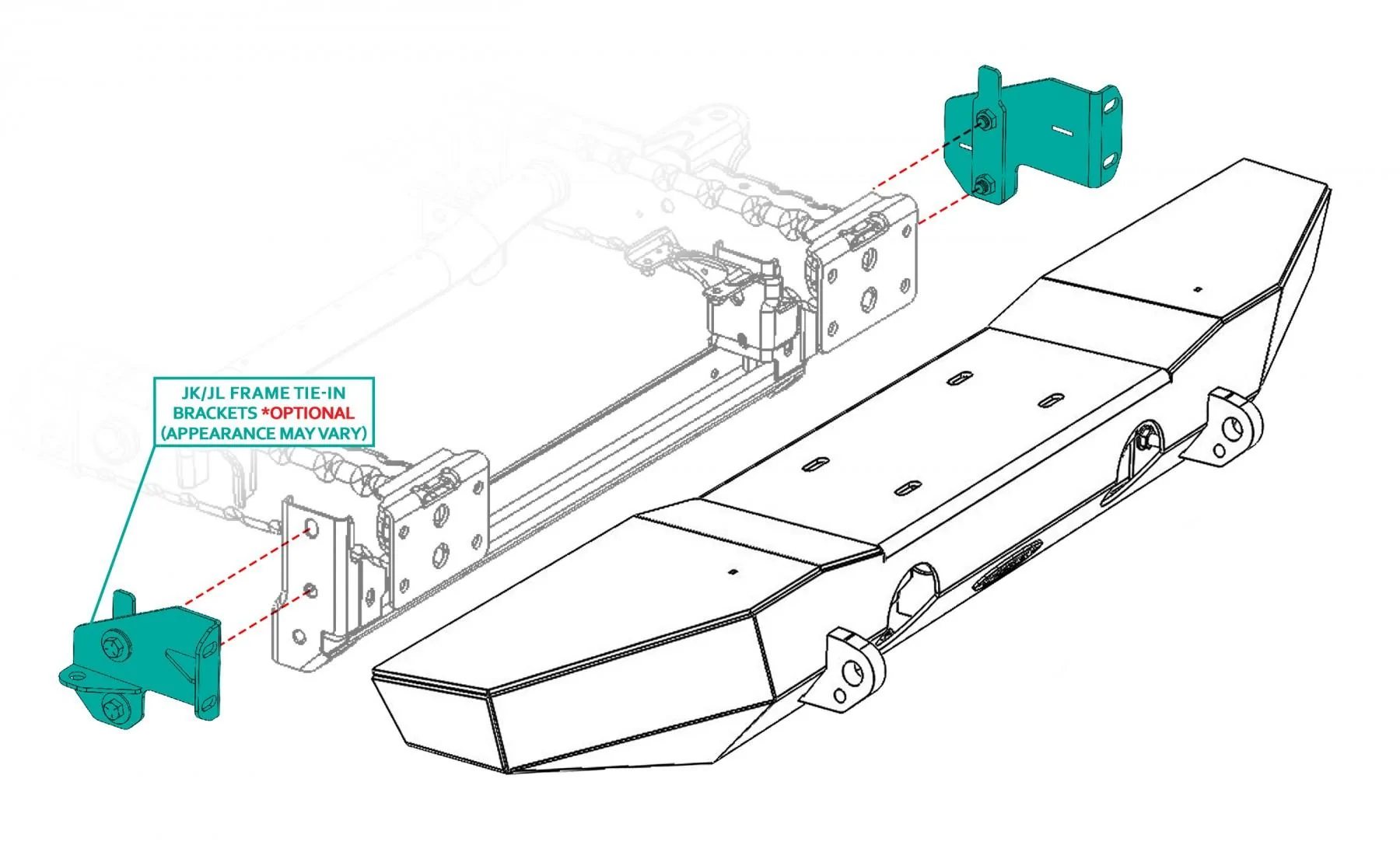

Good news all. I am happy to report that the LOD frame tie in brackets work almost perfect with the rock hard patriot bumper.
I say almost perfect because the bolts that come with the bumper are too short to account for the thickness of the bumper, tow adapters, bumper mount on the Jeep, and the LOD tie in brackets.
I have to run to ace, and pay a small fortune for some grade 8 bolts and washers to get everything fitted up.
Rock Hard certifies their bumper, and mopar certifies their frame, so this gives a total safe & secure solution.

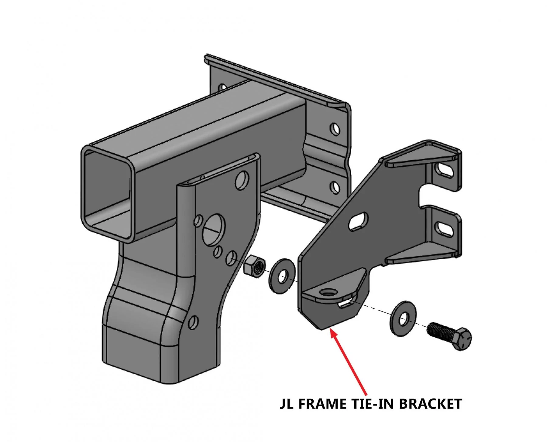

Regardless I will be bumper towing shortly myself as I am ordering the NEW LOD Tie In Bracket and Blue Ox connection and will be Bumper towing shortly.
As you can see below that frame plate is not very robust and this tie in bracket seems to be the answer, Kudos to LOD

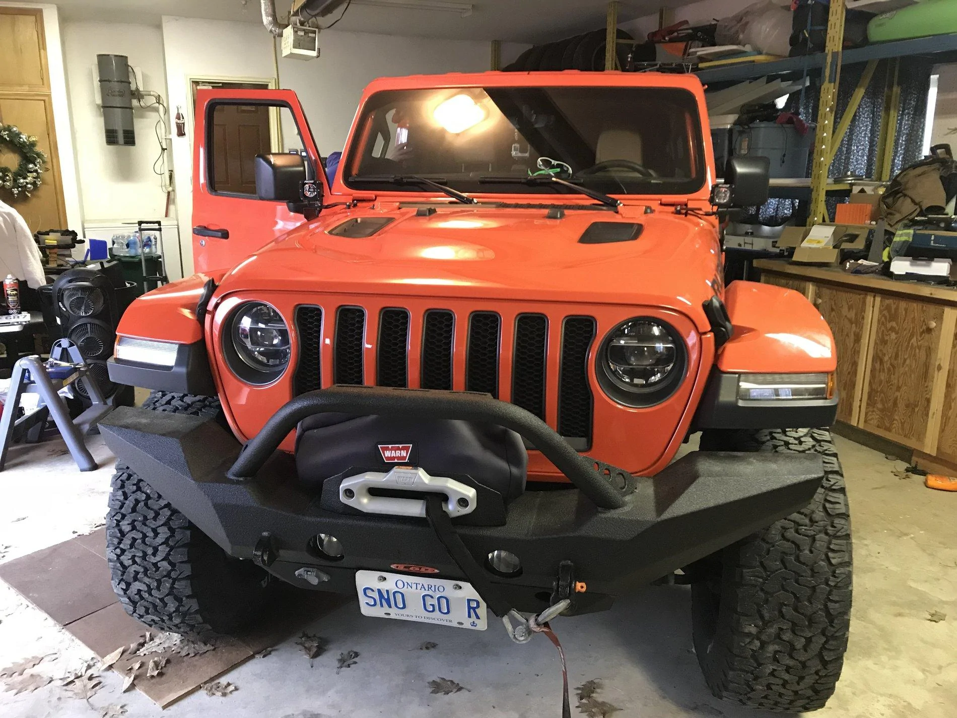

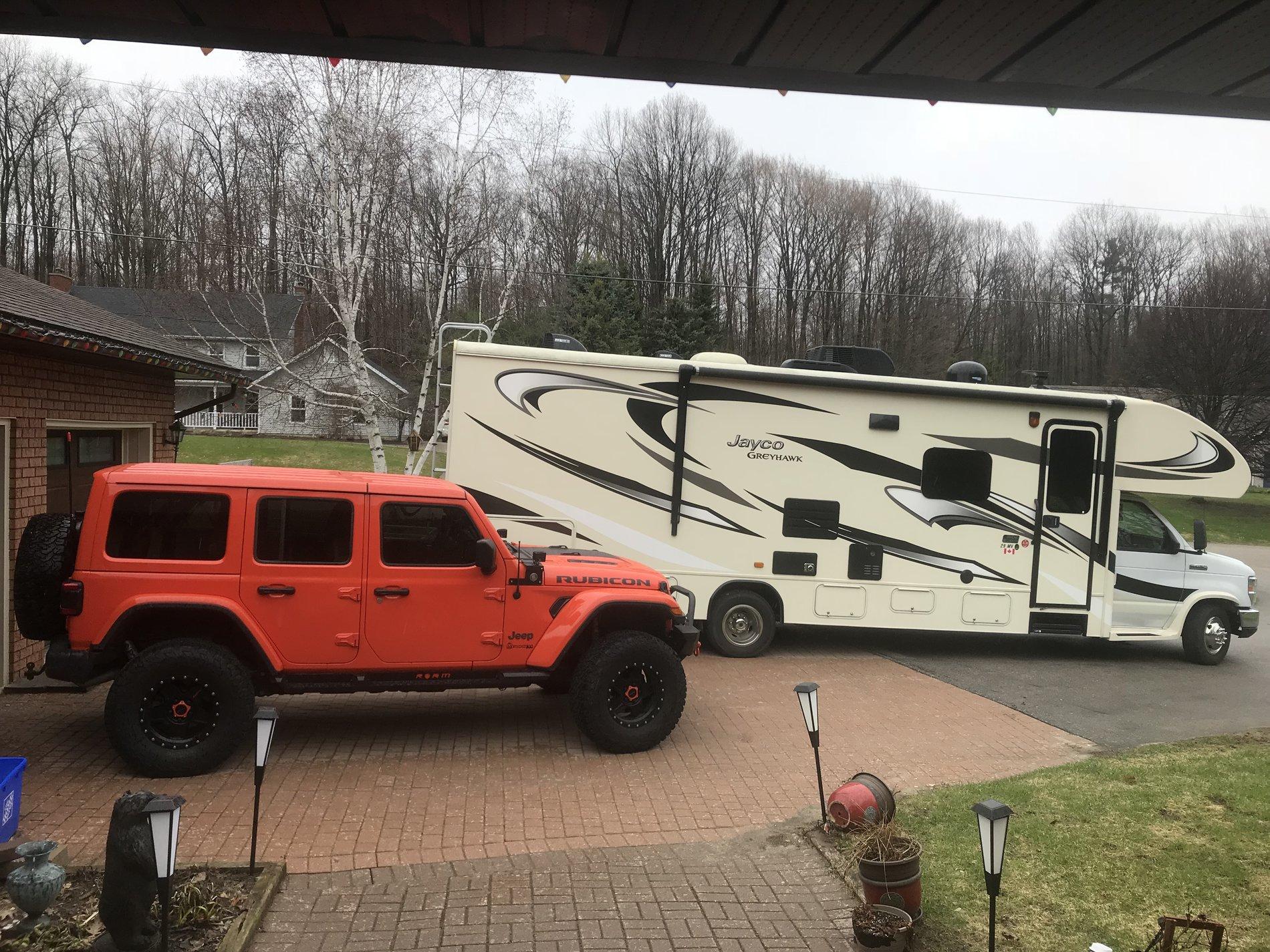

I will be flat towing for the first time in 2 weeks. I got the motorhome out of storage and will start getting ready this week. I will be using my LOD bumper with blue ox adapters. I also order LOD new Bracket just to be extra safe. I hope they arrive before my first trip.
Tow package
2016 Jayco 30ft class c Motorhome
2018 Jeep JLU Rubicon with mopar lift and 35 inch tires
LOD flat tow ready Bumper
Blue Ox 6000lbs tow bar.
Blue ox Patriot brake system
Cool tech light harness

That is correct however only due to the fact that LOD now has a base plate solution with their new Tie In bracket, I originally ordered the LOD bumper until I learned that Mopar said the frame plate should not be used for flat towing, I then canceled the bumper order and installed the Blue OX base plate.
I made it clear in my positions from the start that I would have preferred to bumper tow except there was NO safe way to do it, now LOD has made that possible. I already have a bumper that will work just need to add the tie in bracket and Blue OX bolt through connection. However I may wait till there is a 4-bolt version, not a big fan of the two bolt Blue OX connection bracket.
The other issues non tow related with all the towable bumpers is they were steel at the time and still today they are all tall meaning that they did not improve clearance over the base plate option, now because my Barricade bumper is lower profile than most I will gain a couple inches.
My bumper tow position has not changes I wold not tow soley or directly off the bumper frame plate and I would encourage anyone who is to seriously take a look at the LOD Tie In bracket. It also looks like a very easy install.
