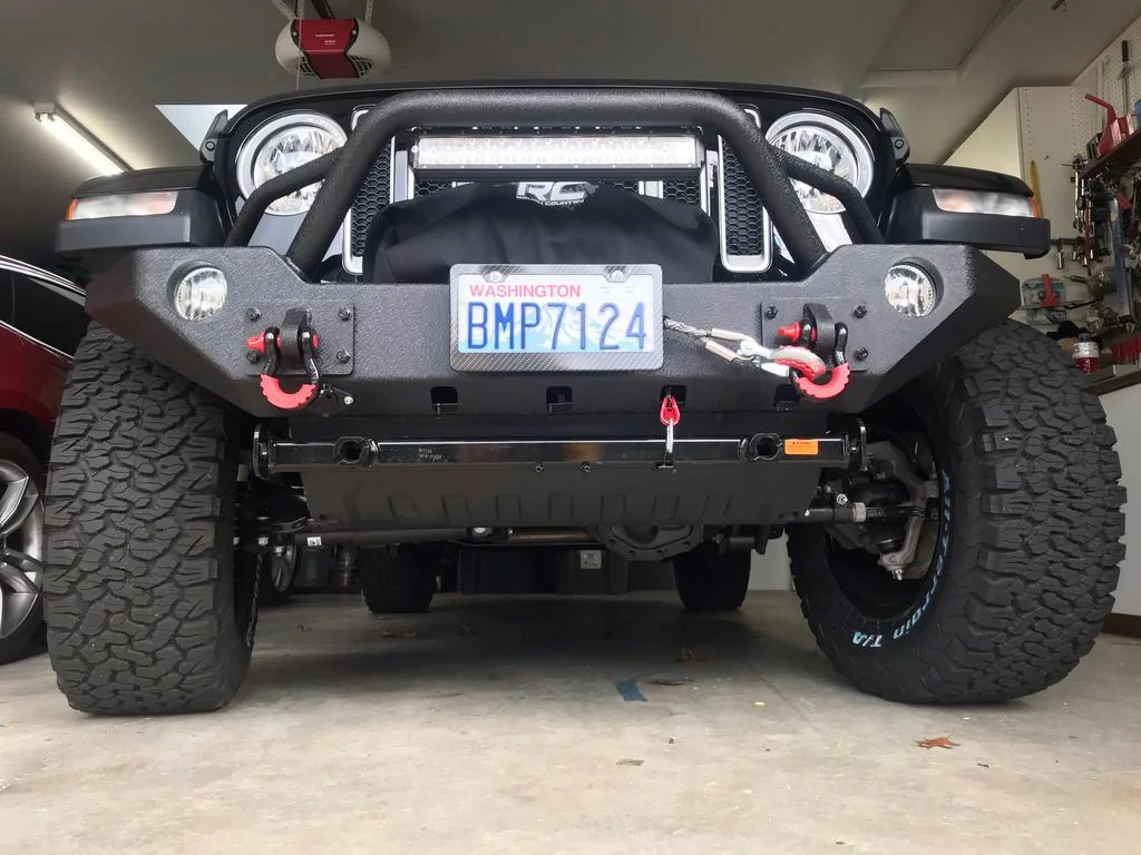

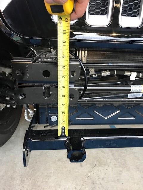

No, thats perfect! Trying to remember what the connect point height was on my CRV. I have a Class A DP. Do you use a drop hitch?For what it's worth, I have a Rubi with stock tires / rims and it is a little over 19" from ground up to the center of the Maximus tow loop hole. Attached (hopefully) is a quick pic of my front bumper setup. I centered the 6-pin and breakaway connections between the loops. And yes, I need to plasti-dip the 6-pin black.
