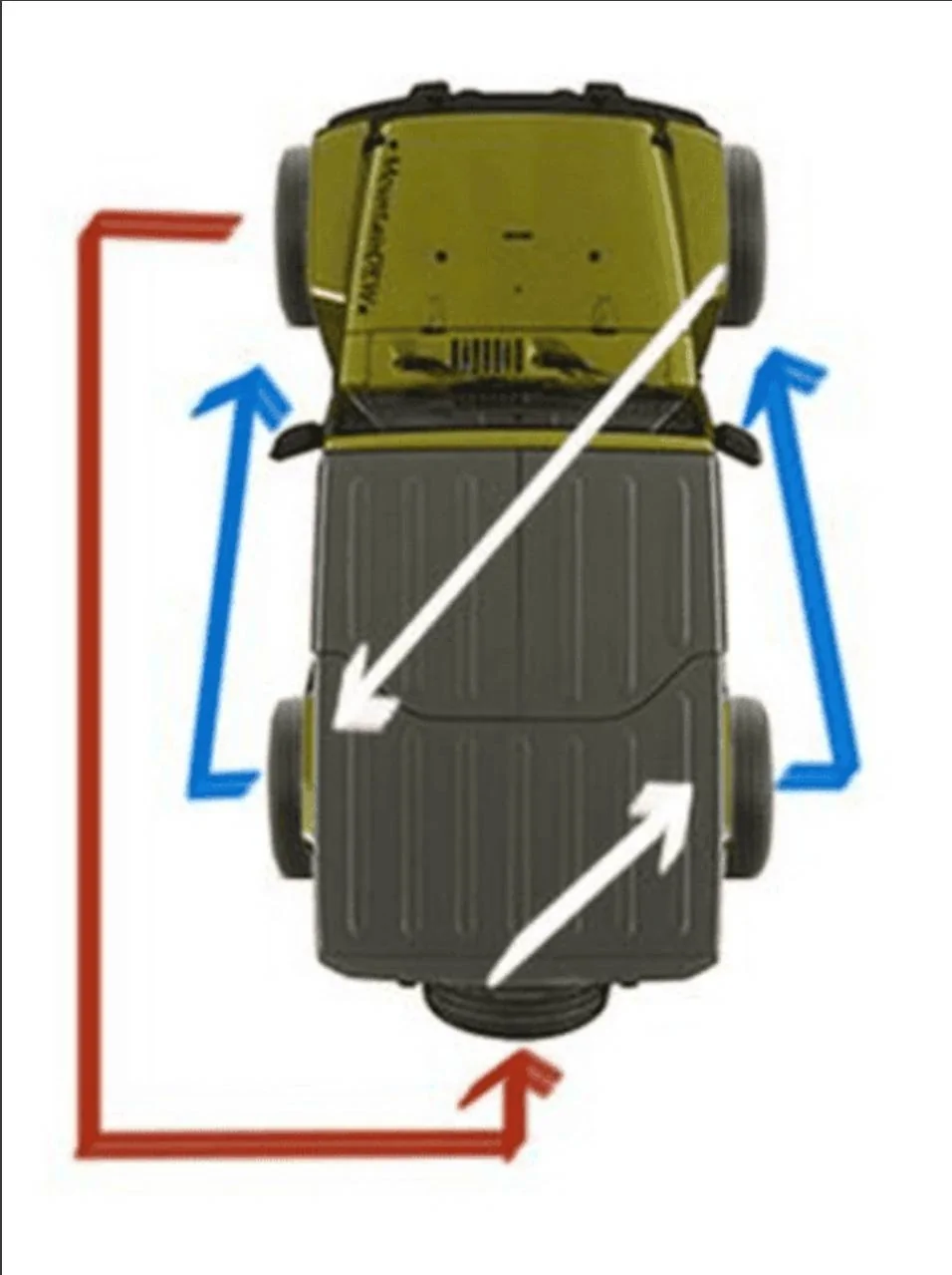

tires wear differently on the front than they do on the rear.
i want every tire to be on the axle opposite of where it was on the ground last time it was on the ground, and i want tires on the same axle to have both been spinning the same direction last time they were on the ground.
just going around clockwise or anti-clockwise means that one of your tires on each axle was spinning the other way last time while the other one wasn't, and only one of the fronts has had a chance to smooth out on the rear since it was last on the ground.
Can someone please explain why after 5 tire rotations, where every tire has been in all positions, you guys still keep using the Madden system? I'm trying to understand the benefit and can't find one, over the simple clockwise rotation (no printers, diagrams required)

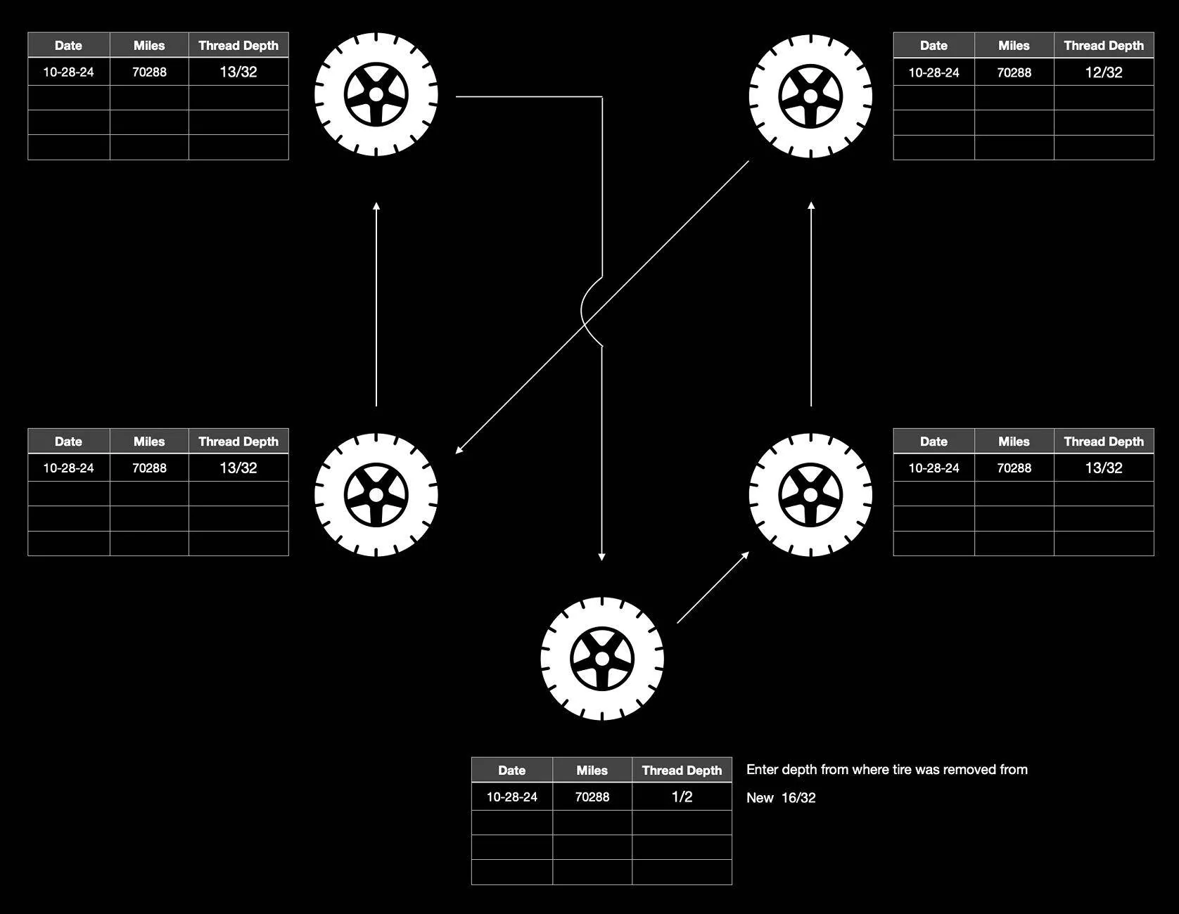

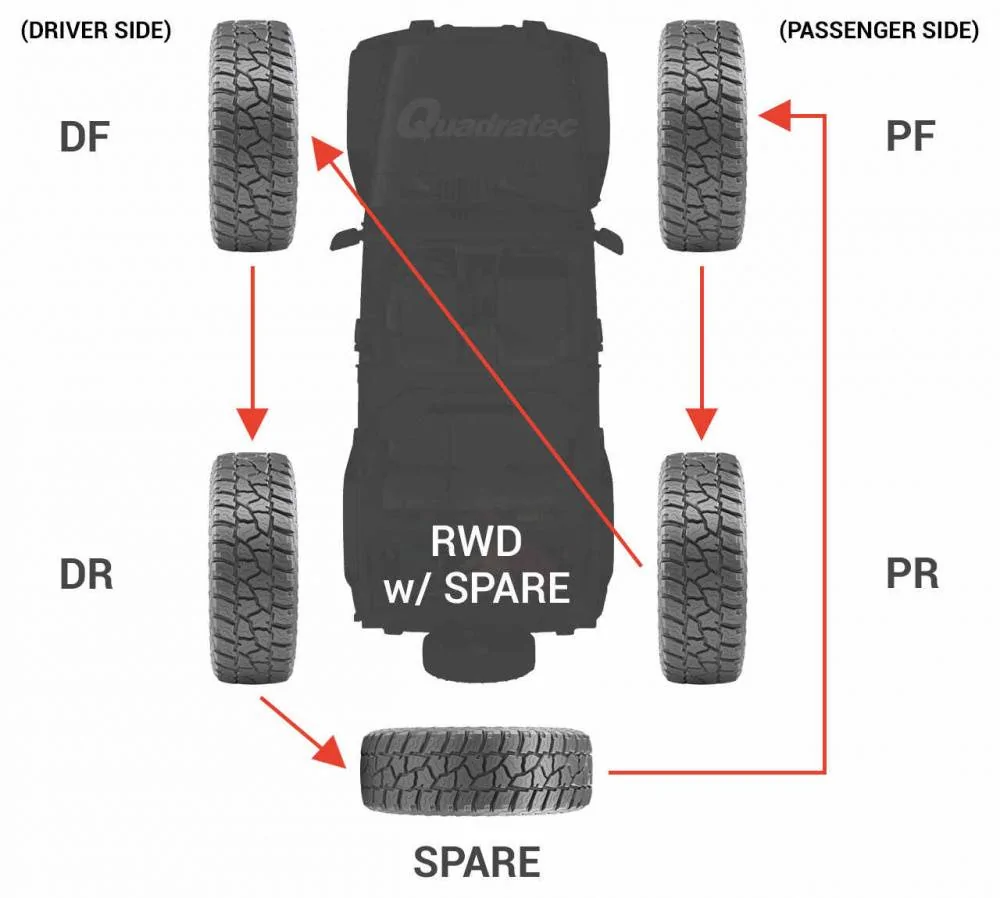

Discount Tire, where I have my rotations done, has suggested three different rotation patterns depending on who I've talked to each visit.
I've settled on the simple clockwise 5-tire rotation at around 4,000-mile intervals, trying to extend the life of my KM3's as much as possible. Discount Tire has been great to work with.

I hear this, after 5 rotations, every tire has been in every position for the same amount of time, goofy Madden directions make NO DIFFERENCE to this fact, IE every tire will have been on the left side for 2 rotations, every tire will have been on the right side for 2 rotations and every tire will have been on the front and back for 2 rotations each.

Assume the front tires receive 2x more wear than the rears and you rotate clockwise. The passenger front tire will always have received 4x the wear of the driver rear when you go to do your 2nd rotation. The alternative approaches here are intended to prevent that type of mismatch.

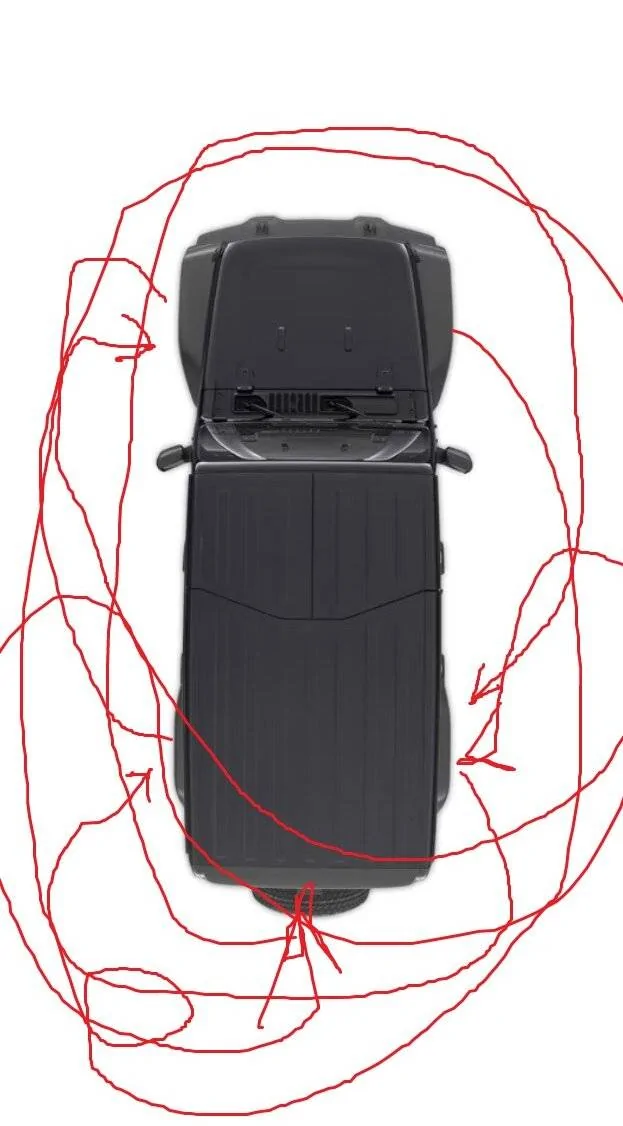

I think I'm going to keep how I rotate my tires under my hat.
I'd get pummeled!
