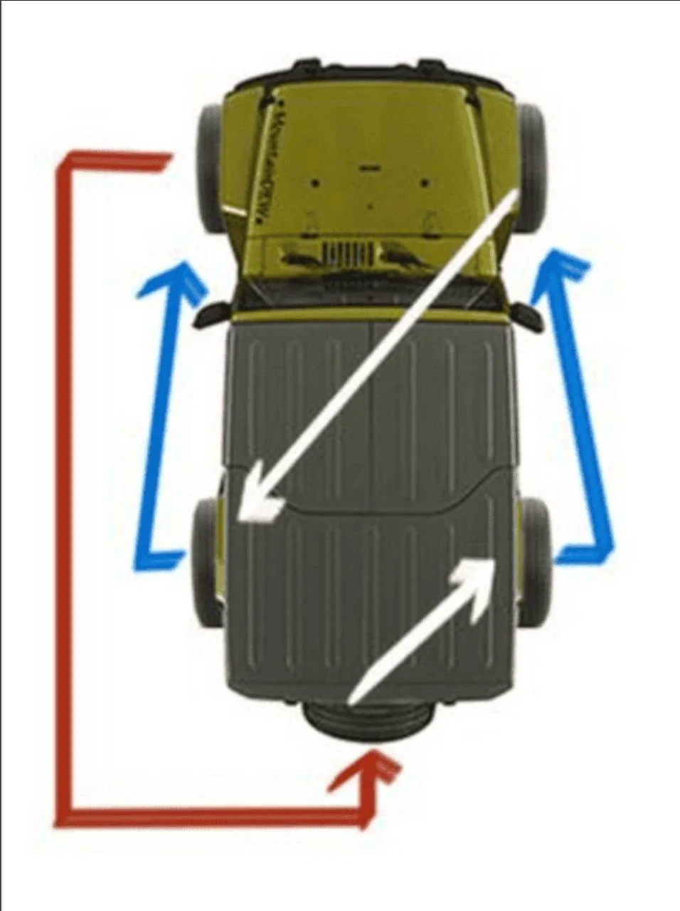

This is what I use. The cross rotate of the fronts to the rear to even out any potential cupping is what I like about it.
Jeep Wrangler JL Five wheel tire rotation pattern 1738436493069-62

This is what I use
Been using the same pattern, but last month I stopped in to a local tire shop (just one dude) and gave him this printed out, which he's done before with my dad's Jeep and for some reason, all the colored arrows everywhere must've short-circuited his brain that day. Poor guy just stared at the damn thing for probably 10 minutes.
Jokingly told him I found it on the internet, so it must be right! But I actually felt kinda bad about it 😬

Lmao.. its not hard to understand.. poor guy.. lol
Yeah, it's not hard to understand and he's done it several times before from the exact same picture.
Sometimes you've just got a lot going on and some dipshit hands you a Jeep diagram with arrows of something you've been doing every day for 50 years and you're like, "What the fuck is this shit bro?" 😆
It eventually "clicked" with him and he quickly got it done, torqued the wheels and spare down to the values I wrote on the paper, offered to adjust my pressures and only wanted $5 for everything (gave him $25 for saving my back). I'm letting all 3 of my Jeep "Waves" expire to either do stuff myself or get done by somebody that actually cares about their work, and this guy earned my business for my next set of tires!

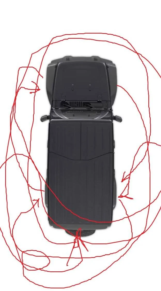

I can’t speak for everyone - but here’s my personal opinion/experience. The tires that I use, have an aggressive tread pattern. They’re a hybrid design with big mud lugs on the edges. These types of tires have a tendency to get uneven wear for various reasons, when in the front position. Any aggressive tire can have this happen. Rotating the front tires to the rear at the same time & cross rotation in particular; will correct any uneven wear and extend the life of those tires. The cross rotation will correct any cupping and/or feathering of the tread. And of course we get 20% more miles on tires overall.
This is what I do:
Jeep Wrangler JL Five wheel tire rotation pattern 1738587530641-og
This is what I do:
Thanks for your quick reply Art,
do you think this is due to turning and not proper camber, toe in adjustment, alignment?
Again after 5 rotations, every tire will have been at every position.
