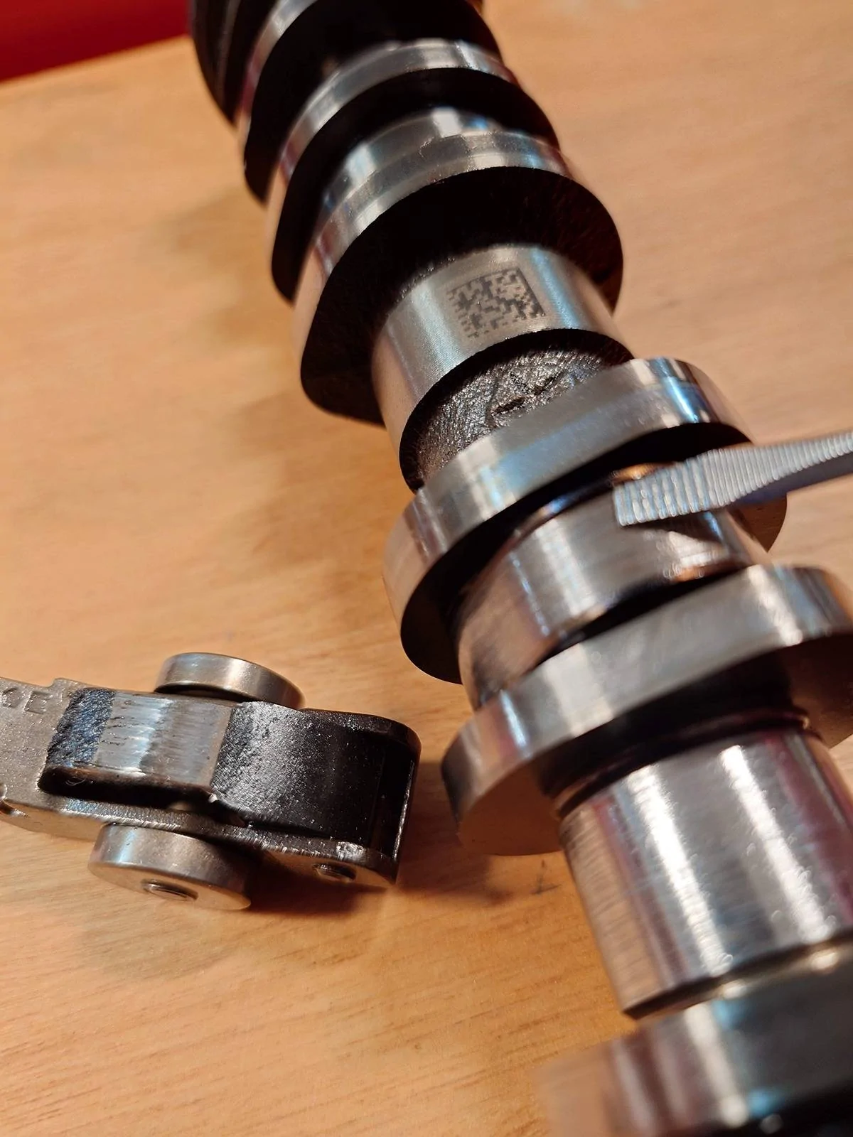

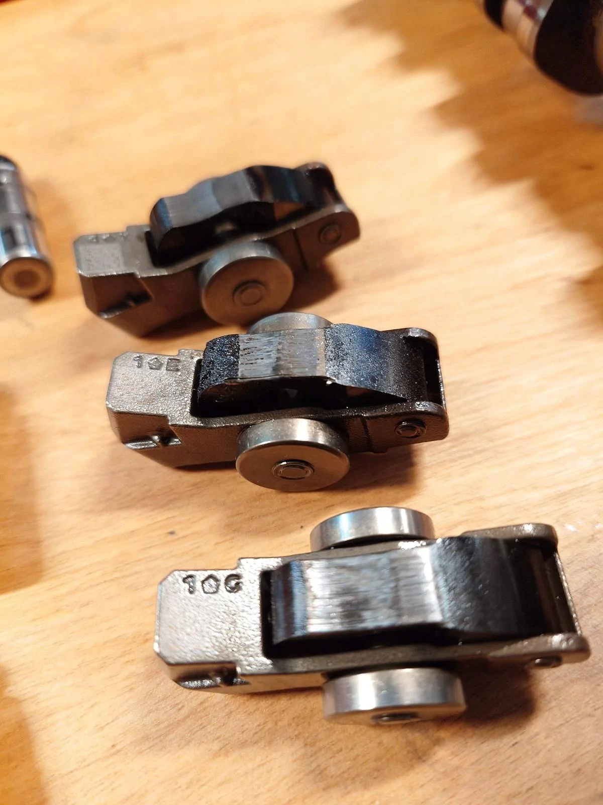

Just did my right side Intake Cam , Rockers, Tapets.
Mopar online has the Intake Cam 68661147AA for $464.49 (which includes the ROCKERS and Valve cover gasket, sparkplug gaskets, RTV)(it DOES NOT SAY THEY ARE INCLUDED) .... thatis cheaper then just buying (6) rockers separately 5047896AD for $519.78
Please post pictures of your cam! :)

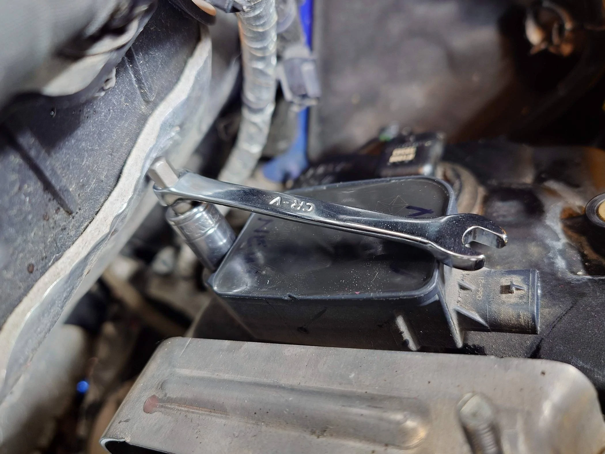

  1. No need to remove battery, or battery basket/holder. Many people say need to do this in order to remove the bolts holding the spark plug coils. But no need. The battery basket does make it very difficult but what you use is: find your shortest 10mm socket, mini ÂĽ inch wrench - closed end, and a 2.5 cm long socket to ratchet adaptor - see photo. (napa part BK 7755959). Put these together and you will be able to squeeze it onto the coil bolt and turn it off and on, all without removing battery and basket.

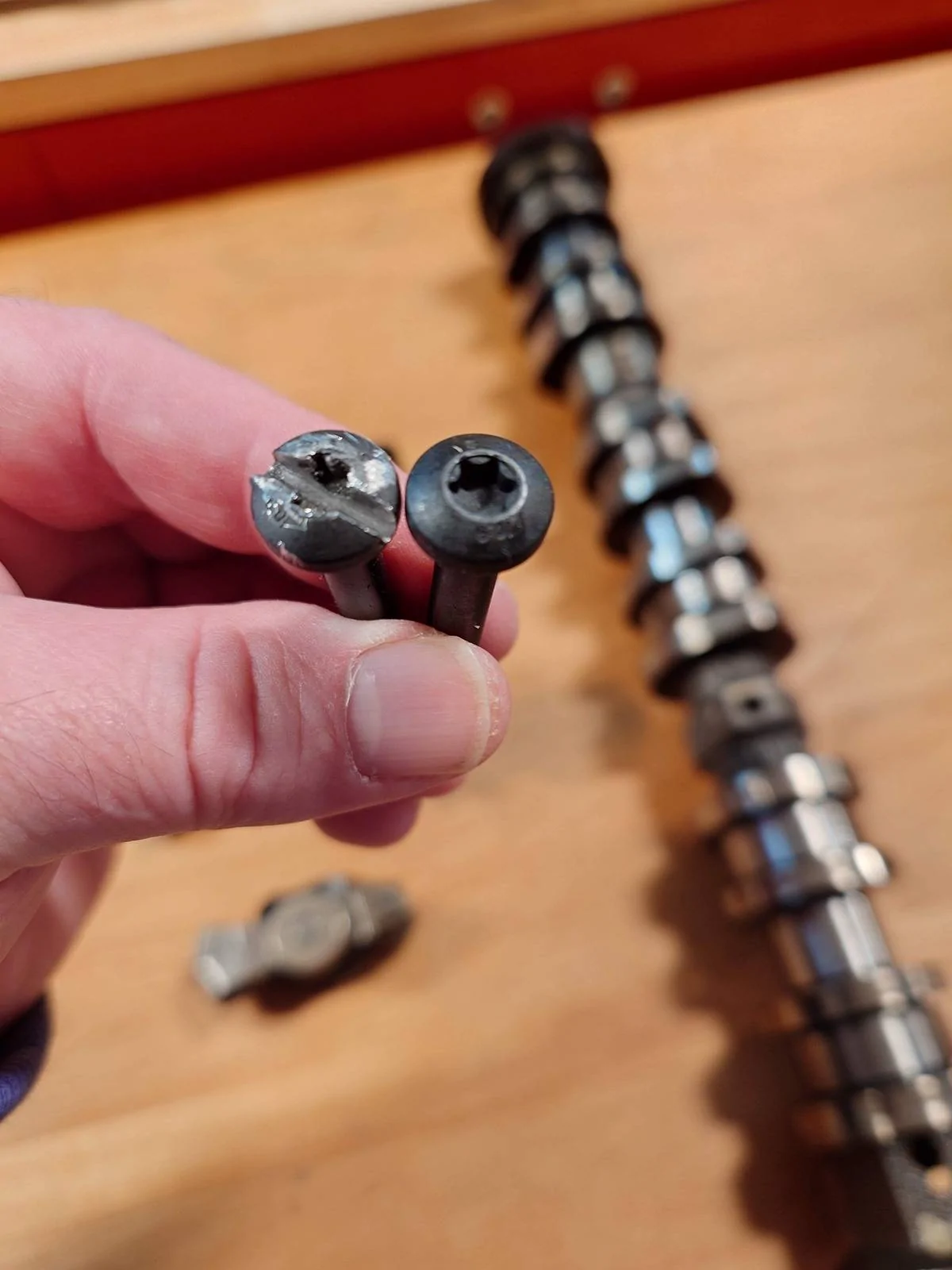

Man, I just want to know how you got a screwdriver to break that cap bolt loose. I've got nothing that will bite on mine without twisting. I think I'm going to have to cut the head off and vise-grip the body out once the cap & cam are out. But of course, mine's on a van, and it's naturally the passenger exhaust, so the bolt is hiding behind a spark plug tube in the far reaches under the cowl. /FML
For the stuck cap bolt.......I grinded a slot (like a flat head screw driver slot) into the top of the cap head. I used an electric hand drill with a tiny circular grinding bit...then I cut the slot. Then I used a big (wide enough to fit accross the cap head) flat head screw driver bit attached to a ratchet, then I had to push down hard with one hand on top of the ratchet over the bolt, and the other hand slowly turn the ratchet. beofre turning I also put some drops of WD40 at the seam of the bolt head and the cap face to try to get the WD40 down to the threads, and gave it about 10 minutes. (dont get WD40 on the top or your flat head bit or will slip). Trying other things, and thinking up this plan etc etc took me about 2 hrs to get the damn thing off. really sucked. Good luck!!

Thanks. I have to keep remembering that this is a Jeep forum and not Chrysler in general. I do have screwdrivers that would be stout enough to break the bolt loose, but they're 12 inches long or longer, and since mine is a Town & Country, and there's that cowl thing over the transverse engine, it's just ... not... fun. :(
I guess I could cut one down, but I might as well roto the bolt head off I think.

ya the jeep has no clearance either.....Thats why I used a bit. Not a long screw driver. Try a ratchet with a bit socket attached, then a flat screwdriver shaped bit in the socket thing. That total height (with a small ratchet) is a couple inches....then you need an inch or so to put your hand on top to push on it. So if ya got maybe 3 inches clearance above the cap bolt.....that might work.

Oh, yeah - I did that, but my bits are 1/4" and they don't seat on both sides of the torx hole, so they don't grip well enough. One of them did actually snap off though, so there was that. :angry:
Maybe I can grind a custom straight bit from a 5/16" hex bit....
But I'm taking a break from the Florida heat for now. I have bolts on order, and I'll probably just piddle with things until they arrive. I'll leave the cam installed until I can torque it down fully. I don't want to wait days with the bearing journals exposed or with uneven torque on the cam, so I think it's best left in place until I can take it out and put it back completely.

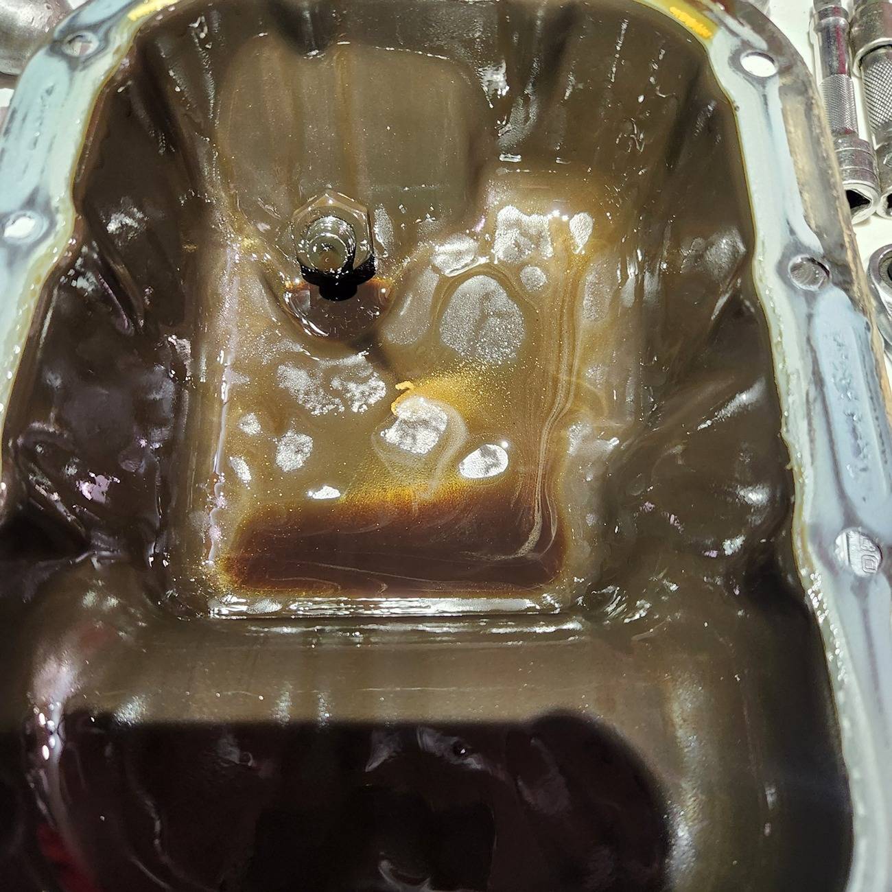

Got the jeep running again.
Pulled the sub oil pan and cleaned it out.
Changed the filter and oil again. Used the cheap 5w30 synthetic walmart sells to flush out the metal and the engine runs more quiet than it ever has. Never using 0w20 again.
