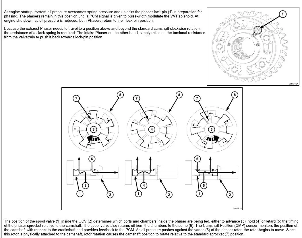

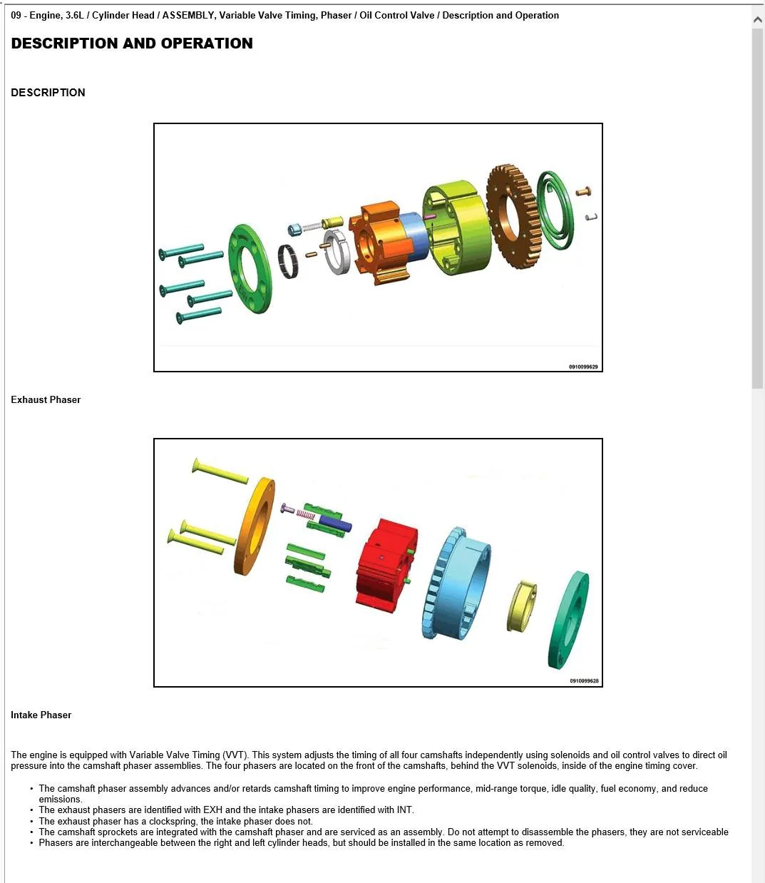

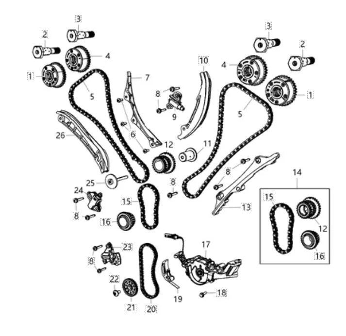

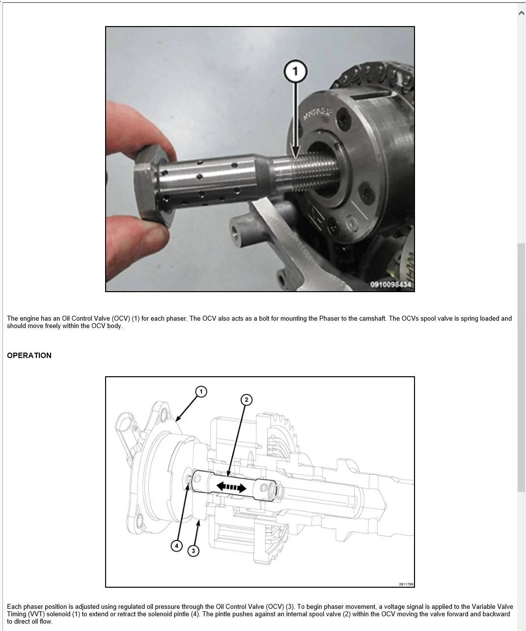

The VVT is an electronically (engine computer) controlled system that uses electrical solenoids to controll the flow of the filtered oil pressure to actuate the cam phasers.
Jeep Wrangler JL Failing rocker arms? cam timing
Jeep Wrangler JL Failing rocker arms? VVT 3.6 1
Jeep Wrangler JL Failing rocker arms? VVT 3.6 2
Jeep Wrangler JL Failing rocker arms? VVT 3.6 3
mwilk012
Mar 10, 2018
11,039
11,404
Oklahoma
2018 Ocean Blue JLU Rubicon
Service
In other words, no it is not easy to diagnose or repair. It’s a motherfucker.

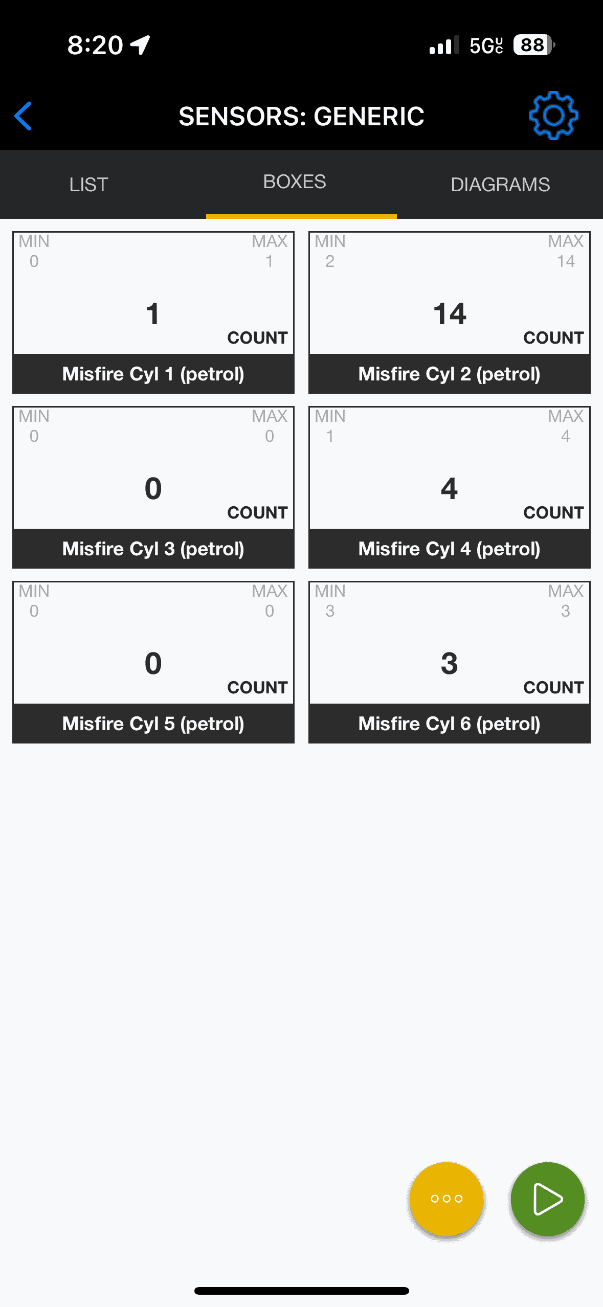

I ran JScan this morning on a trip to store and back looking for misfires. Pretty clear most the misfires came during the cold start/ warm up .
Jeep Wrangler JL Failing rocker arms? IMG_5329
Jeep Wrangler JL Failing rocker arms? IMG_5330
mwilk012
Mar 10, 2018
11,039
11,404
Oklahoma
Service
You have a whole bank going out. Something is wrong on that side.
