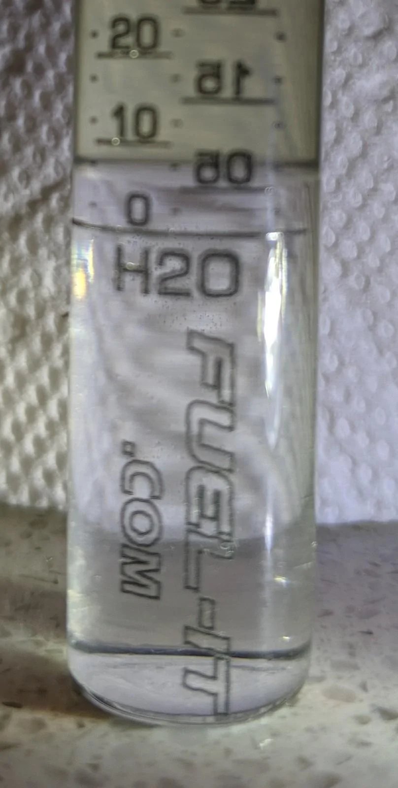

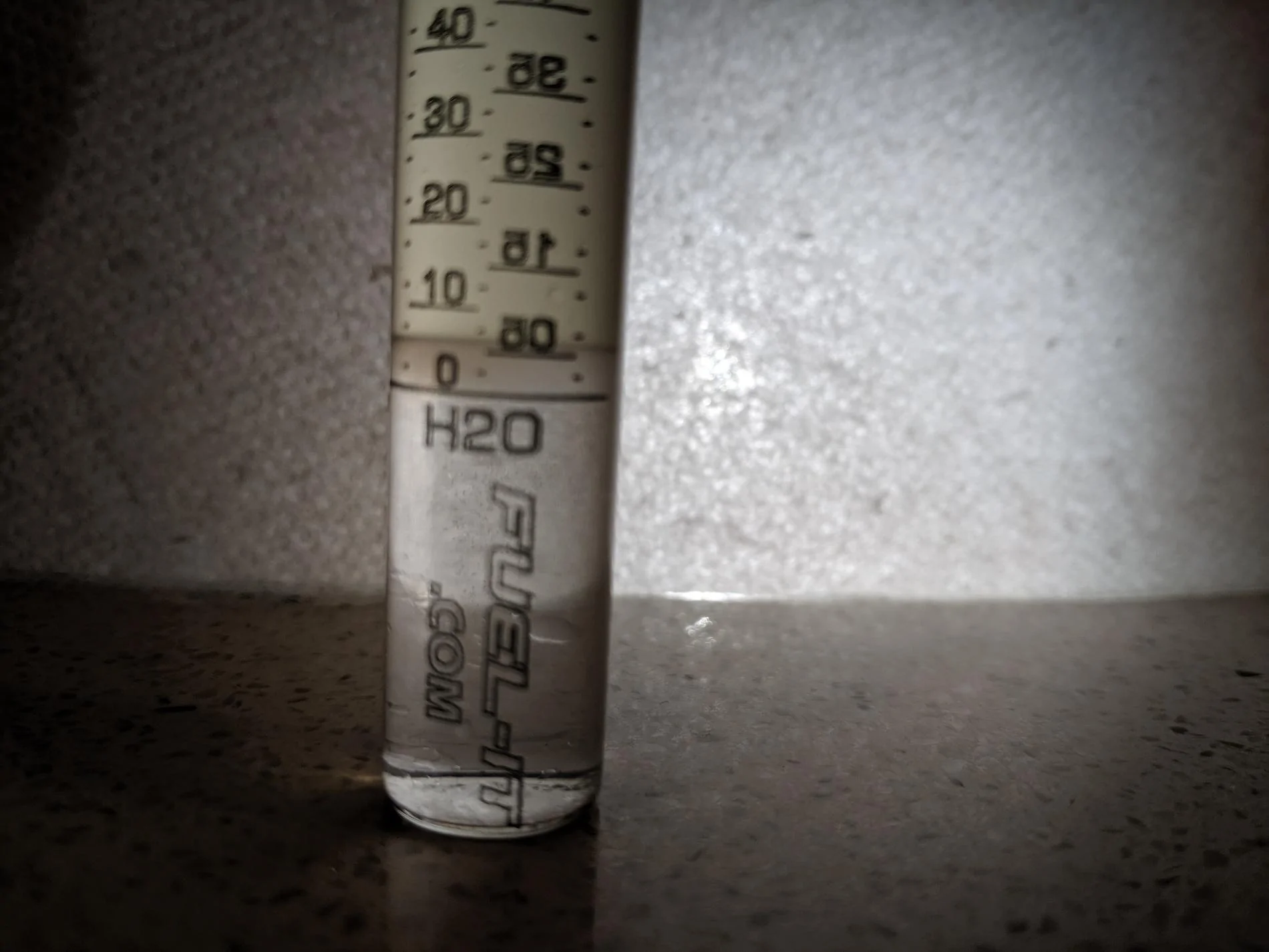

The bubbles in the Sunoco sample are now gone. I'd say 7 to 8% ethanol. Certainly there is more than we saw with the Shell regular 87. I'll call it close to 7.5% vs. approximately 6% for Shell. give or take 0.5%.
For closer comparison, see for yourself. The Sunoco is first, followed by the Shell. It is close, but for certain there is more ethanol in the Sunoco gas. Both started out with the exact same amount of water and fuel, as measured by the laser etched lines on the tube.

I ran a second test after thoroughly cleaning the test tube (it was clean before) and rinsing it with the Sunoco gas and saw the same result, including the bubbling. It will be interesting to see if any other brands do that, as well, and if they do, which others don't.

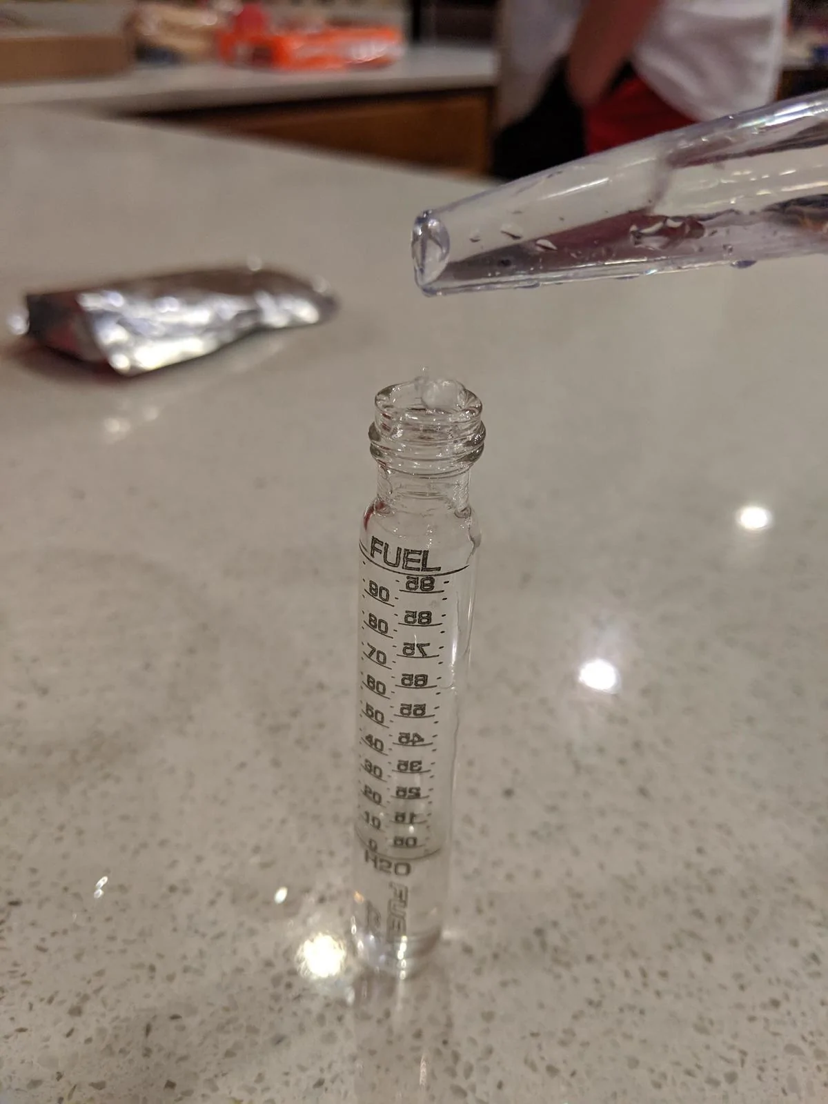

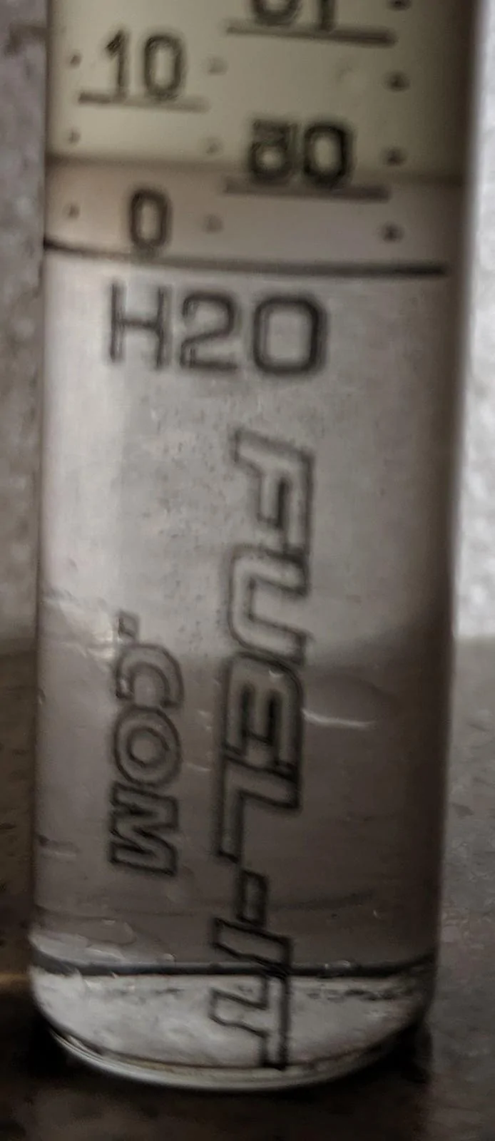

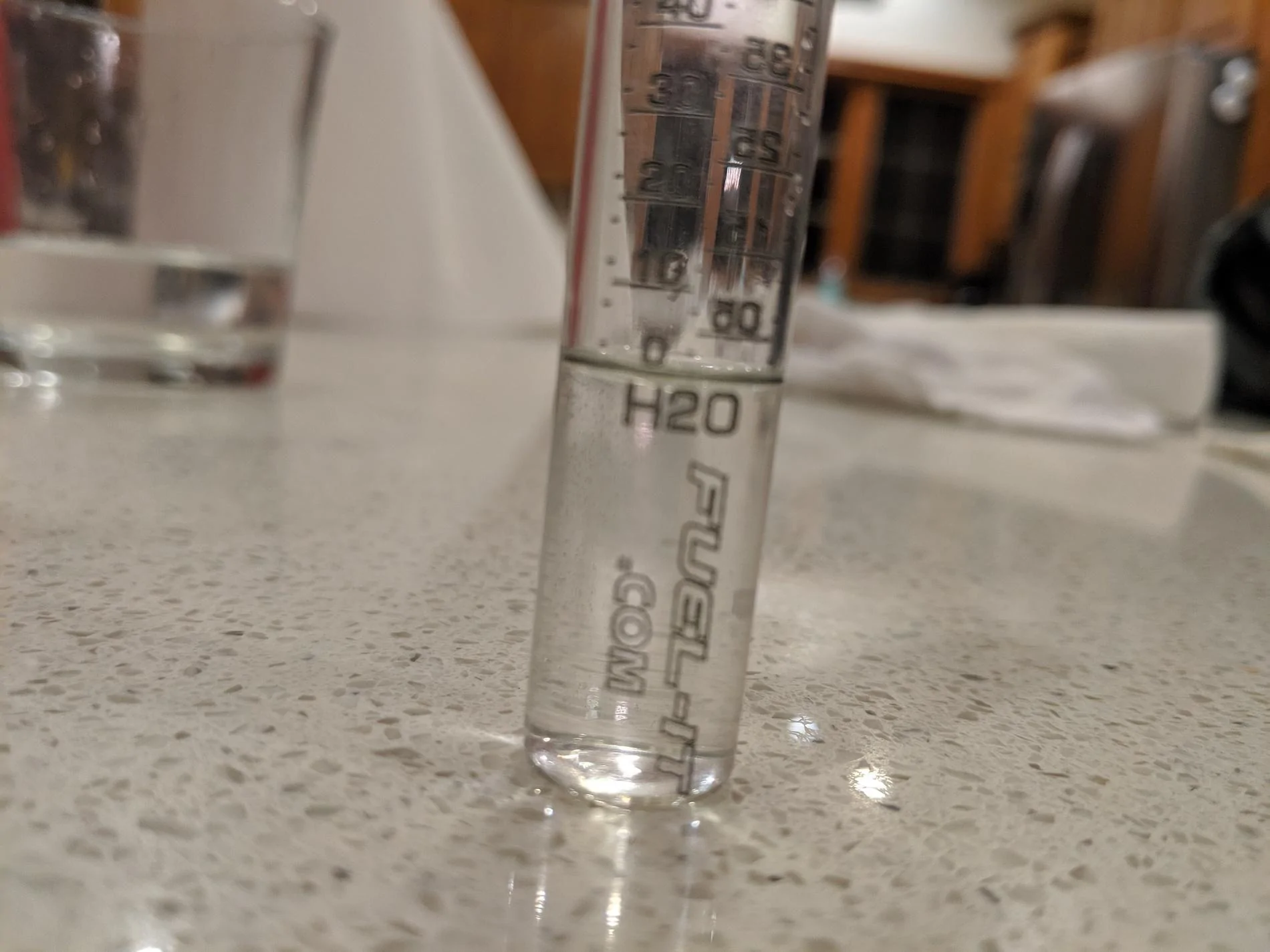

In the Top Tier fuel thread, I mentioned I would get an ethanol test kit. Well, it came, so I filled a gas can with some Shell regular 87 octane gas and tested it tonight.
I had heard that it is now typical for fuel not to have the advertised level of ethanol in it because gasoline is cheaper. I had even heard of E85 being more like E70, or 70% ethanol instead of the advertised 85%. The funny thing was seeing someone say they felt cheated, not realizing that they were getting the better end of the bargain with more gasoline in the mix, which has more btu's, and thus, more power and fuel economy.
Anyway, I tested the Shell gas from a station that I frequent about 30% of the time when I fill up my Jeeps. I chose it over the one I use mostly because prices rose today and this station was $2.37 per gallon while my favorite was at $2.69.
So, I first put water up to the water fill line...
I then filled it precisely to the proper line with the Shell gasoline, shook it up, and then let it sit for a few minutes. The water mixes with the ethanol, and then the gasoline floats on top of it. The raised level can then be read as a percentage. Of course you have to really eyeball it.
As you can see, it is well below 10%, which is a very good thing. I'll call it 6%. That really makes it hard to justify seeking out and paying more for ethanol free gas. It also might explain why my JK 3.8 runs a little better the last year to 18 months, assuming the ethanol content is less.
