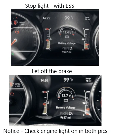

Typical North Texas day - 40 mile drive - AC on full blast.
35 miles into my drive, this happens.
"Stop/Start Unavailable Service Stop/Start System" and my check engine light came on.
Fast forward 5 hours, hop in the Jeep to run an errand, check engine light is off, stop/start functioning again.
I drove 15 minutes earlier tonight, Stop/Start Unavailable... it was a cool 91 at that time.
Currently at the 11-month mark, 9700 miles
