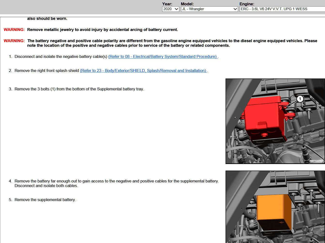

No. The procedure is to come at it from the top...... remove the fuse box and start working down.
this is why I recall want someone to come up with a “dual battery tray kit” that will house the main battery AND the relocated AUX battery right up top where both are easy to get to WHEN replacement is needed.
Actually the factory service manual states to remove it from below, through the inner fender.
@Jelllo
You are correct.. you can get at the Aux from above but..... A lot more to the exchange, going from up above though.. A lot more to screw up, too.
Two of my friends are Techs at dealerships.... they both have done the Aux battery replacement and they do it as per the factory service manual.... from below.
I actually watched one of the techs, change out an Aux battery on a 3.6, JL. Removal and replacement of the Aux., was done as per the info you just posted/factory service manual. The exchange was pretty straight forward.....
That's what I was afraid of. This makes sense to me, than disassembling the battery housing, removing the battery, fuse box, etc...
