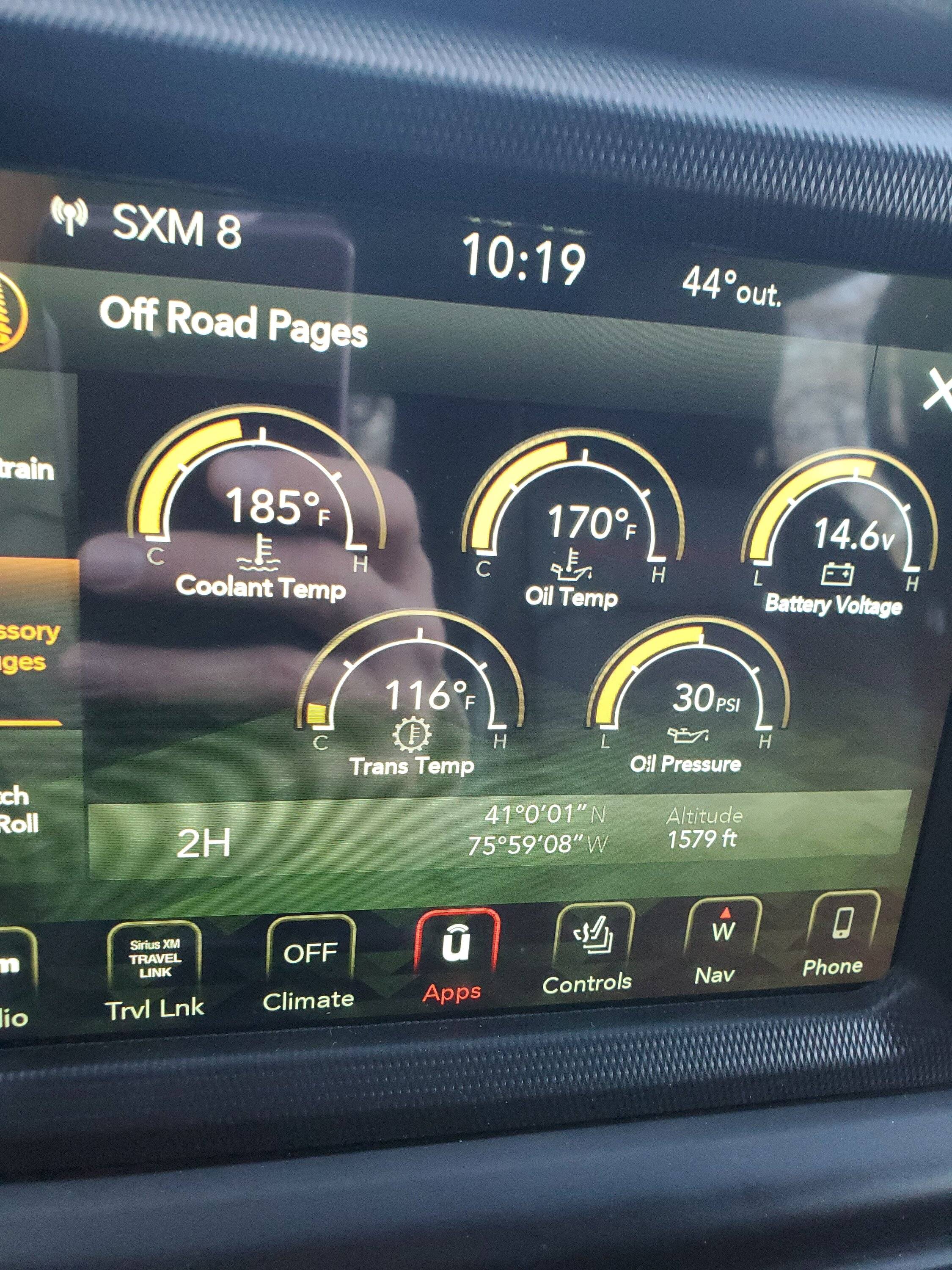

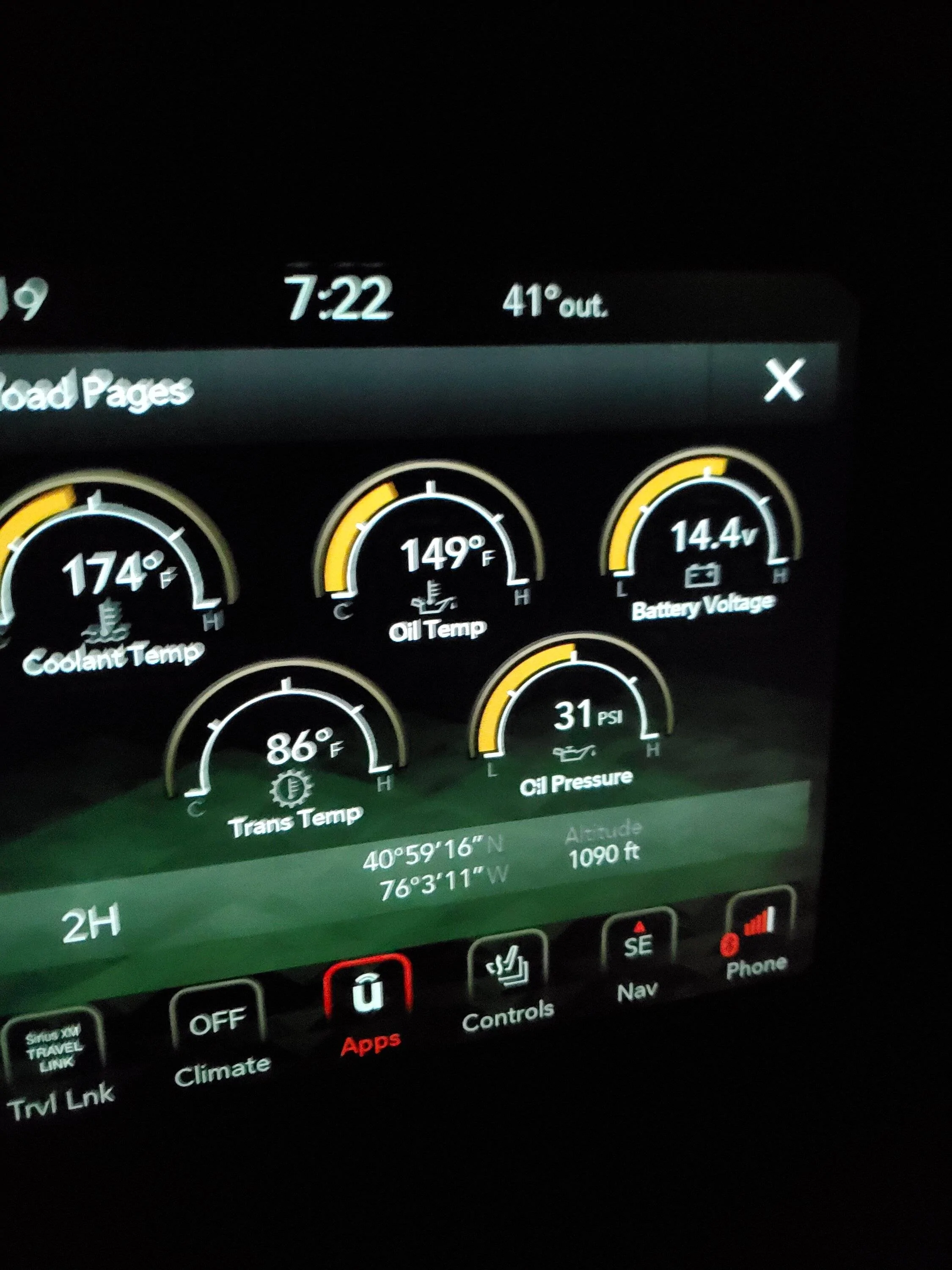

Got in vehicle to drive to work this morning
Dash said start stop ready!
Does voltage look OK?
It stated and stopped fine.
Noticed voltage goes to like 12.5 when it's activated

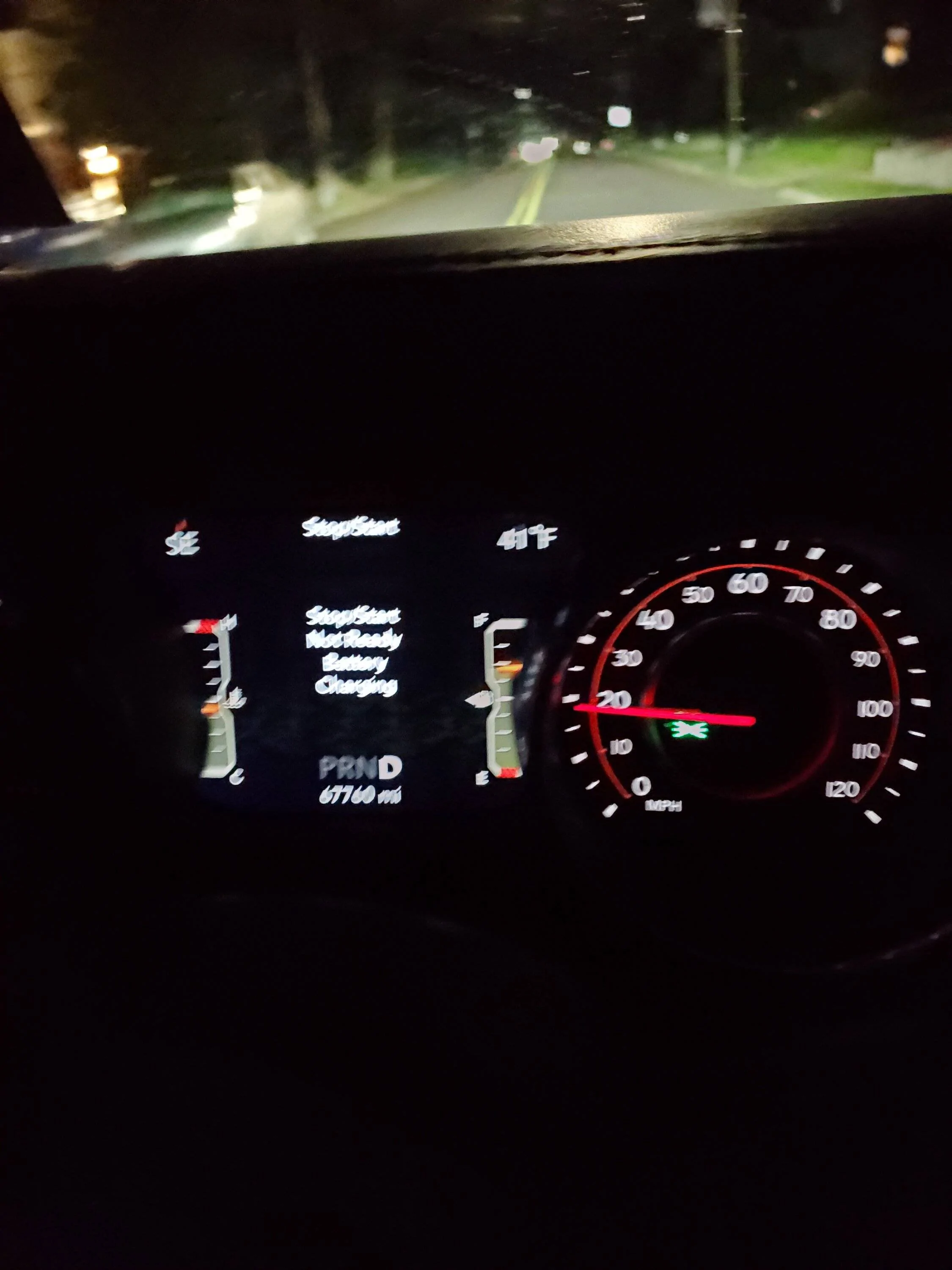

Got In the vehicle to drive home and back to the same old message

Your main battery is probably weak.
Your voltages do NOT look good. Your alternator is charging too high, trying to charge your dead main battery. A fully charged battery should sit at 12.6-12.7 and the alternator will stop charging when it reaches that value.

Hummm..
Earlier today had same voltage and someone said it was fine.... I'm so friggin confused! Lol
My main is only 13 months old..
It shouldn't be going bad already.. or something else is wrong.. this shouldn't be eating batteries like this... do you think?
