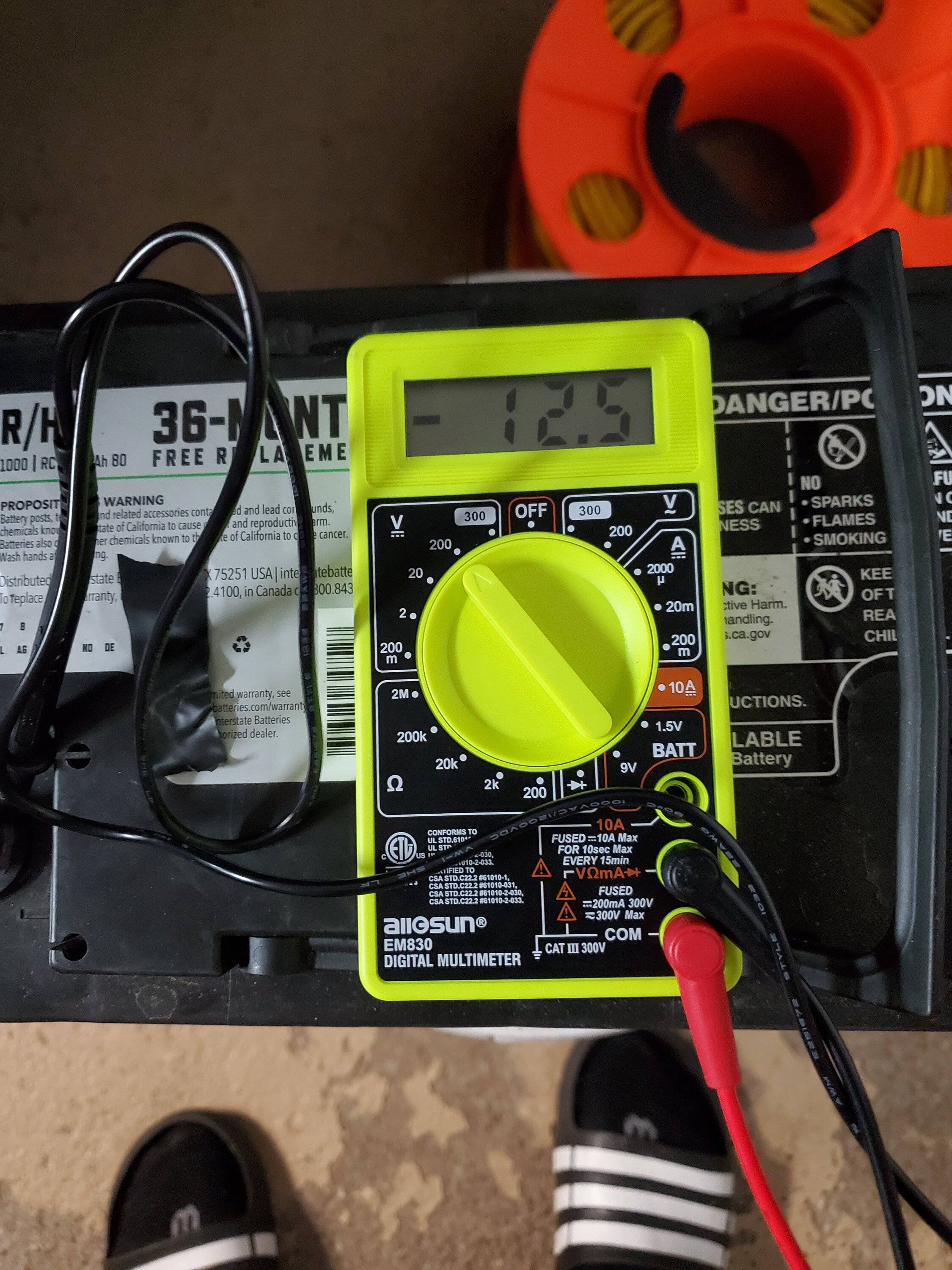

Main is an interstate mtx-94r/h7 and yes I have a volt meter..
Thanks for the help btw
Joeshek
Aug 23, 2022
Hazle Township
2018 rubicon
Here is the battery
And here is the voltmeter reading
Jeep Wrangler JL Ess battery change 20221108_210554
Joeshek
Aug 23, 2022
Hazle Township
2018 rubicon
And the genius charger on it
So what is the problem?

Bad aux battery phlucked your main. Now your bad main will phluck your new aux. Ain't life grand?

12.6 and above is a full charge " HEALTHY" "resting" voltage battery
at least it says 36 month replacement lol
elf883
steven
Sep 21, 2019
447
474
NY
2024 jlu willys anvil
stationary engineer
Yea, except they’ll test it and it will pass.
yep correct
12.5 is healthy will show good
but it will also be required for you to check it in a few days to see if it holds that voltage. any change just resting and its junk . i had these issues with my 2 year old mopar junky battery from the dealer ,changed the battery have not had issues .

Slow charge that battery. If it won’t rest at 12.7, it’s no good.

Joe: While it is possible that other things may be causing your issues, we need to rule out it being the batteries, and to do so we need to independently load test each battery.
Load testers, unlike your multimeter,, which measure instantaneous voltage, measure a battery's ability to do that which it's designed to do: which is accept and delivery charge.
Ask the dealer to independently load test each battery. Once your batteries are either ruled out or not the issue, or hopefully at most, just the relatively new main battery needs to be replaced, either your problems will go away, or we can know that it isn't the batteries that lie at the crux of the problem.
