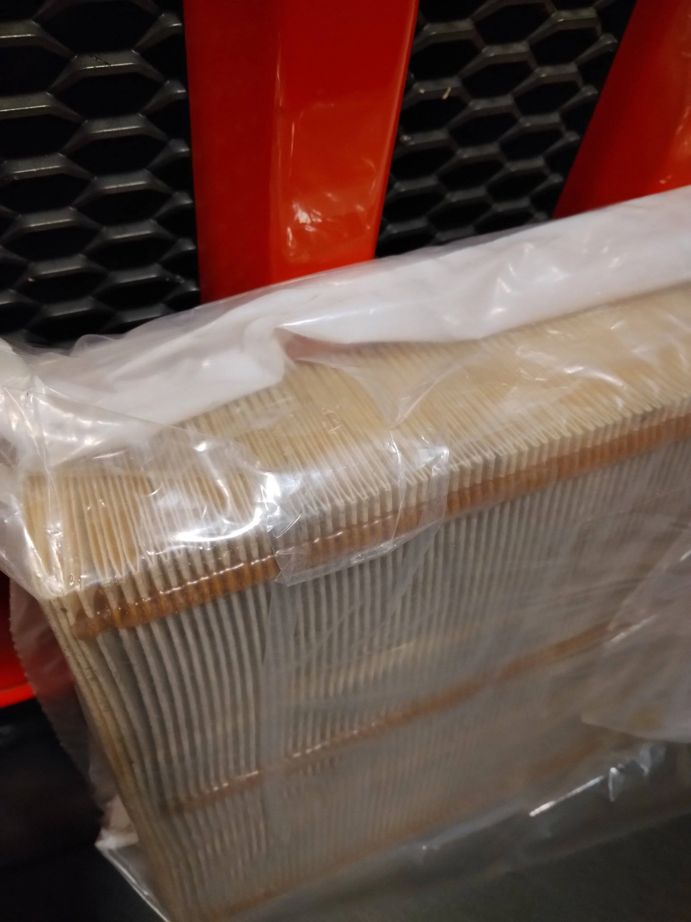

How often is it replaced?
I just had an oil change and had the dealer replace it at 16k miles.
I replaced the original OEM filter at 30K, per the prescribed interval noted in the Owner's Manual. The filter has obvious service life remaining, so I put it aside as an emergency spare.
