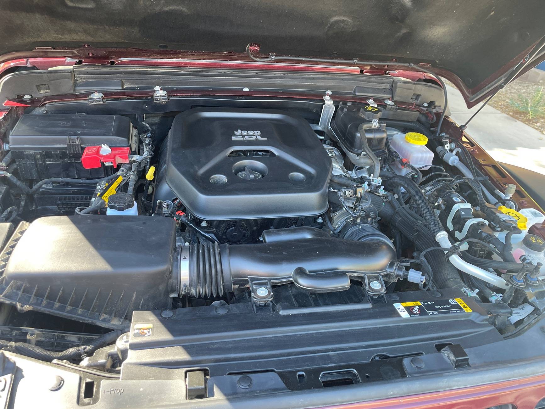

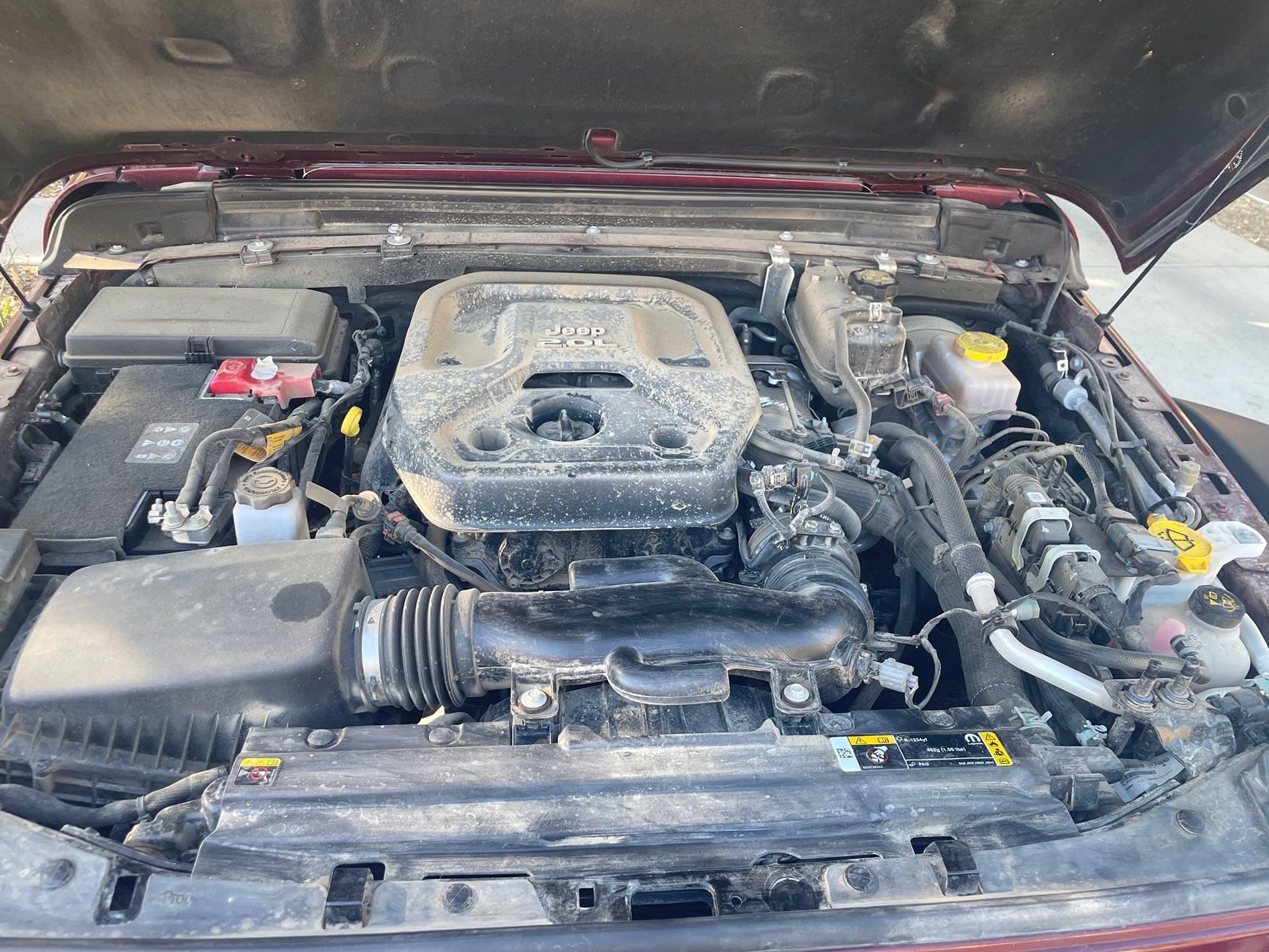

I live in a dusty area also. This is one off road trip dust results photo. I went back to stock filters. I have used K&N many times in past. I could see the dust in throttle body after the K&N filter so it’s definitely getting thru to the engine.
K&N is great for more hp because of better airflow but the cost is dirty air can
get thru. Toys and racing applications get K&N. My street vehicles get stock air filters for me.
Before run

After
Jeep Wrangler JL K&N Air Filter IMG_0975
Before run
After
IMO you need a tractor air cleaner not stock for that type of off roading.
