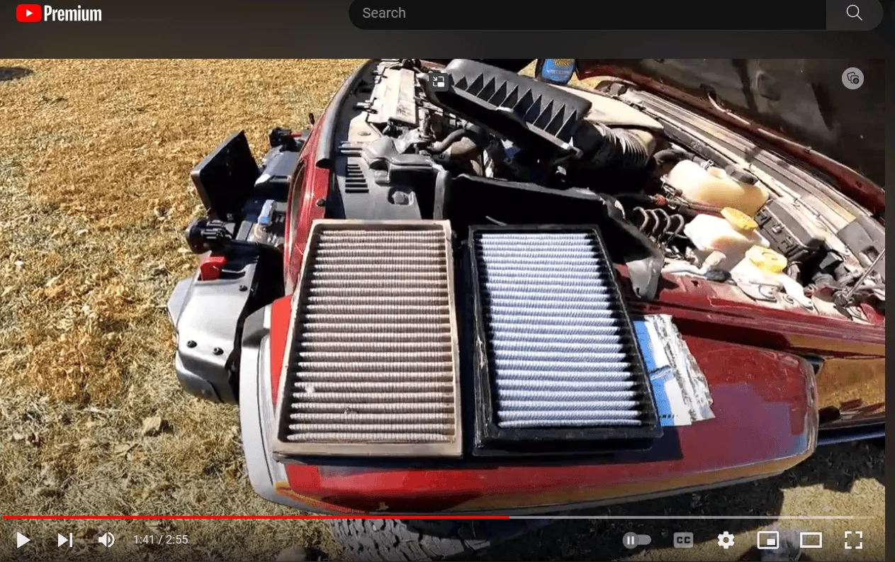

I live (and tend to wheel) in a very dusty environ. At the 1st video below, you can see how dirty my factory filter got at less than 10K. (In the static pic below that, you can see how dirty the new filter got after a trip).
I switched out to cleanable, DRY filters. I now have 2 of them. This lets me swap out after a long dusty trip, so I have a clean filter for the hundreds of miles trip back home.
In the last vid you can see how easy it is to change the filters yourself.
Jeep Wrangler JL Engine air filter - how often to replace? 1681993539143
At the following link you can see how easy it is to change.

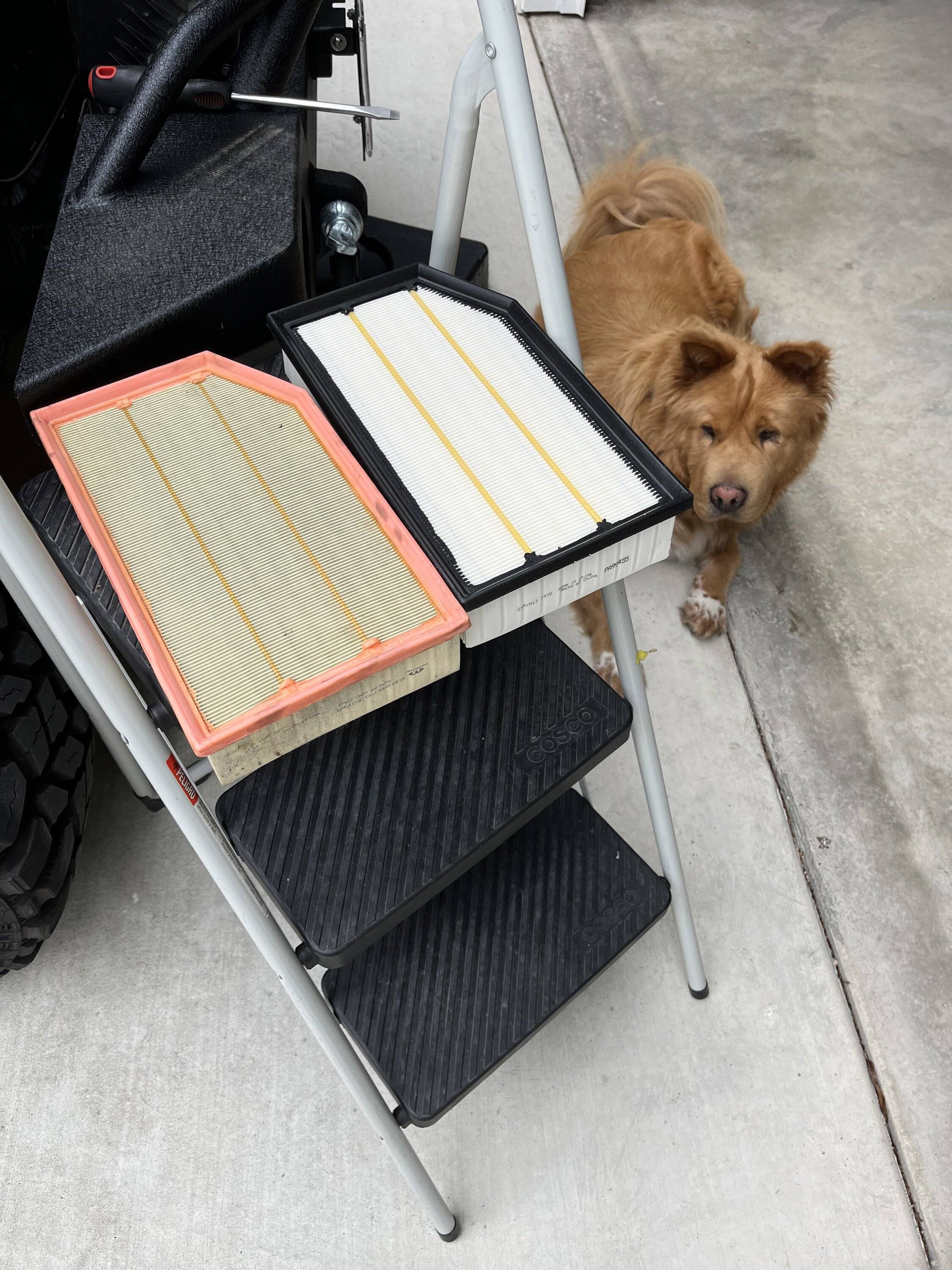

This is at 20k.
Jeep Wrangler JL Engine air filter - how often to replace? IMG_3223
