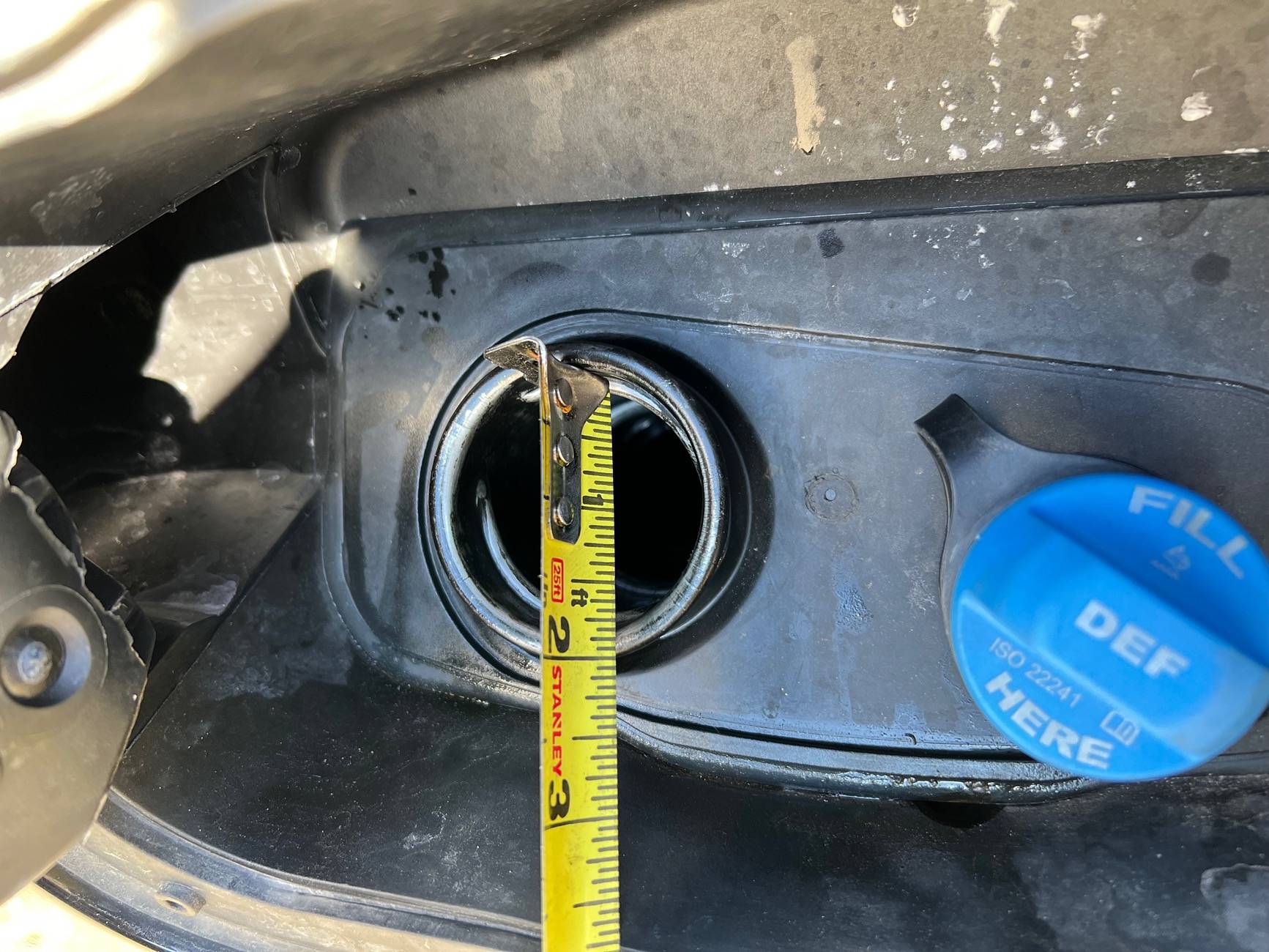

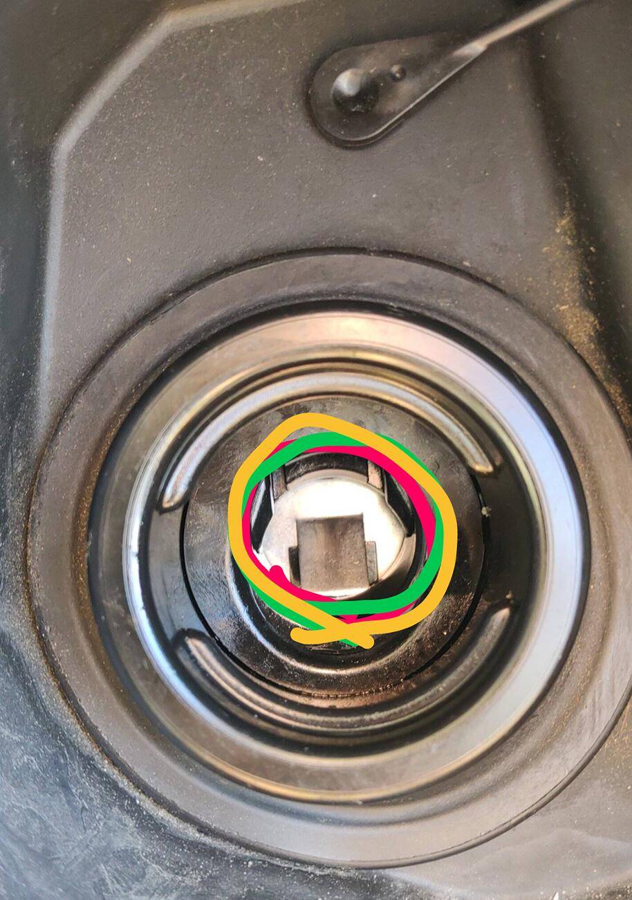

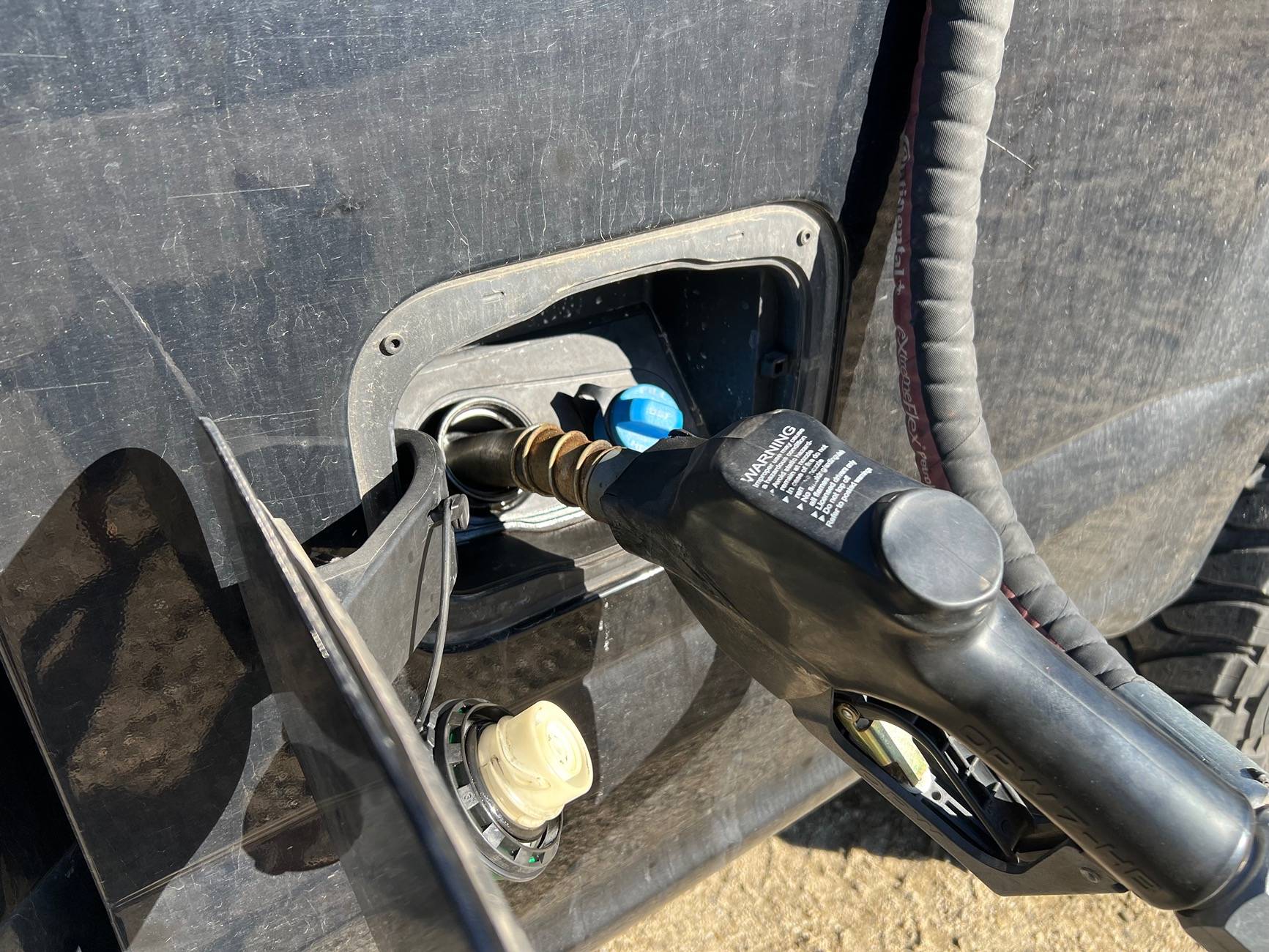

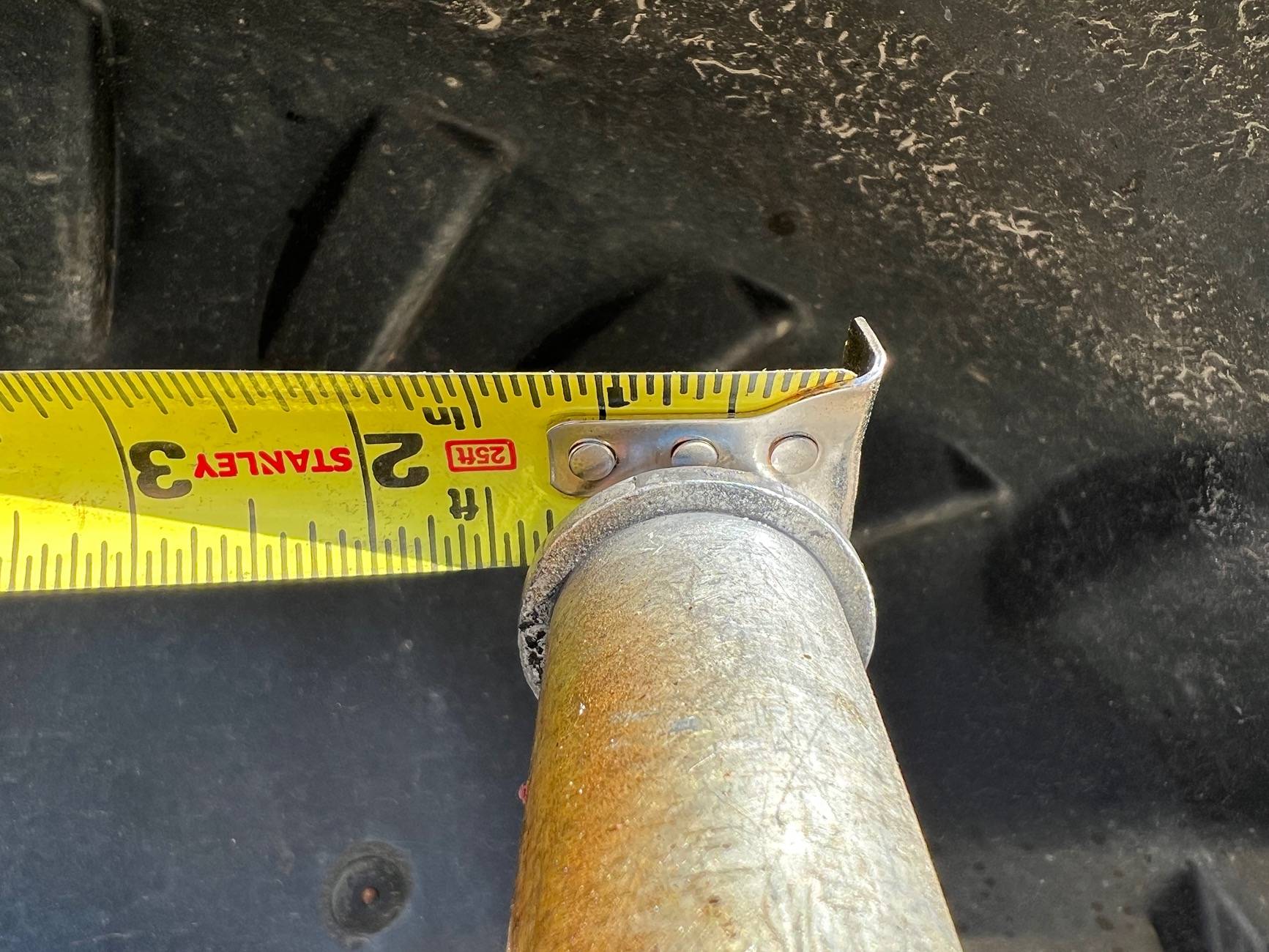

Where is this method talked about? I have read some of the other ones and they seem to have you removing the whole fill tube from the Jeep from under the fender.
It would be nice to get rid of it. I have been taking note of what pumps have the larger nozzle, but usually one side of the pump is standard and the other is the large.
Here is what I saw:

Jeep Wrangler JL Engine 3.0: Fuel Cap Error IMG_5734
Jeep Wrangler JL Engine 3.0: Fuel Cap Error IMG_5730
Jeep Wrangler JL Engine 3.0: Fuel Cap Error IMG_5732
Jeep Wrangler JL Engine 3.0: Fuel Cap Error IMG_5733
