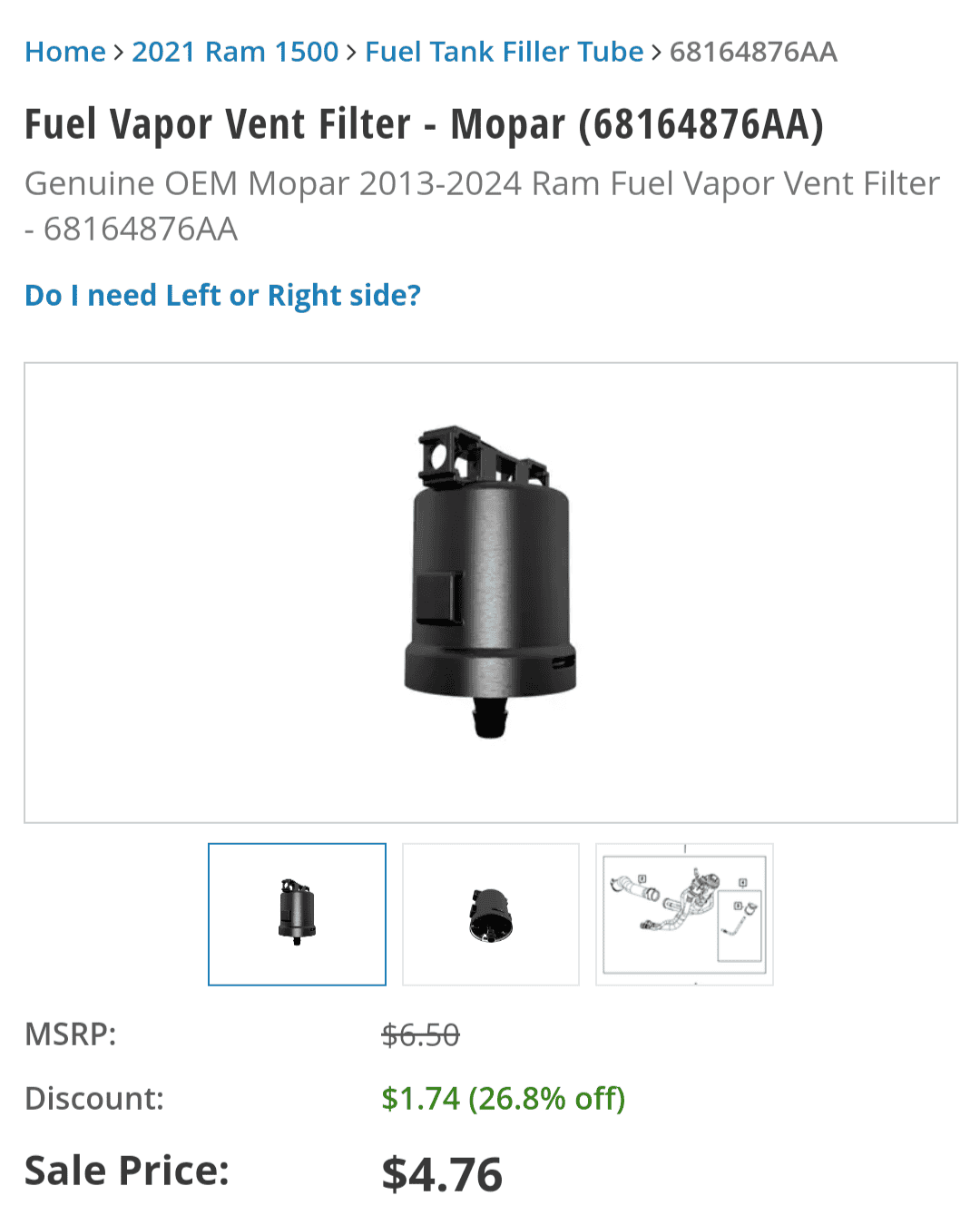

I know the Ram 1500 EcoDiesels have a fuel tank vent...

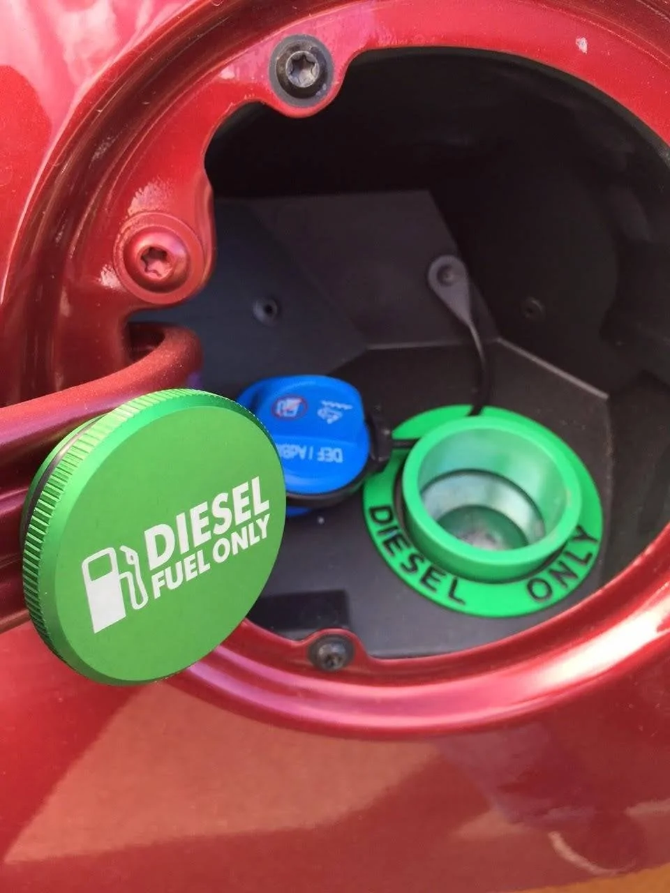

They also have a capless fuel system...
Jeep Wrangler JL Are OEM 3.0 Fuel Caps Vented? image (1)

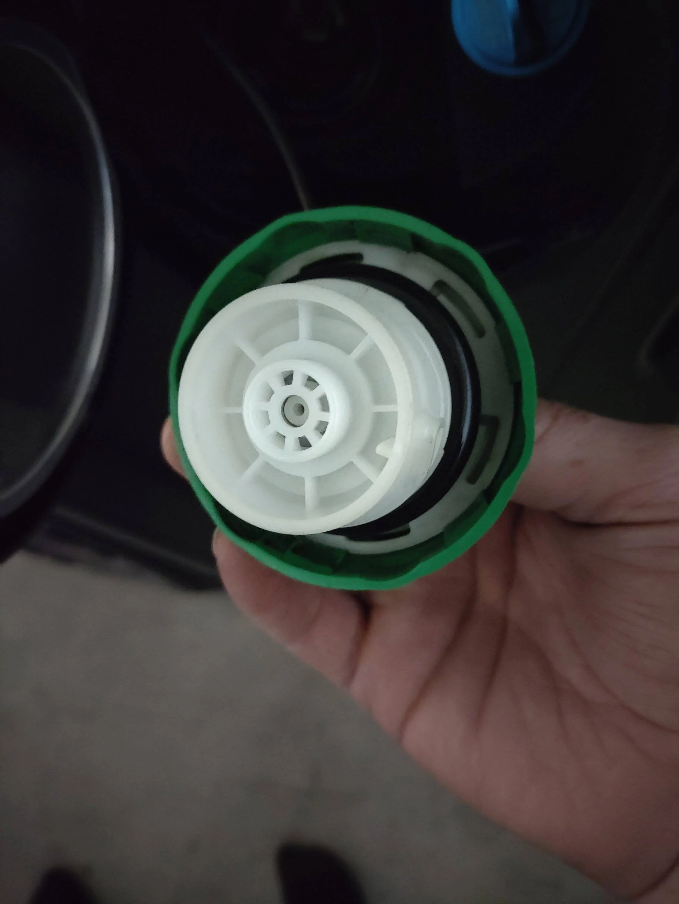

But then when I look at my fuel cap, it looks like it's vented...
Jeep Wrangler JL Are OEM 3.0 Fuel Caps Vented? IMG_20240204_162522775
Thoughts?? ?‍♂

Should be sealed but have a combined over and under pressure relief value.
Yeah but is the vent tube and filter the relief valve like it is on the Ram 1500 EcoDiesels? Or is the Wrangler EcoDiesel different and the fuel cap functions as the relief valve?
