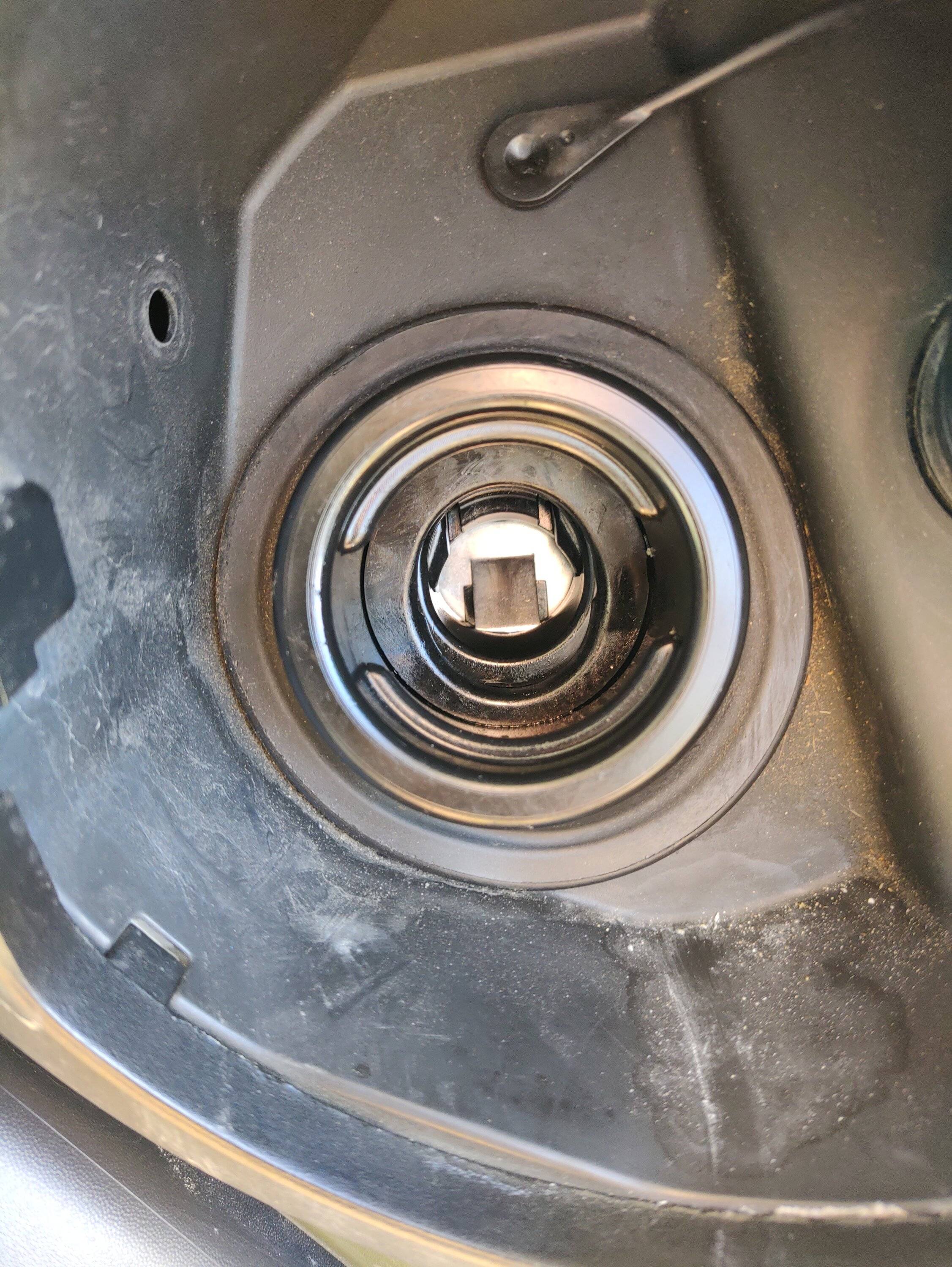

Without going into the why, I've been driving for 20 mi now, two different trips without a diesel fuel cap on my Wrangler.
Jeep Wrangler JL Engine 3.0: Fuel Cap Error IMG_20240222_164109
Jeep Wrangler JL Engine 3.0: Fuel Cap Error IMG_20240222_163033
So yeah 20 miles in, and I've still not gotten any check engine light or codes thrown...
Jeep Wrangler JL Engine 3.0: Fuel Cap Error IMG_20240222_163041
Has any of my fellow EcoDiesel owners ever gotten a code thrown for the fuel cap not being tight enough or loose?
I'm starting to get the feeling the cap is literally just there for debris protection.

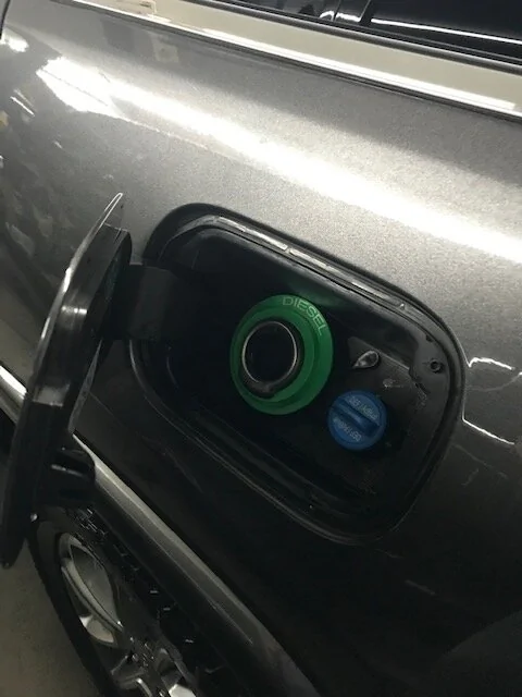

Just another bit of info...Older EcoDiesel in Grand Cherokee’s never came
Jeep Wrangler JL Engine 3.0: Fuel Cap Error IMG_7521
with a cap just a door for protection.

Well there you go, 100 mi with no fuel cap on the filler neck and zero issues. No codes, no lights, no nothing.
It's almost like it's a capless system like the Gen 2 and 3 1500 EcoDiesels have except it just happens to have a cap on it.
This definitely opens up my options for my goal to make my Wrangler into a capless fuel system. It basically already is one, now I just need to find a cap that works to protect the neck from debris only.
I have some ideas, but it really comes down to the 62 mm width of the filler neck. :)
