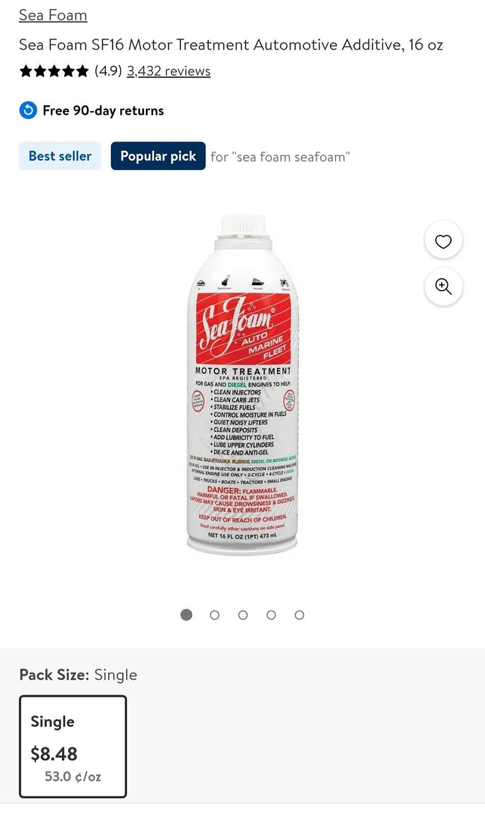

I ended up shelving the AmSoil Engine Flush and will use that in the wife's Subarus oil change in the next 3,000 mi. Her vehicle has 62,000 mi on it right now and I don't take as good care of her vehicle as I do my own. Probably just because I don't drive it everyday. So maybe my guilty conscience is thinking I should use the more expensive stuff in her vehicle. 🤔
I ended up putting seafoam into mine.
Jeep Wrangler JL 3.0 engine flush? Screenshot_20240616-160038-186
If you look at the directions in the back for crankcase oil, it says 1 oz per every quart of oil. It also says you should put another 100 to 300 mi on the vehicle before you change the oil, But everything I've read online says that's a terrible idea. So I opted too just idle my Wrangler for 10 minutes after dumping probably close to 10 oz into it. I didn't really measure I just kind of guessed what was 9 oz.

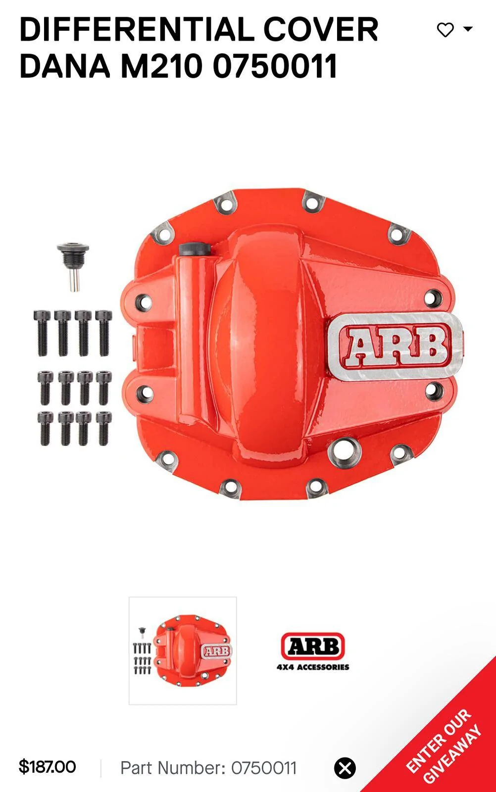

I was looking at this guy for the front differential cover.
Jeep Wrangler JL 3.0 engine flush? Screenshot_20240617-123816-615
$187 is a really good deal for the whole cover and already powder coated too!!

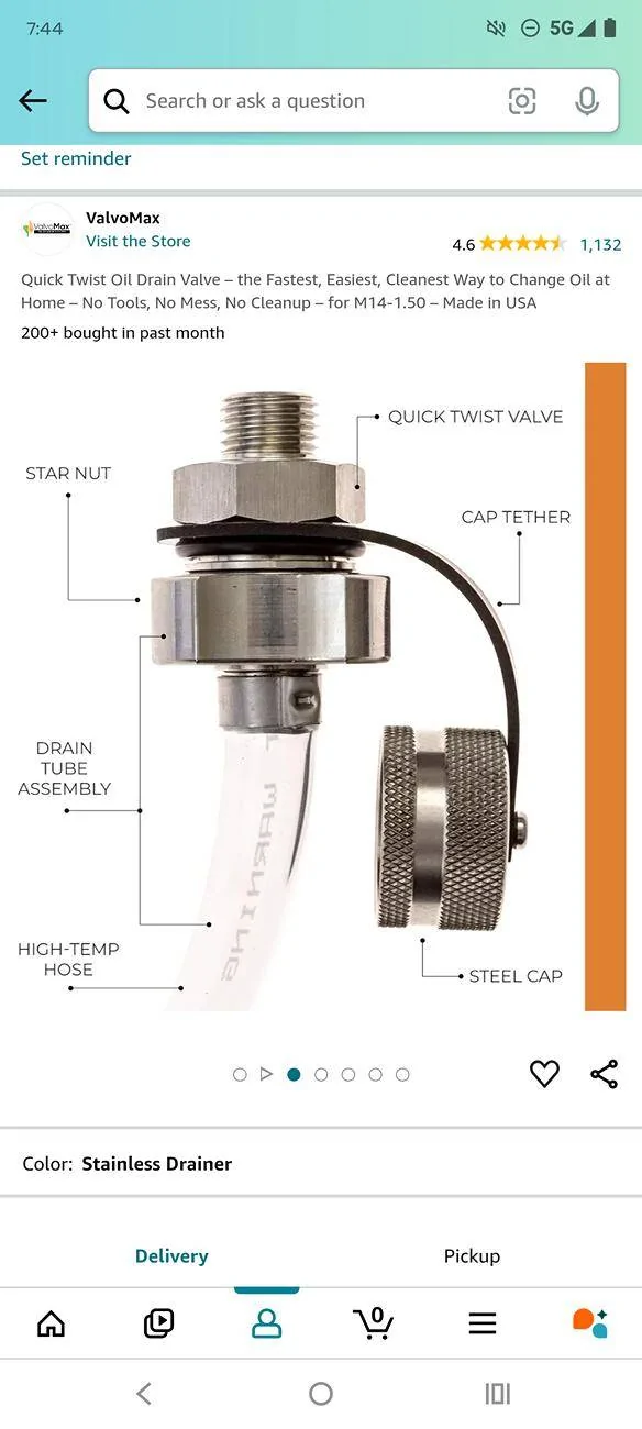

Do you have a picture of this tube connection point... Is it a valve that replaces the drain plug? I had seen those on the web and thought... Well that would suck if I hit on something while doing some fun stuff lol.
Deleted User 38384
Aug 4, 2020
140
6,081
10,672
Jeep Wrangler JL 3.0 engine flush? 1000000620
https://a.co/d/0bCgg3ud
A couple ppl on here have the same concern, but if you're like me and have no engine skid plate, you avoid dragging that area of your undercarriage on any rocks already.
Until you get an engine skid, I wouldn't rick any rocks in that area myself.
That being said, mine has held up well and I haven't torn it off.
It's not as exposed as one may think. The oil pan is already tucked pretty far out of the way. You'd really need to be aiming for it to hit a rock on it. Going straight over an edge would hit your rock rails, not your oil pan nor this drain plug.
I'll grab you some photos of what I mean here in a little bit.

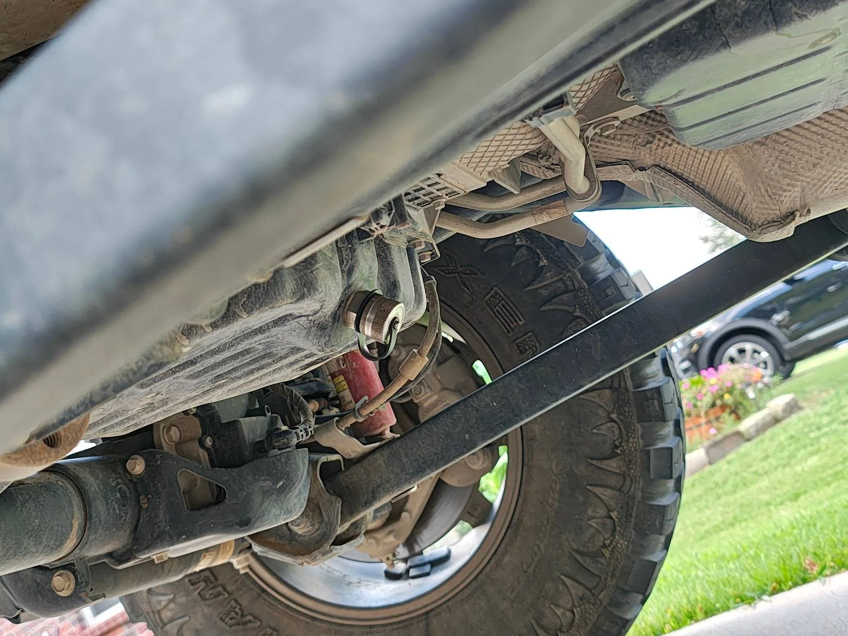

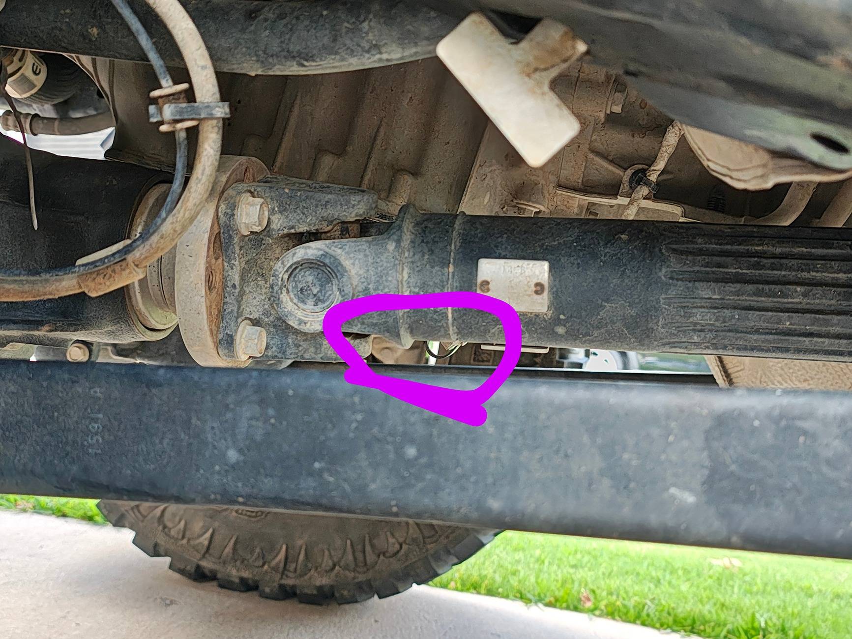

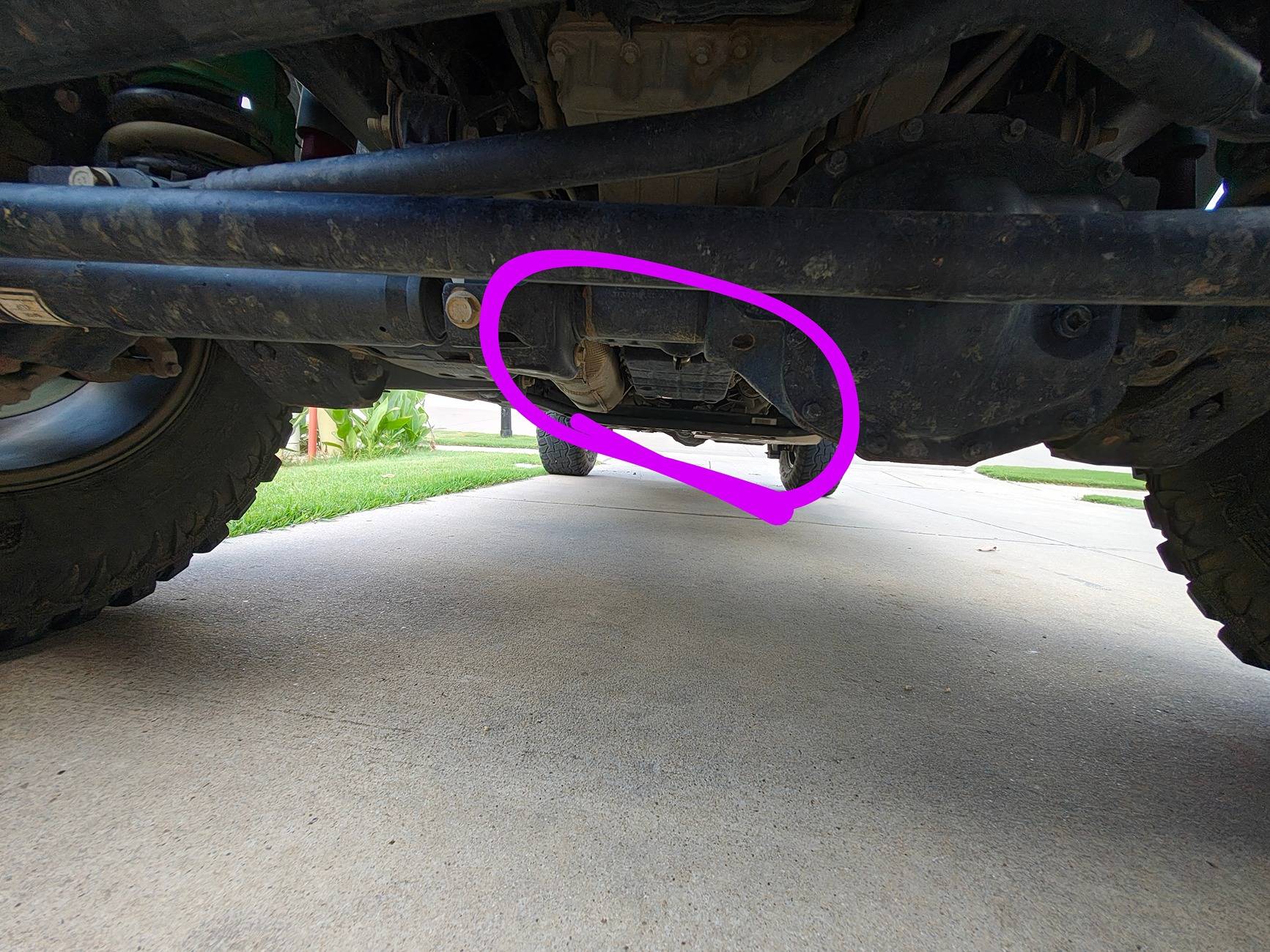

@Neutrino
Jeep Wrangler JL 3.0 engine flush? 1000000623
Jeep Wrangler JL 3.0 engine flush? 1000000631
Jeep Wrangler JL 3.0 engine flush? 1000000626
Jeep Wrangler JL 3.0 engine flush? 1000000627
Jeep Wrangler JL 3.0 engine flush? 1000000632
Jeep Wrangler JL 3.0 engine flush? 1000000630
Like I said, the oil pan is pretty well tucked away. You really have to be aiming for it to hit it. And as you can see this new drain plug spout doesn't sit low enough that it would really rub on anything, again unless you're purposely dragging the center of the vehicle over a rock, with the high point in the center; which who in their right mind would do that without a skid plate!?
