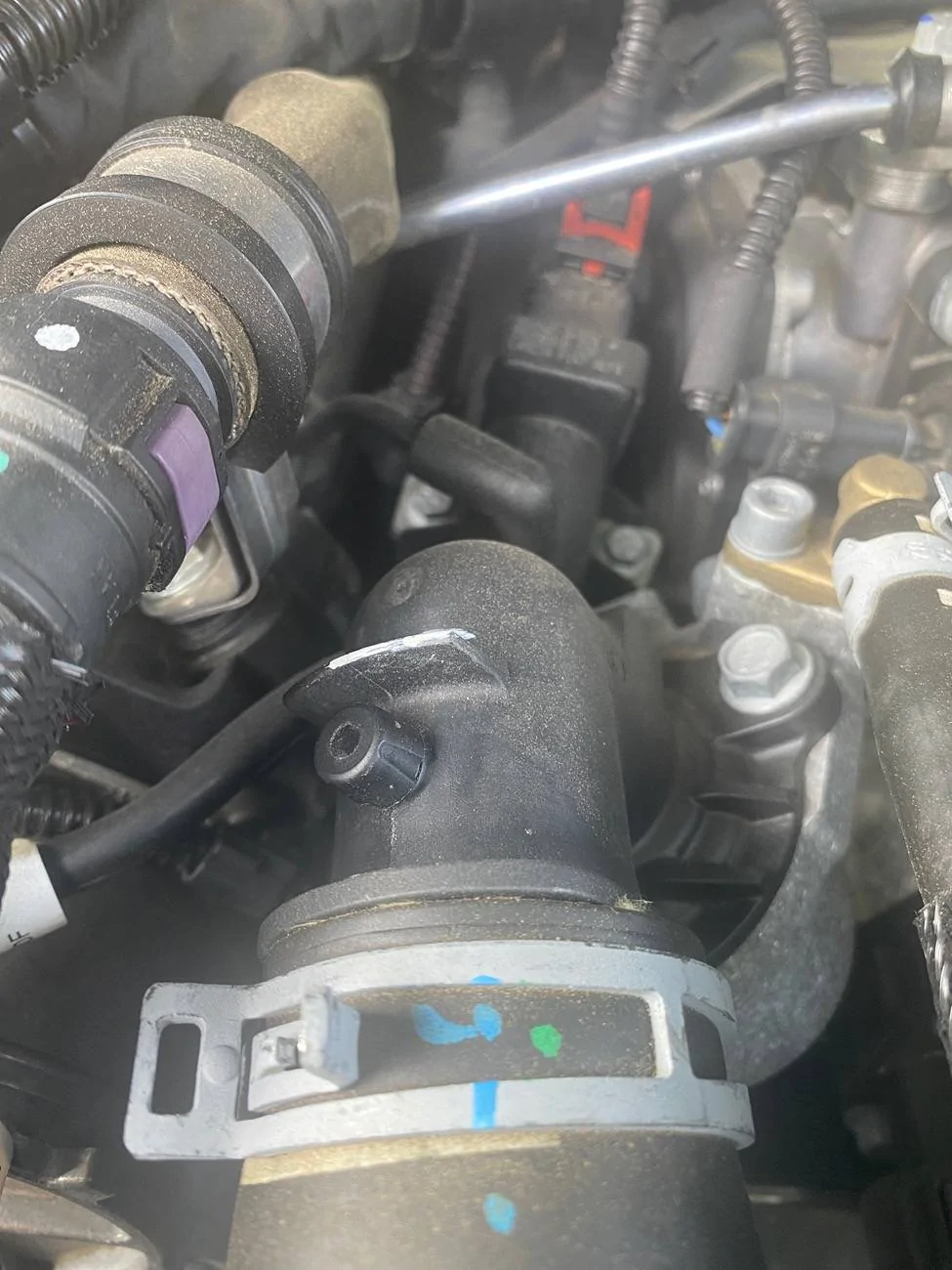

So at this point it seems to all be coolant system related. The noise was coming from the thermostat area. There’s a small bleed valve on top of thermostat housing and I was able to bleed off some air and the noise has stopped for now. I don’t know how air could have got in the system and understand that could be a sign of blow head gasket or something severe but the coolant still looks normal and everything else seems fine. I do wonder about the thermostat though. My coolant temp does seem to be all over the place. It almost seems to be stuck open. It takes forever to get to temp (200 ish) but will drop back down to around 170-180 if sitting at a stop light with ambient air around 75-80. What are you guys seeing for temps? Not sure if this is normal.

Just wanted to provide an update. At this point I’ve probably driven about 120 miles without out any further issues. The cure seemed to be to purge air out of the system at the thermostat. There’s a small bleed off cap to let air out. I’m sure there’s a proper method but I just waited until it was completely warmed up and slowly loosened it being careful not to twist it all the way off. I let the air continue to come out until it was nothing but coolant. The noise stopped after the first bleed but I repeated this the next day as well and was able to get a little more air out. The only thing I can think that may have caused this is immediately restarting the engine after shutdown. It seemed to start when I pulled up to a red light and forgot that I had my Tazer removed and didn’t disable auto start. The Jeep shut off and I immediately disabled auto start stop and it restarted immediately. It was shortly after when I noticed the noise. Not sure if that caused it or not but worth mentioning.

Any chance you can take a pic of this bleeder valve?
