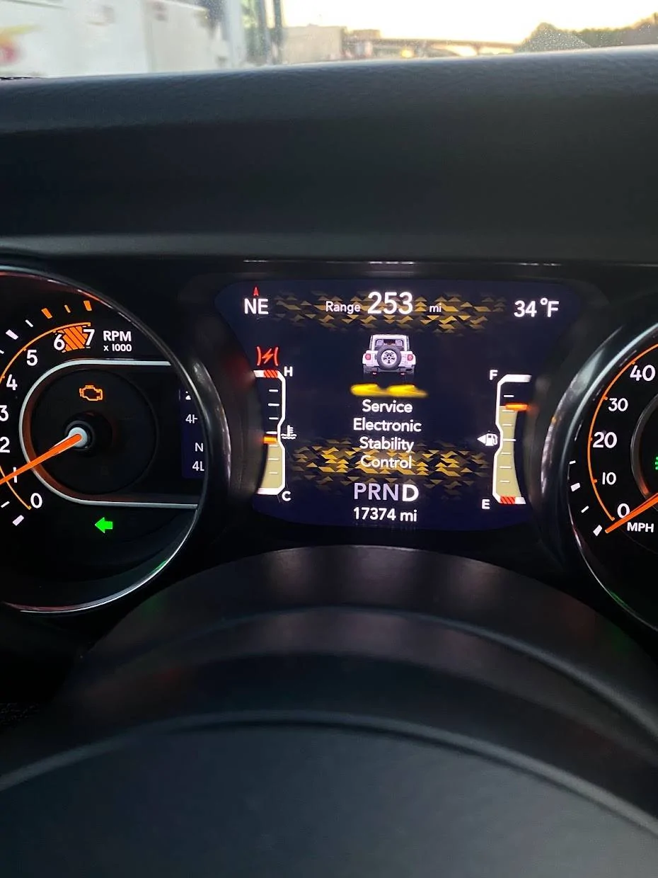

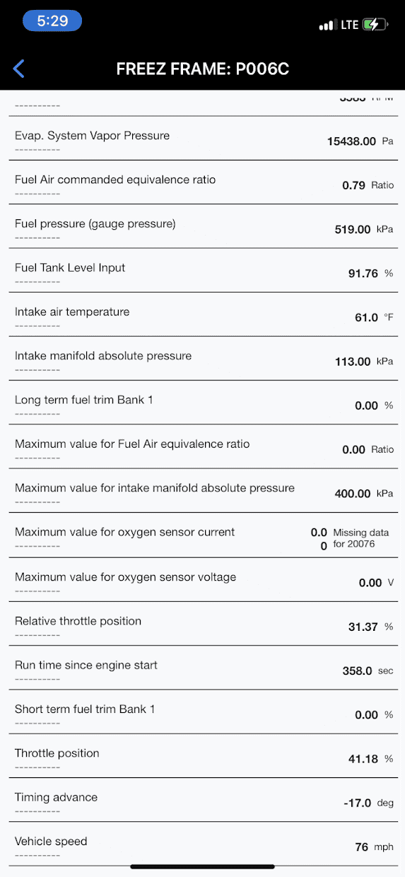

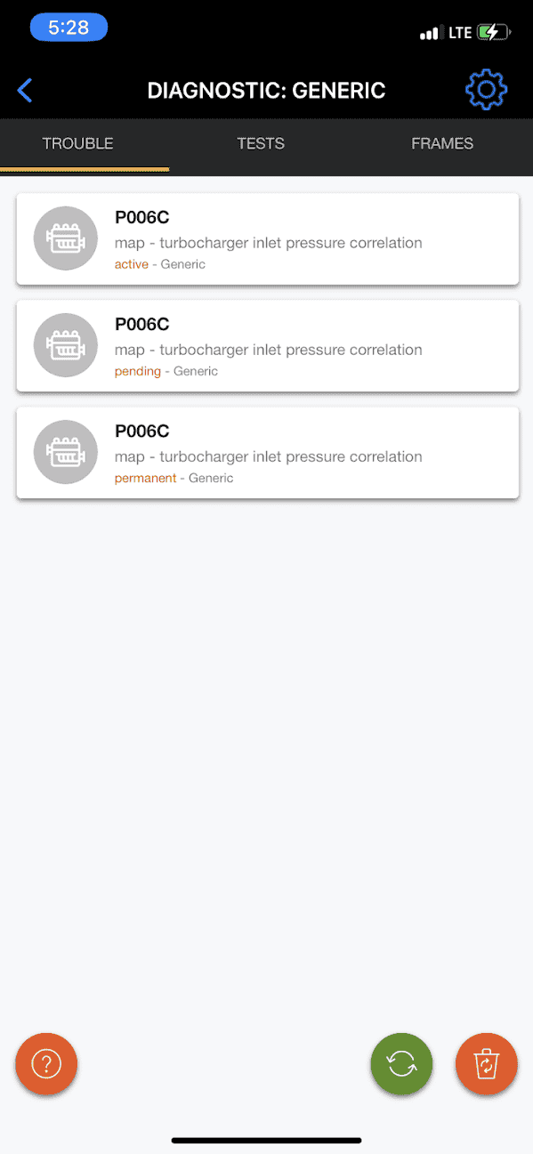

P012C P006C error codes were found. Vehicle goes limp mode. Message on dashboard: "Service electronic throttle / stability control" Issue started after the last oil and alignment service. Sometimes after a few driving cycles the engine check light goes away until it happens again (every 2-7 days) already checked the fuses theyre tight n good. 17.300 miles JLU 2021 2.0l turbo.
Any ideas how to fix it?

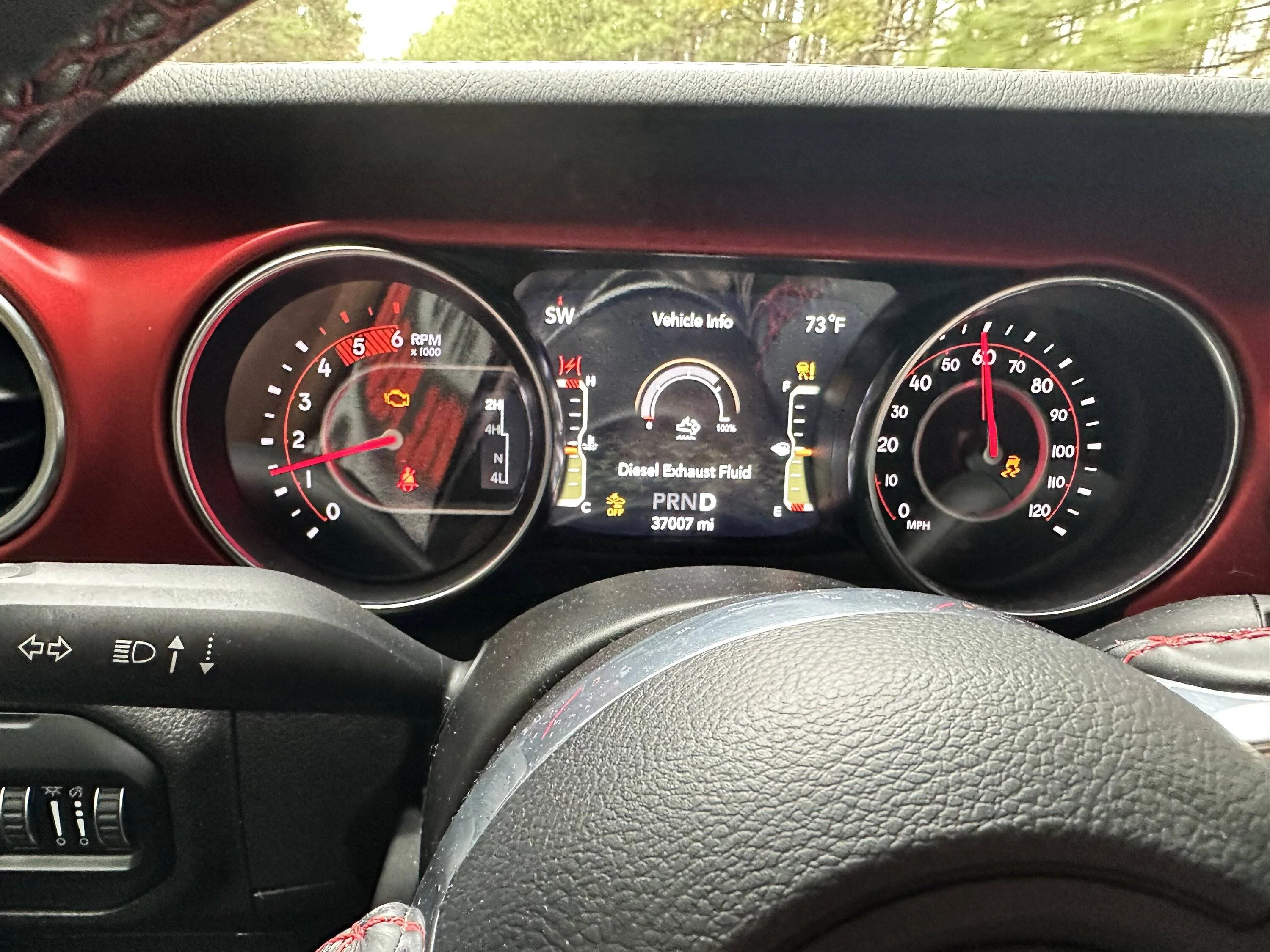

We are having the same problems with our 2021 eco diesel. It’s been going on for over two months now. Every time we take it to the dealership they cannot find anything wrong with it. I will be driving going 60-65 then all of a sudden my engine light came on. A few miles later, the service electronic throttle and serve stability control will appear and with that l can’t accelerate. It’s such a nice a new vehicle to be doing this. The mechanics can’t even seem to find the problem. They just clear the codes and at one point they said it was the k&n air filter that was the problem. After they changed it to a mopar filter, the codes reappeared. Please help!!!
