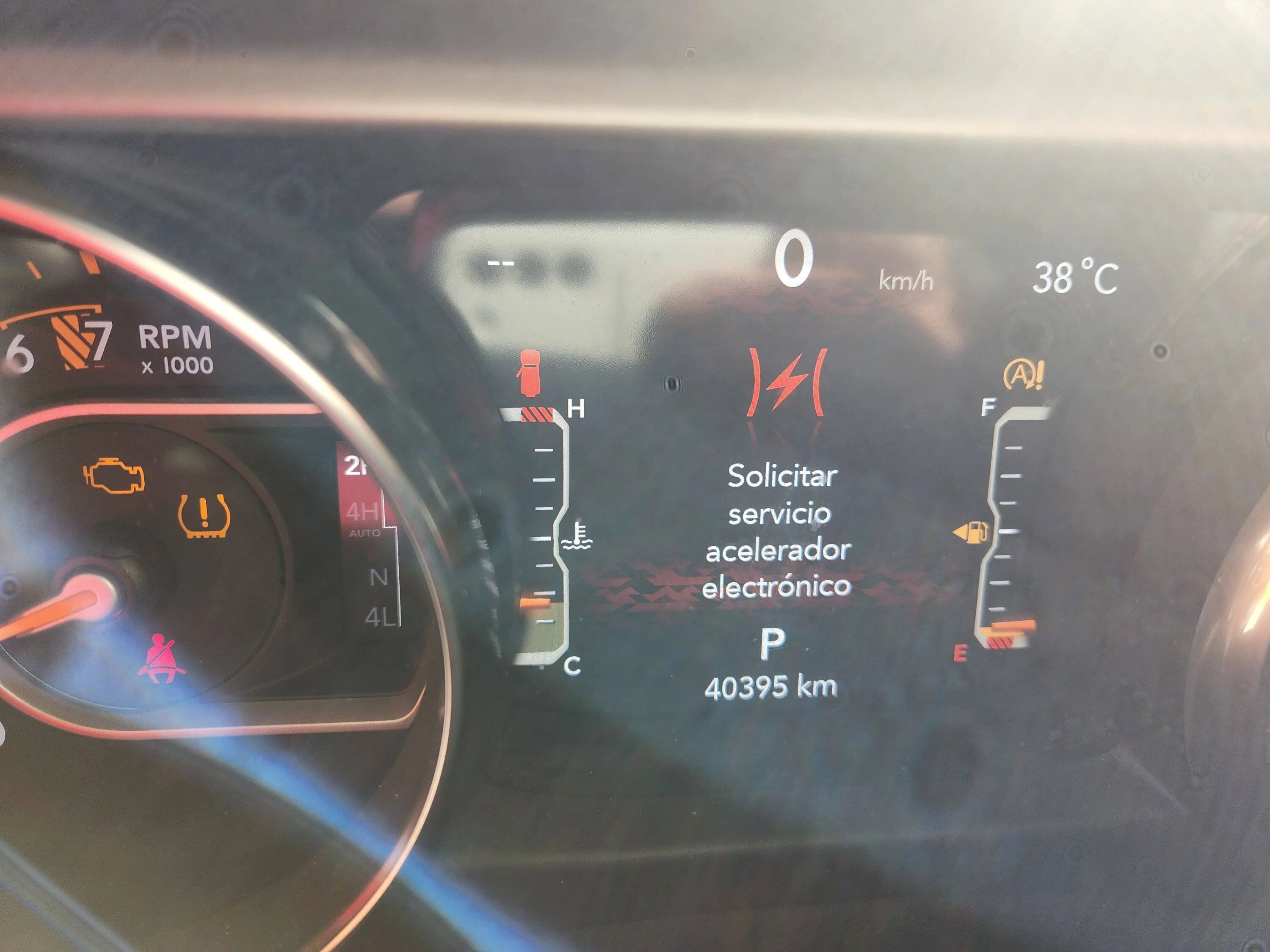

Hello, aparently because of a loose ground wire all this lights came on. ESS doesn´t work (both batteries where changed recently). I haven´t notice anything wrong with my jeep regarding power of arnything else. This lights have been ON for about 5 month now. Any ideas of what can it be?
Also I am looking to clear all this lights, (I am an android user) what OBD2 system you recommend me just to read/clear codes? Will it work to clear all this lights?
2019 JEEP WRANGLER JLU SPORT 3.6L
THANKS!!
