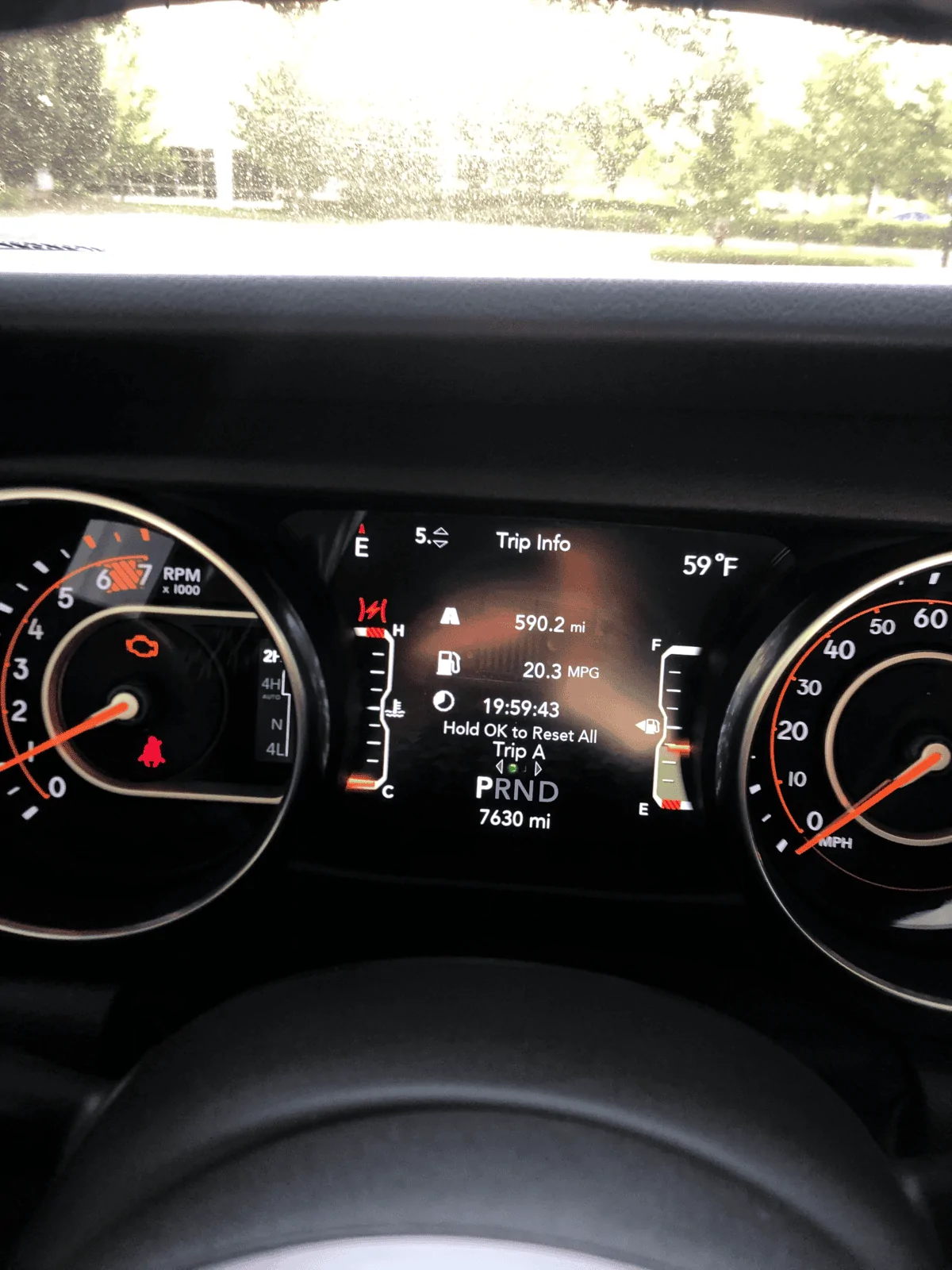

Just like before, check engine light one day and first trip over 30 miles same issue with loss of power and electronic throttle control light. Have requested Jeep to step up and do the right thing....we will see.
Jeep Wrangler JL Break Down - Service Electronic Throttle Control and Stability Control upload_2019-8-30_10-39-58
