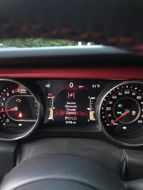

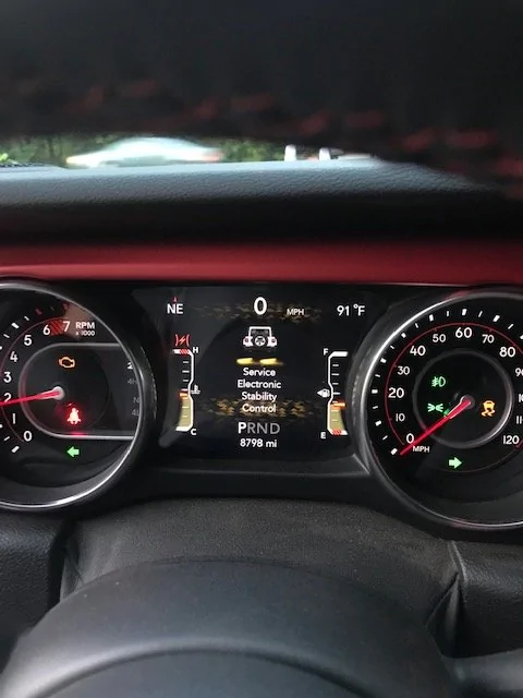

So I get this error ONLY with the doors off. I got my JLUR in April of 2018. The 2nd summer every time I started my Jeep without doors I would get the "Service Electronic Throttle" error. Only for a split second. The dealer could never see the code and basically said it can't be fixed.
This year (my 3rd summer) it has only flashed twice with doors off, and at random times. However I do get the "Vehicle not in park" message every 5 minutes with my doors off.
