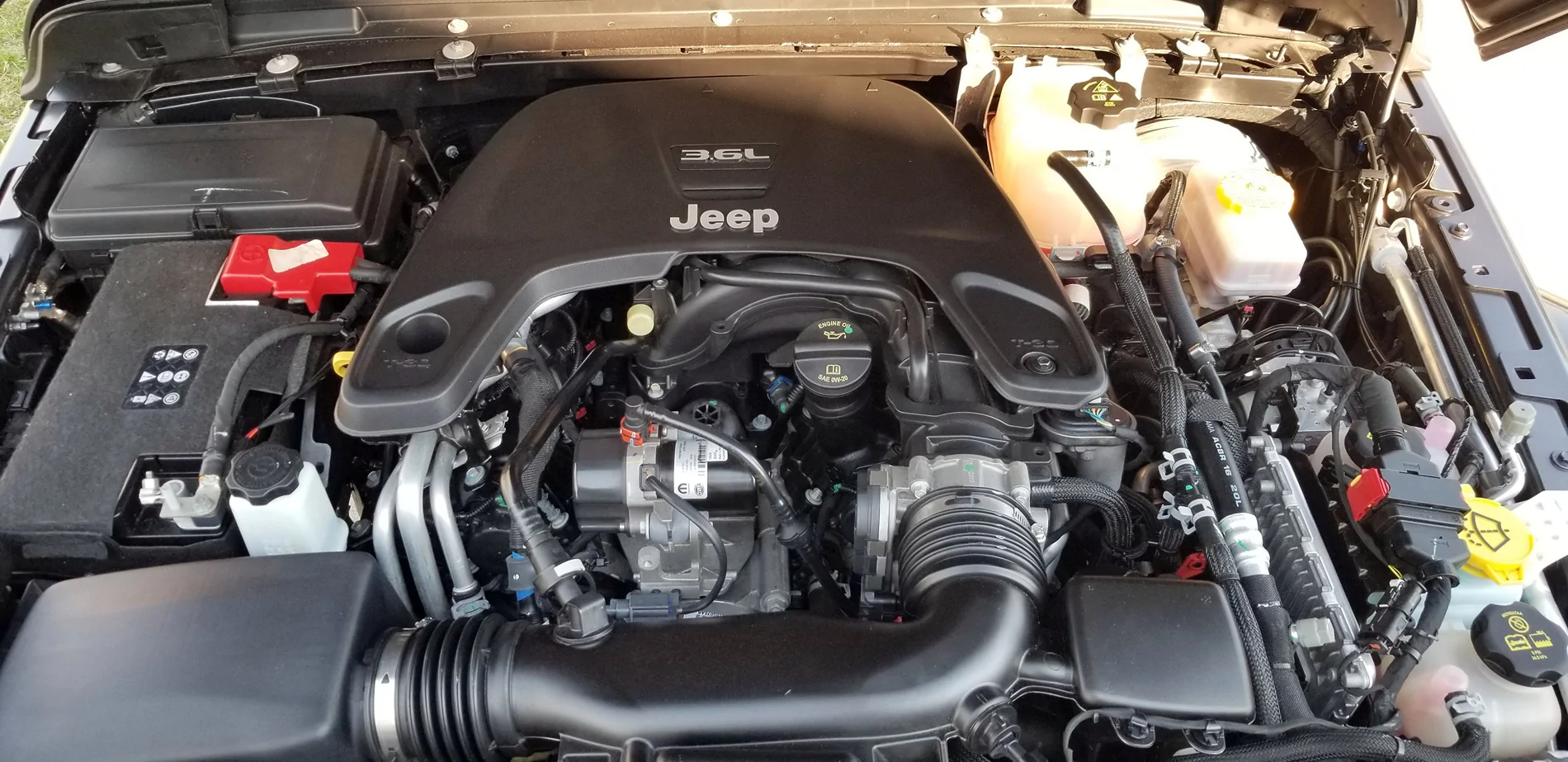

New here. Bought a 2021 wrangler unlimited sport s 80th edition 3.6L V6 24v vvt e torque yesterday for my daughters sweet 16. Wrangler is her dream vehicle.
had my mechanic look it over. He is not familiar with the e torque and he actually advised against it and said you should take it back and find a plain V6. Otherwise the vehicle is mint per se.
hoping to hear some feedback from this forum on thoughts on e torque MGU etc. anything I need to worry about or cost wise? He mentioned it’s hard to find someone to repair if MGU goes bad and is very expensive. Thoughts? I have 14 days to return and can continue shopping if need be.
