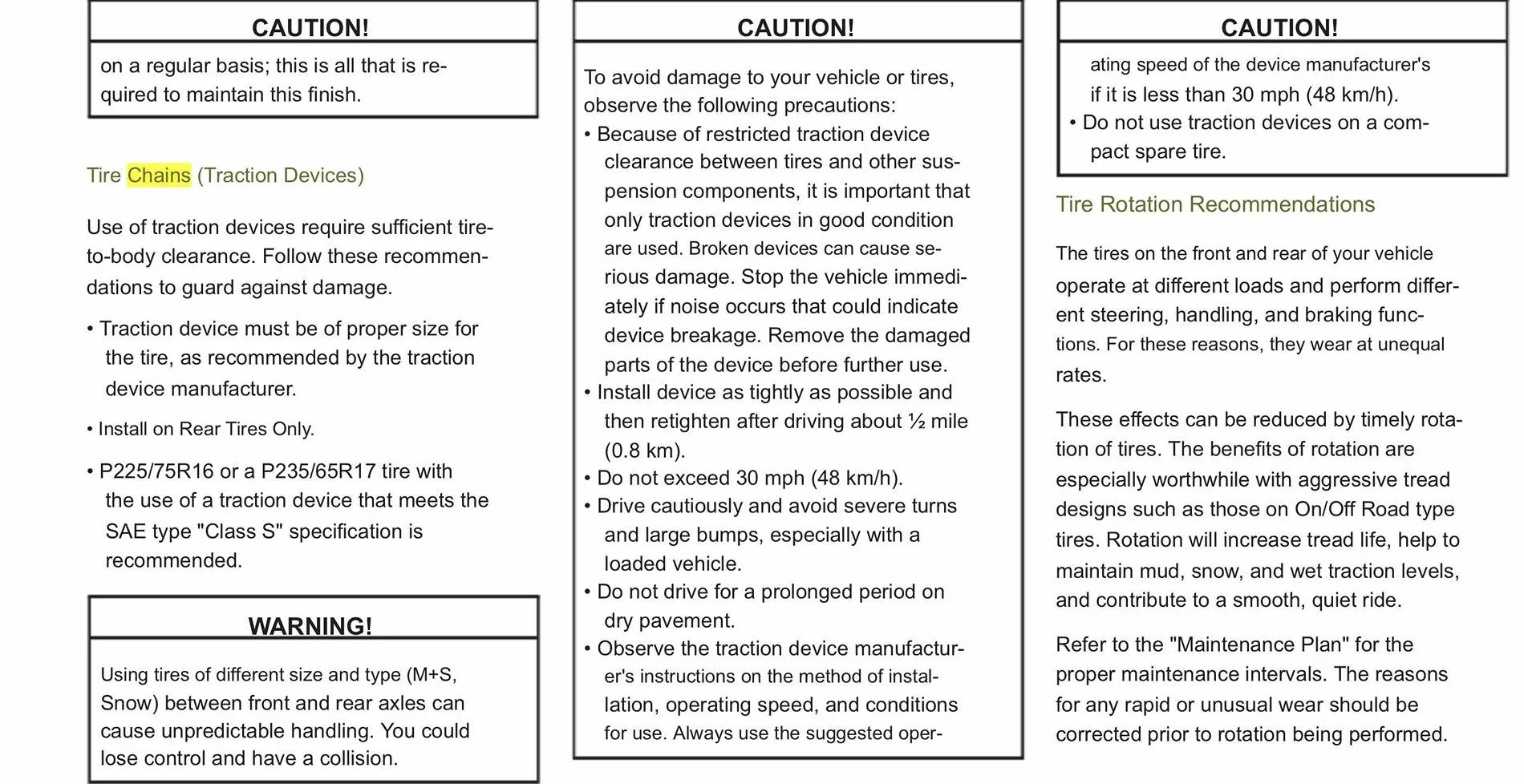

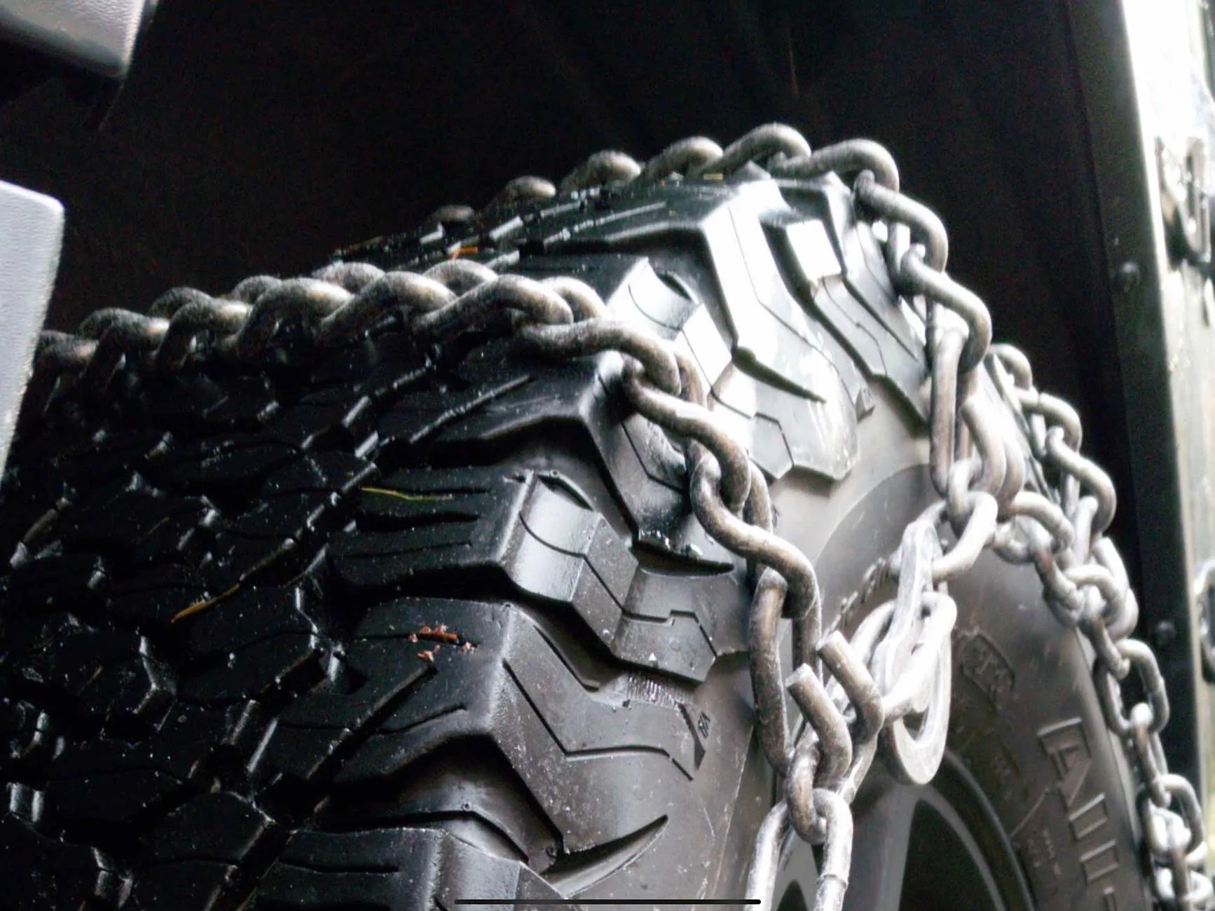

I’m interested in hearing Jeep drivers experiences in snow. Any special considerations? I would only use chains as a last resort, is using them on the front a bad idea?
Thanks for sharing.
Hey. Have been driving the JL for 6+ years in snow and ice and slush and rain and dry and combo with almost zero issues on half worn crap KO2s that some despise. Drives like a tank in 2H until 4H then 4L. Then locked rear then locked F+R - then chains on the rear then chains on all 4.
Goes against what some say that lockers are crap in snow and chains should not or never be used on a JL. That Rubicon is crap locked in snow and you will fall off a cliff. Blah blah blah. Ok. Got that. Hmm? Maybe they should try and find out firsthand themselves vs speculate.
But would avoid chains on front only. The Rubicon is a very fun safe vehicle for just that. Almost unstoppable given you know how to drive in that and know how a Rubicon locked and with chains handles. Also carry boards and full length shovels. That helps when stuck. Enjoy the snow. Best time of year by far for a Jeep for us.
Finally. Make sure to tie off the loose ends of chain links with wire.
