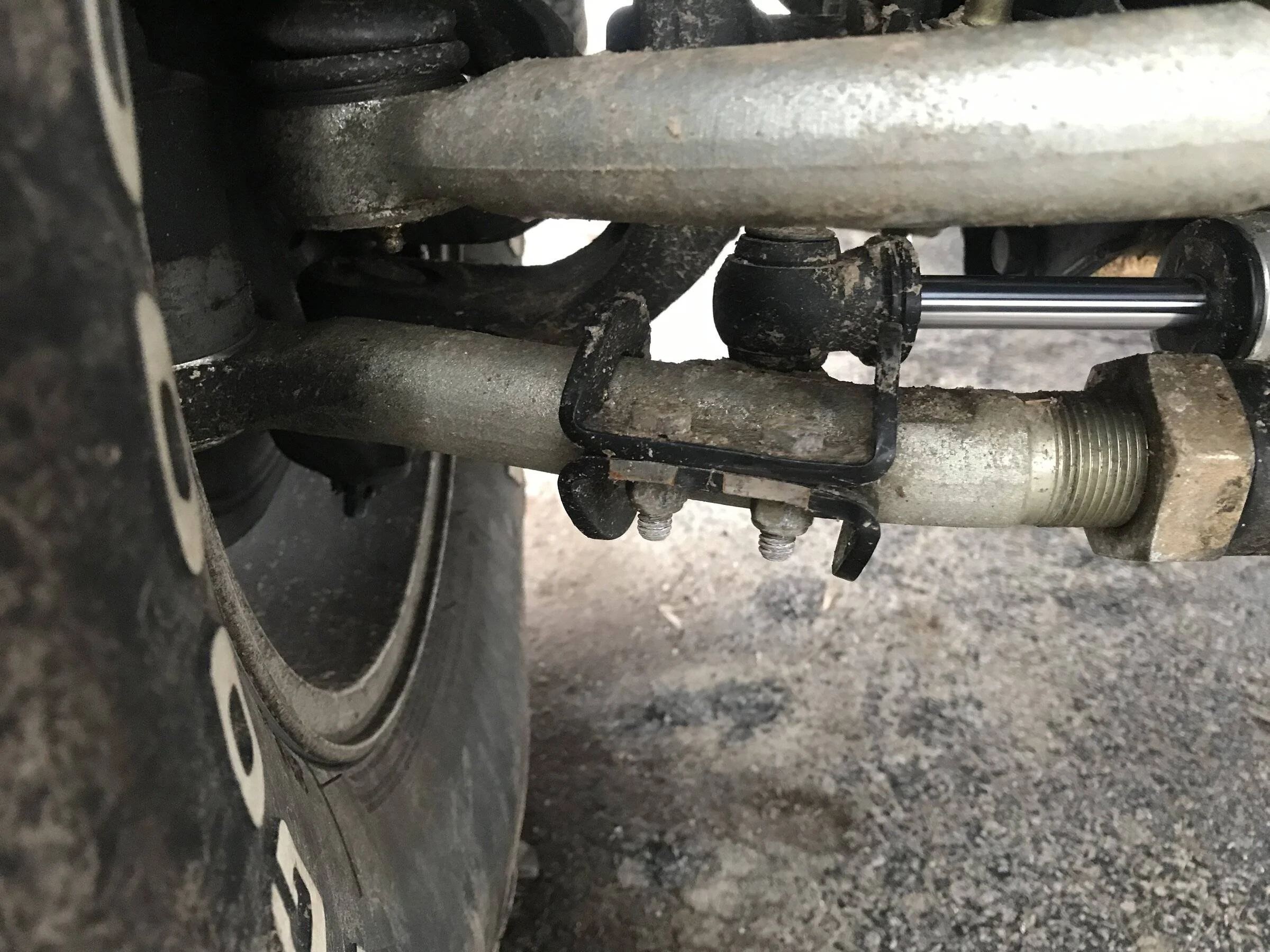

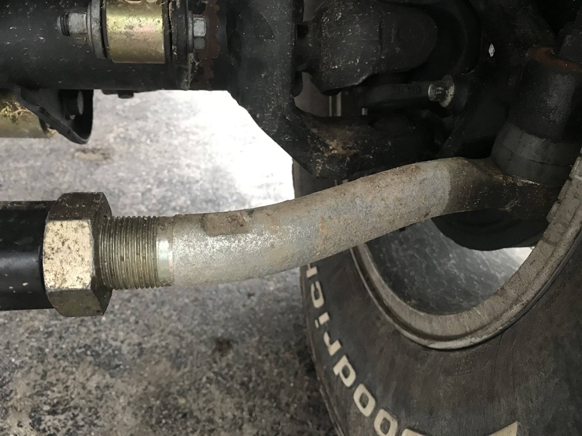

Also, pretty sure the tie rod end on the drivers side is bent. Passenger vs driver side below.

Spank
Mar 29, 2017
2,698
4,590
don’t think I could argue that it was defective??
If you had your OEM parts still bolted to the axle, there's a slim chance that might work, but there's no way they'll cover that.
