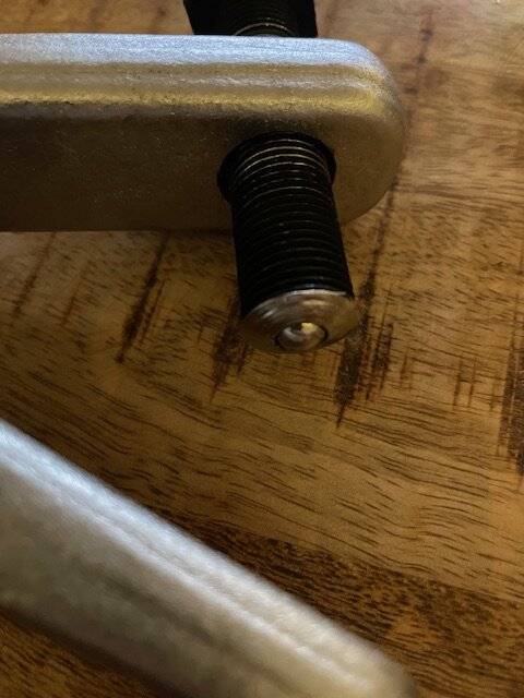

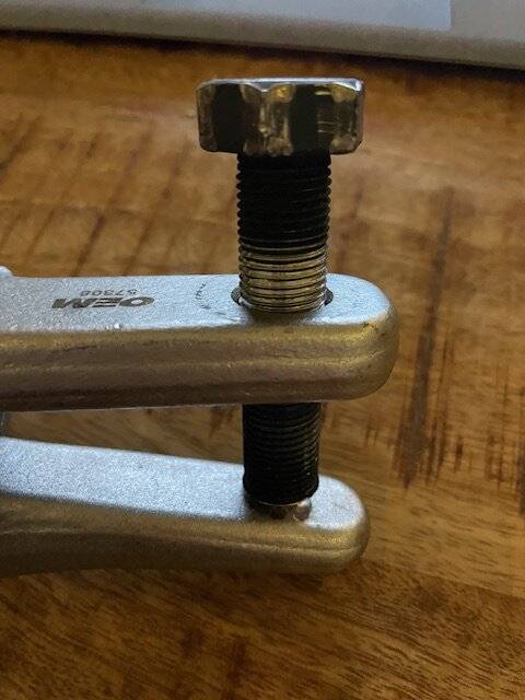

I rented this removal tool and it did not break the draglink loose from the pitman arm.
The tighter it got, the more the bolt started moving toward the edge. When I loosened it, I noticed the threads somehow cross-threaded.
Can anyone help me find the best tool to remove this?
Will a pickle fork work better?
If so, what size?
Thank you

I finally found a thread on here where the guy was having worse luck than me. He tried torching and a bunch of other ideas before unbolting the other side and zip-tying it up as high as possible. He used a pickle fork (again) and the joint broke free. His idea was the bolt was no longer in a bind at this angle, which allowed it to break free. I’m going to try and see if autozone will refund the “rental” for that puller, even though it stripped and did not work properly. Then grab a pickle fork and BFH and cross my fingers.

Man I just did this. I ended breaking that puller in half! I used a beefier puller I got on amazon and it finally came off. Good luck and watch out when it finally breaks free, it's quite violent.

Thank you.. I was thinking the same thing. When the bolt on the autozone puller was inching toward the edge as I was hitting it with my milwaukee impact I thought something was going to explode. I am also going to try and find a 42 mm socket for the pitman bolt, just in case I can't get it with the pickle fork and BFH. I don't have my jack and stands here, as I left them in Oregon when we left. I am just going to grab a transportable 2 ton jack and some stands today. This way I can take the wheel off (like I should have done originally).
I am hoping there is still enough room for me to hit the pickle fork, with the wheel still on. I will try a few different angles on the drag link arm, to see if that is causing it to bind. I don't have a torch though, only a heat gun :/
I wonder if autozone will refund me for the puller that cross-threaded and started slipping like that.

FWIW, I use that exact puller and it works every time.
