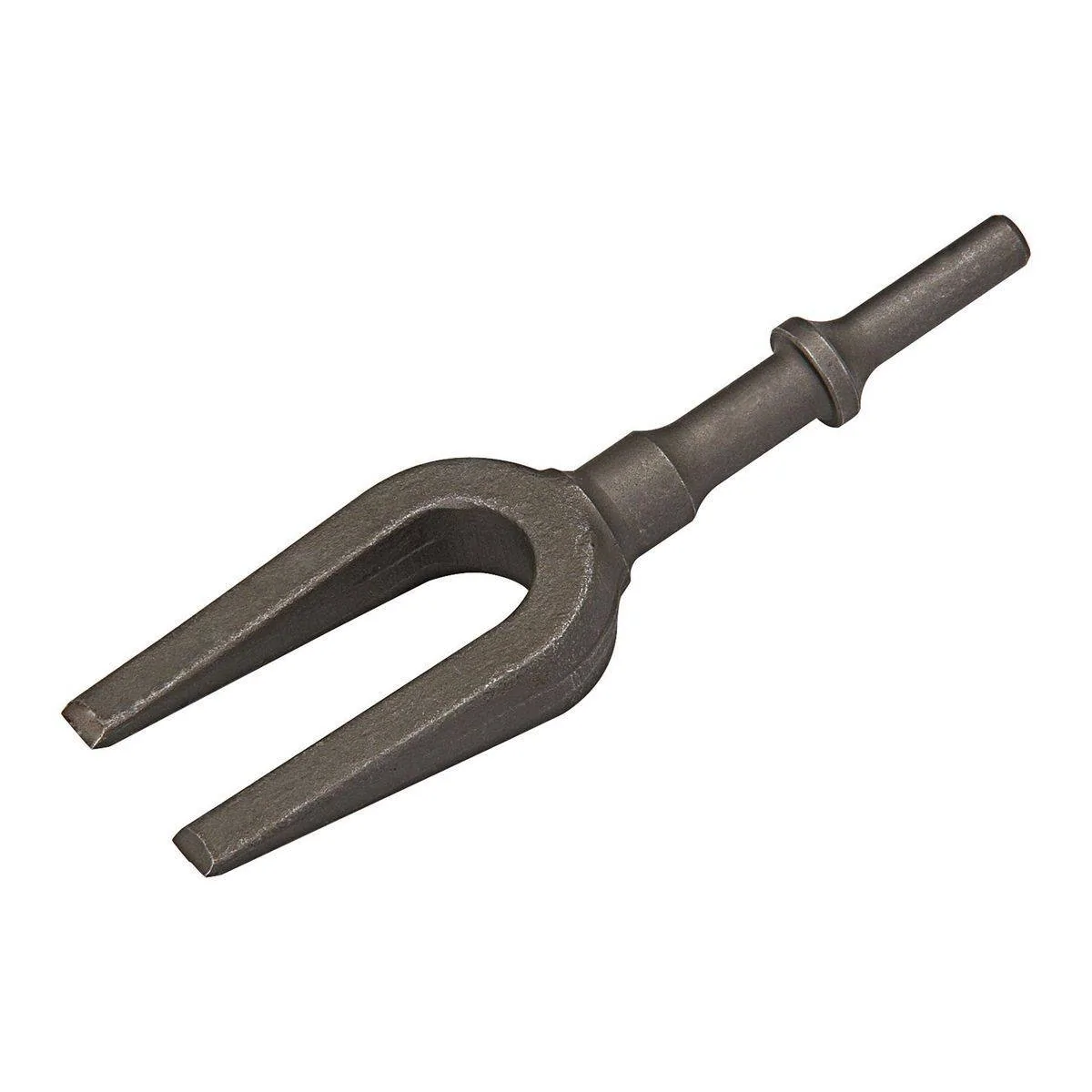

I had some difficulties getting the drag link separated from the pitman arm. It’s my daily driver as well. Ended up buying a pickle fork that was just slightly bigger than the one I used from the rented pickle fork set. That little change made all the difference for me. Only took 3-4 swings and it popped right off.
THIS may be the ticket. Where did you find the bigger pickle fork?
It seems like the one I got from autozone is just a tad small. I have tried heating it, broken two separating tools, threw many tools (not enough I guess), and rotated the knuckle side a bunch of different angles.
Local jeep club is recommending hitting the joint itself with a sledge, while holding a hammer against the other side.

I pickle forked mine as well and beat the absolute living shit out of it with a hammer. Neighbor comes over to see what the banging is, lightly taps the pickle fork and the drag link falls off lol.
I just loosen the nut almost all the way off then tap the outside of the pitman arm around the whole the draglink goes through. Heavy hammer and lots of light to medium taps always works for me.

I just went through this myself. Tried all the tricks in that thread including propping a 2x4 from the foundation of my house to the end of the pitman are so I could beat on the pickle fork really hard without worrying about breaking the steering box. In the end I removed the pitman arm, cut off the connection to the drag link so I could prop it on my vise and pound the threaded end out. This worked and I can tell you that with how hard I had to pound on it it was never coming off with the pitman arm connected to the steering box. I soaked the big nut on the pitman arm with PB blaster overnight and it came right off. I used this puller to remove the pitman arm
