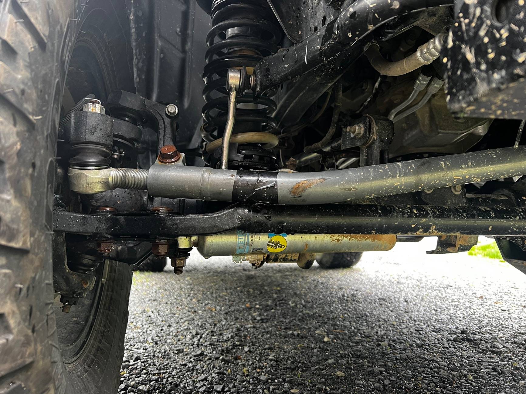

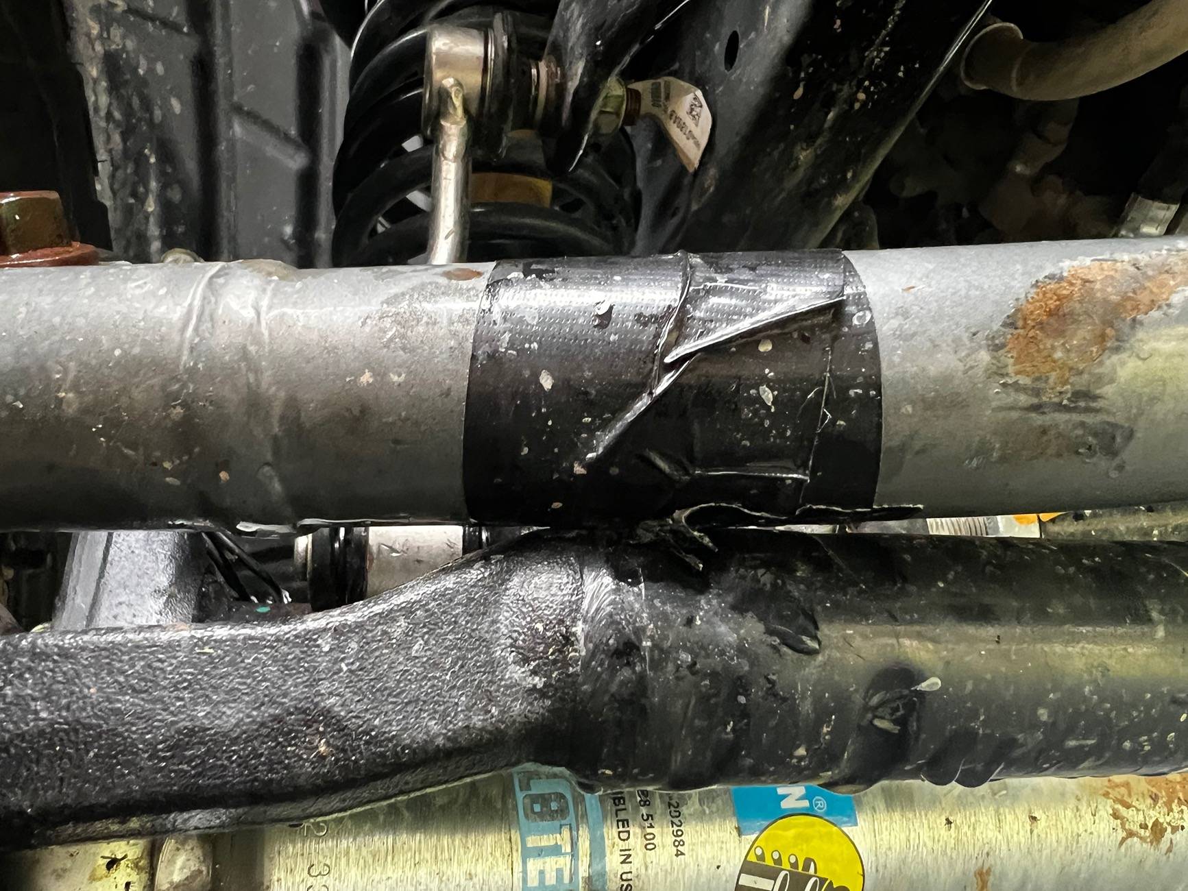

So I have a
Mammoth HD Drag Link (18-24 Jeep Wrangler JL)
And a Mevotech tie rod. Both have about 1000 miles on them (by me I purchased new) so basically brand new.

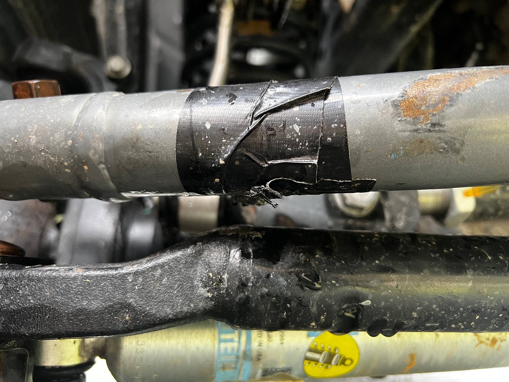

my drag link slumps down and rests on my tie rod.
everything is torqued correctly and I’ve greased all the zerks before driving so everything is lubed up.
what’s going on? And I’ve got a huge trip to Moab planned (over 2000 miles one way and I’m driving) am I good to drive like that? Pictures of what I’m talking about….
Jeep Wrangler JL Drag link hitting tie rod help? IMG_1876
Jeep Wrangler JL Drag link hitting tie rod help? IMG_1877
Jeep Wrangler JL Drag link hitting tie rod help? IMG_1875

I’m not familiar with that brand, but it’s been my experience that some of the cheaper drag links and tie rods don’t come with any anti-flop mechanisms…… they are supposed to be able rotate a little so they don’t bind when turning and articulating…Maybe reach out to Mammoth and see if they have any suggestions…

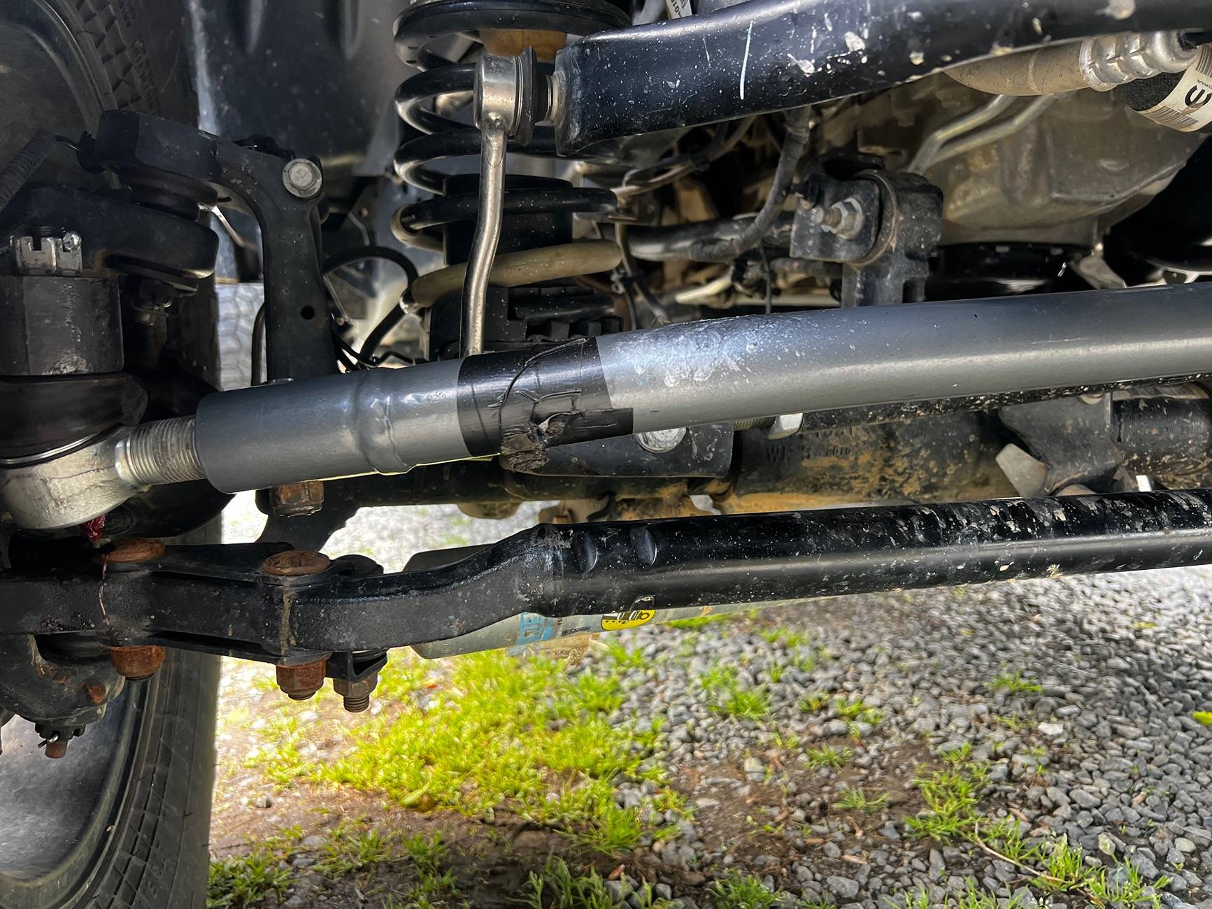

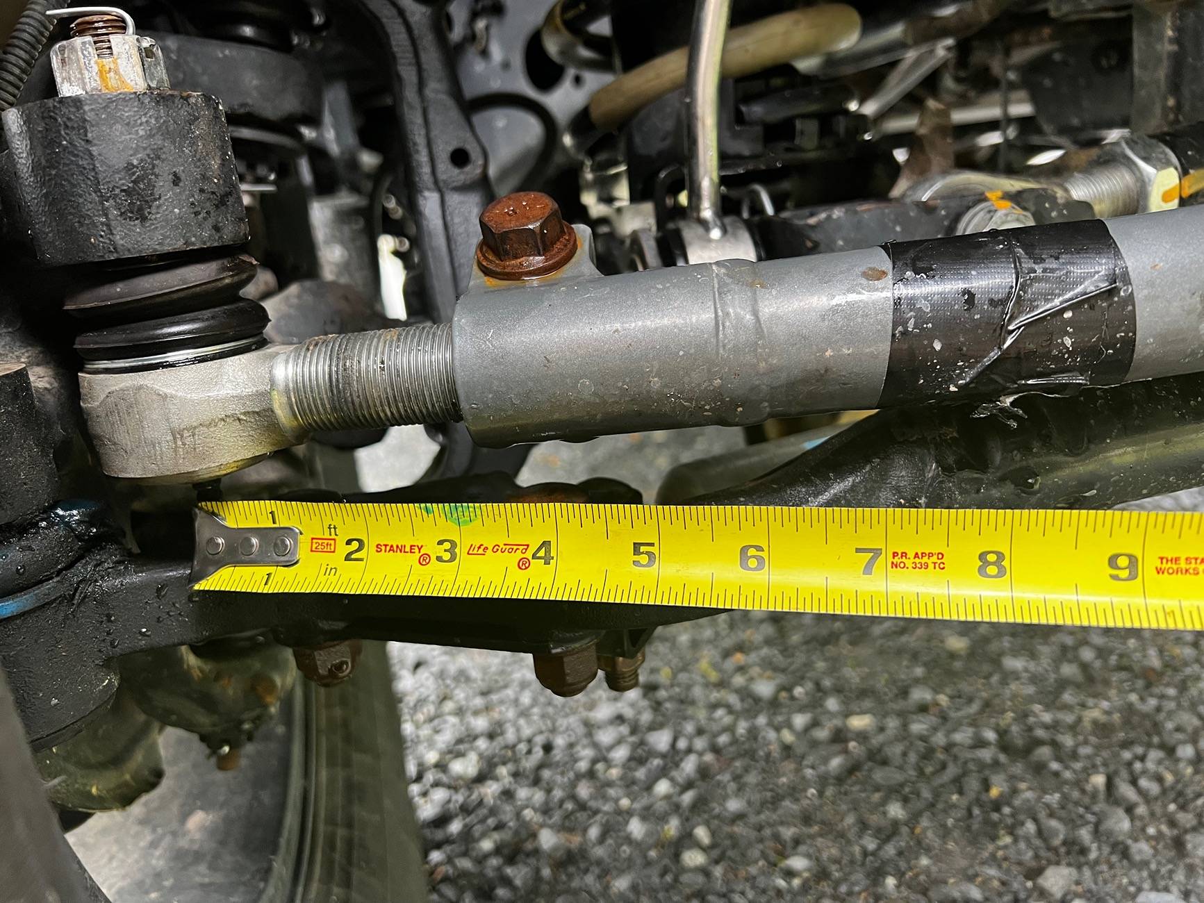

Cool. I got a call into a local 4x4 shop that didn’t an alignment for me recently….I sent them some pictures and a video to get their input. I don’t think it was hitting before they had it. And it looks like the bar might be about 1” longer on the wheel side since they got it …
Jeep Wrangler JL Drag link hitting tie rod help? IMG_1882
Jeep Wrangler JL Drag link hitting tie rod help? IMG_1878
GATORB8
May 30, 2021
8,830
11,726
CLT NC
21 JLURe, 06 LJ, 25 HDZR2
@stretch-bsn Point the bend on the draglink forward. If you didn't have an issue with the tiny bit of steering off center that may cause before, it should be fine now.
I would however balance off the thread exposure, unless the rod ends are extremely long or it says to take the width out of the knuckle side.
If you are comfortable with the thread showing, simply loosen the two pinch bolts, rotate the drag link body forward/up, and tighten them back down.
I'd assume that's exactly what happened. It look all clear when the tech tightened it down, but the "flop" dropped it far enough.
When it's "fixed", just push down on that angled section to rotate the ball joint until it stops and make sure it clears at that position, if not, adjust the angled section further up.
I wouldn't doubt it ends up riding in the drooped position due to the additional weight on that side of the axis (I guess that's what you'd call the straight line between the knuckle mount and the pitman arm).
If you are comfortable with the thread showing, simply loosen the two pinch bolts, rotate the drag link body forward, and tighten them back down.
This is what I was thinking! The adjustment is just too far out on the knuckle side and the pinch nut is possibly not tight enough. I’m going to mess with it and see if that fixes it. I know there is some flop but it feels firm so I’m thinking/hoping that will do the trick!
yeah that makes sense too….because when I had it adjusted I wasn’t running into this problem but now that they’ve readjusted it it’s hitting.
Nvdardx28
James
Dec 12, 2018
84
74
MA
2019 Jeep Wrangler JLUR
Electrical Engineer
During the adjustment you need to hold the bent part of the draglink forward while tightening the jam nuts to hold it in place. I just recently adjusted mine and had my drag link propped up by a 2x4 during that process. Without it propped it my drag link would rest on the tie-rod.

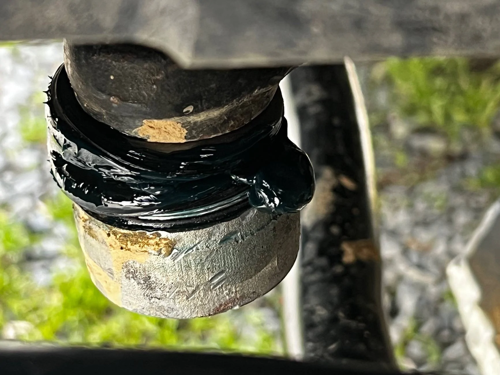

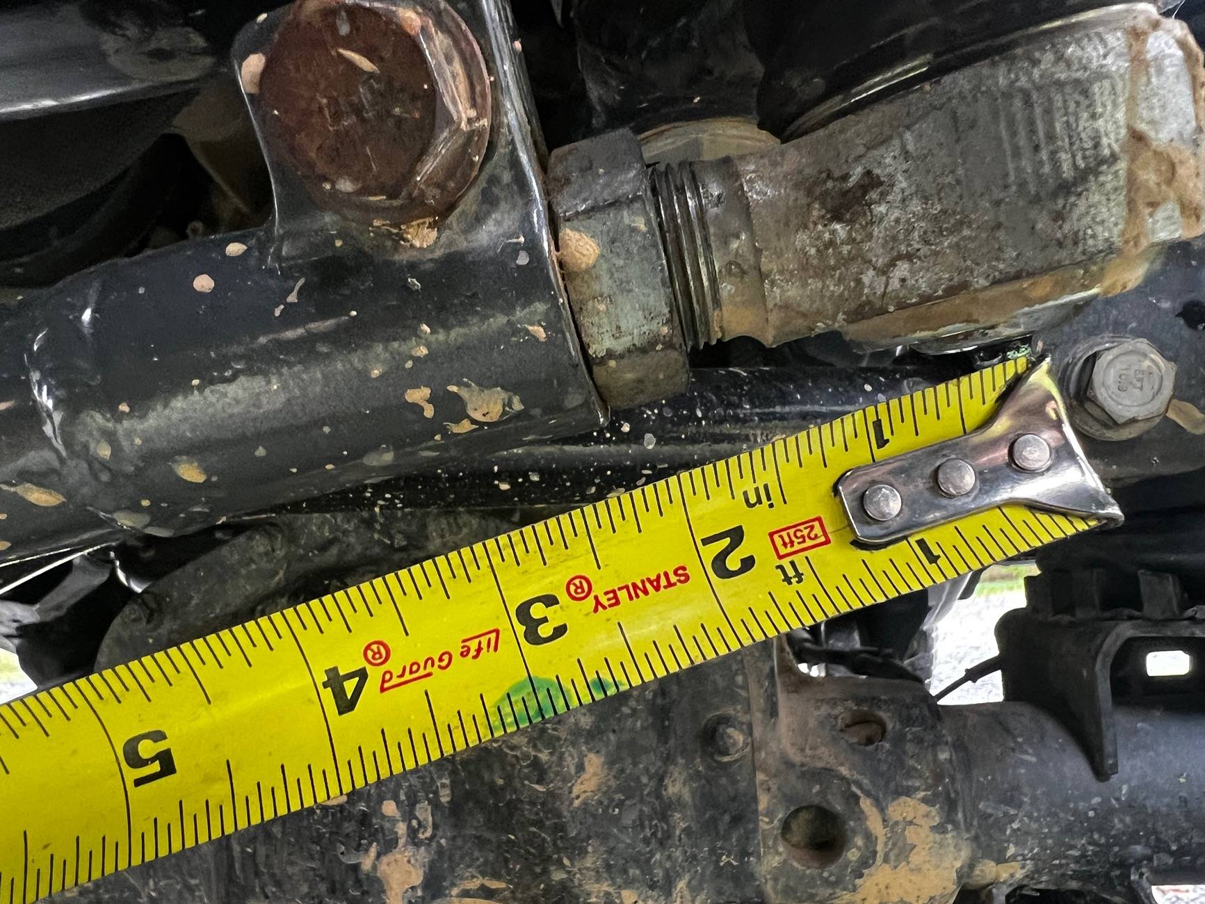

So I got it all squared away….i readjusted it so it was more even on each side…now it’s about 2-3/4 top and bottom instead of 2.5” pitman arm and 3.5” at the knuckle.
Also angled it up so even in its “resting” or droop it’s still a good distance away from the tie rod. I went ahead and regressed and it looks to me like the dang boot is torn! It didn’t come out while I was filling it but took it for a test drive and look…. Doesn’t that look like it’s coming out of the middle of the dang boot! I just want to be done with it at this point. Last thing I want to do is try to smack out that end without messing up the bushing…I had to use a pickle fork last time and destroyed the stock one.
Thoughts?
Jeep Wrangler JL Drag link hitting tie rod help? IMG_1898
Jeep Wrangler JL Drag link hitting tie rod help? IMG_1896
GATORB8
May 30, 2021
8,830
11,726
CLT NC
Thoughts?
There are overflow slits in the side of some BJ boots. I wouldn't freak out until you clean it up.
