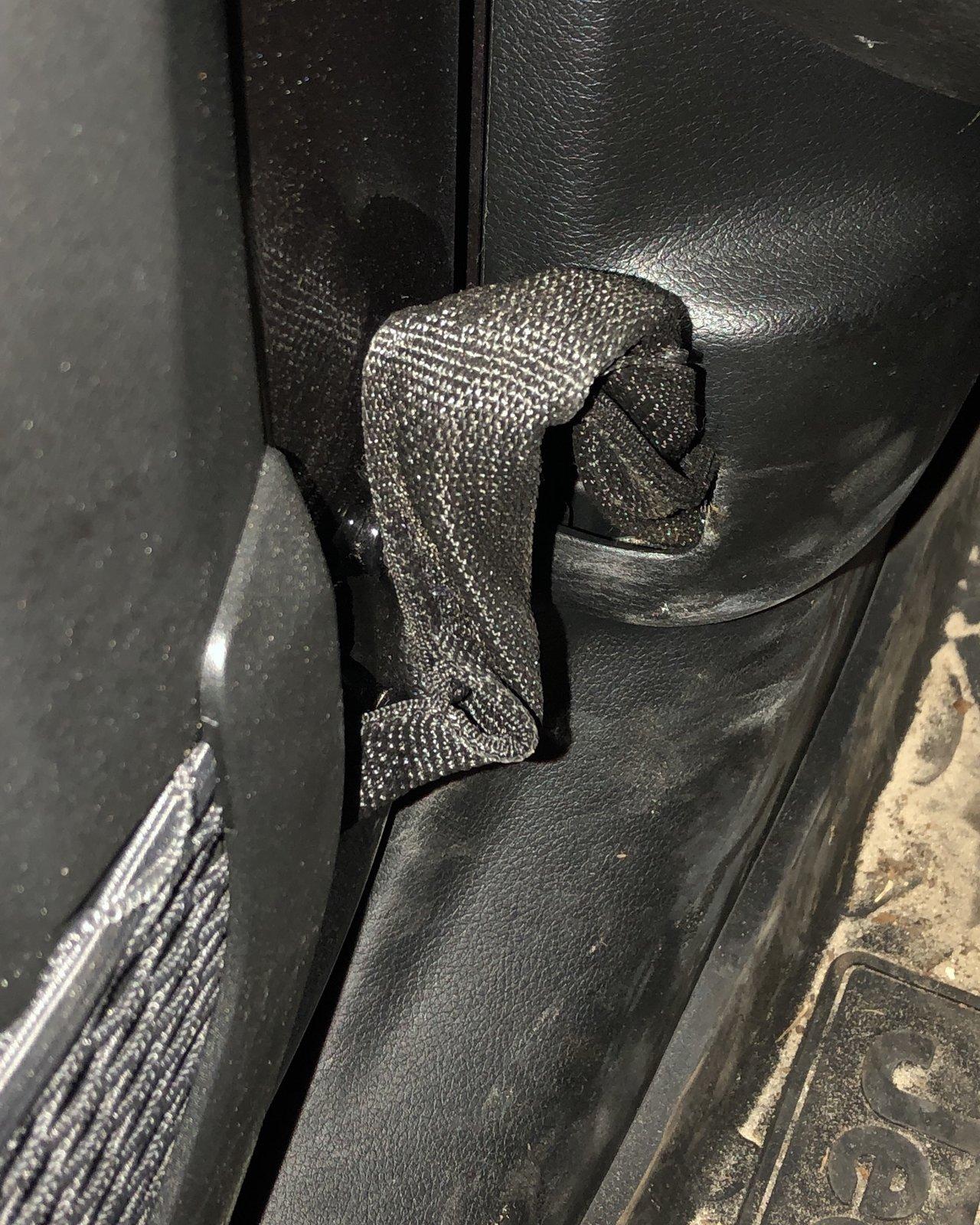

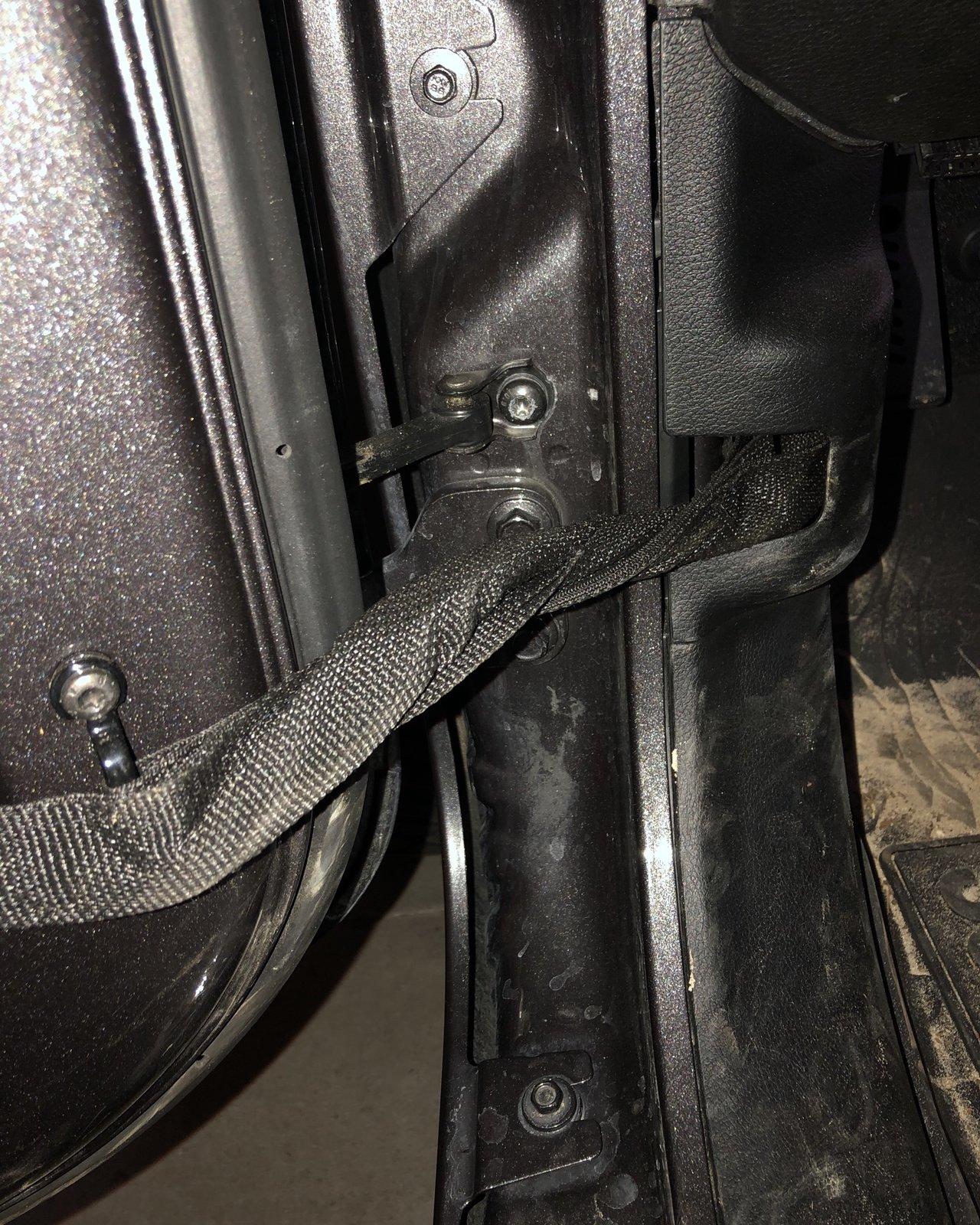

This indeed is very helpful. Here are my pictures before/after (actually driver and passenger) but you get it.
The first one (passenger) is twisted upward and out of the way, while the second one (driver) is the usually pointy towards driver. I can also confirm this twisting method is completely harmless to the cables and door limit strap, and does not change how door open/close functions at all.

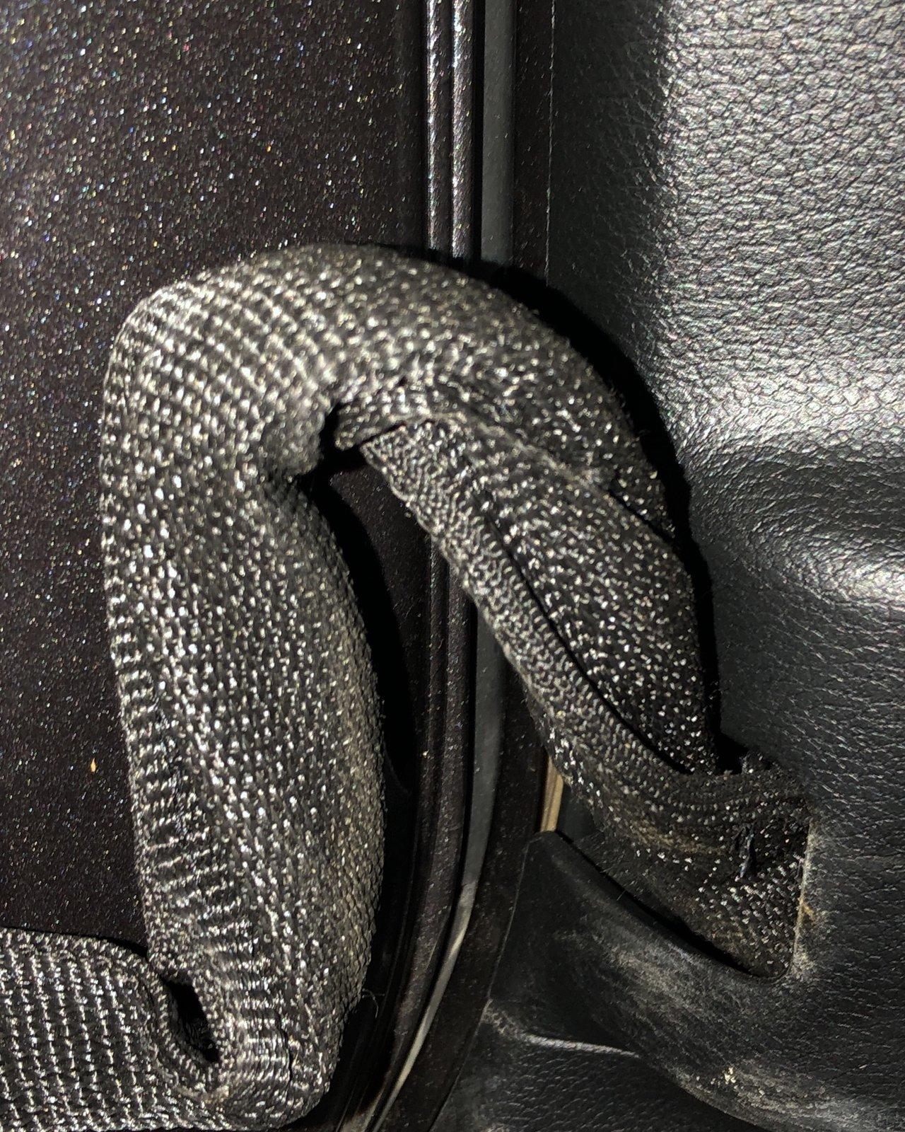

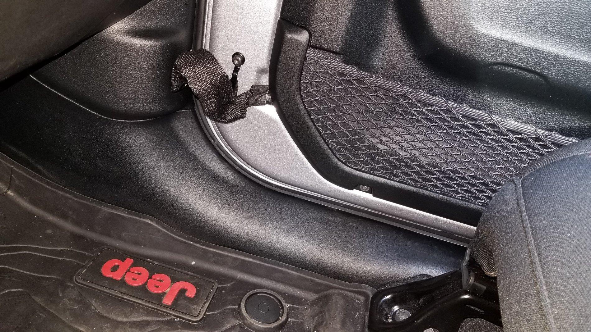

No issues... I’ve had mine twisted for almost a year now. I just turned it a half a turn, unhook it turn strap over and re hook it. Works great, keeps strap up against the door. I’m in shorts 99 percent of the time so this irritated the crap out of me.....:)
