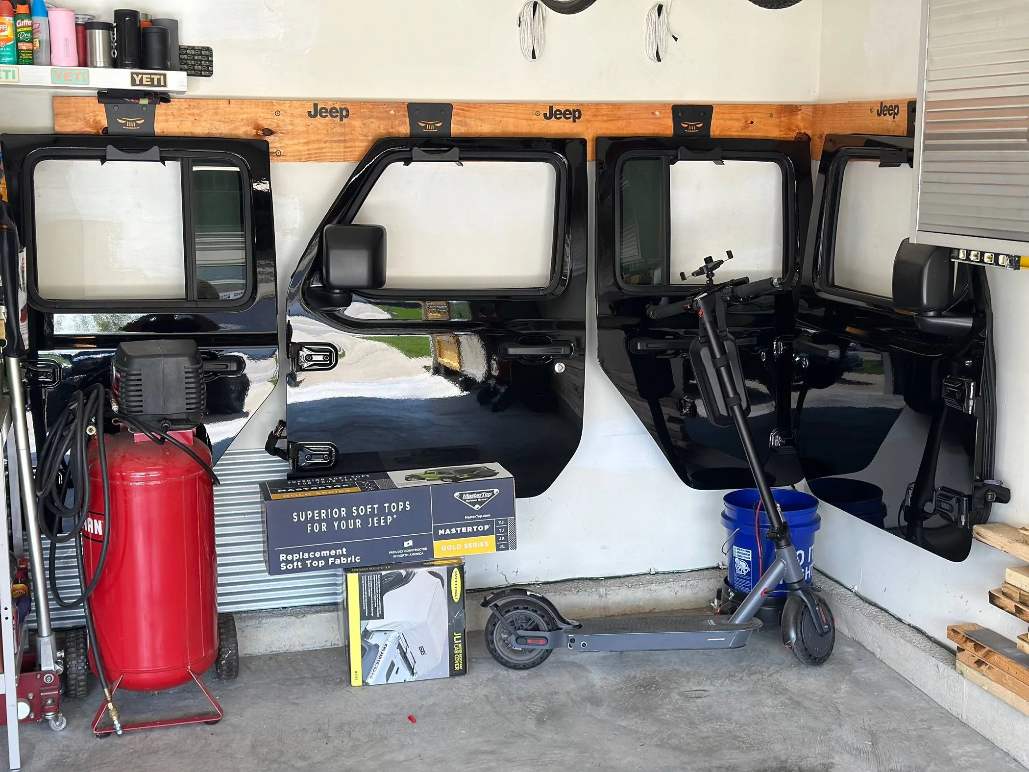

This is what I did for anyone searching that comes across this thread. I had the 2x4 scrap laying around the house so this cost me less than $10 and works perfectly.

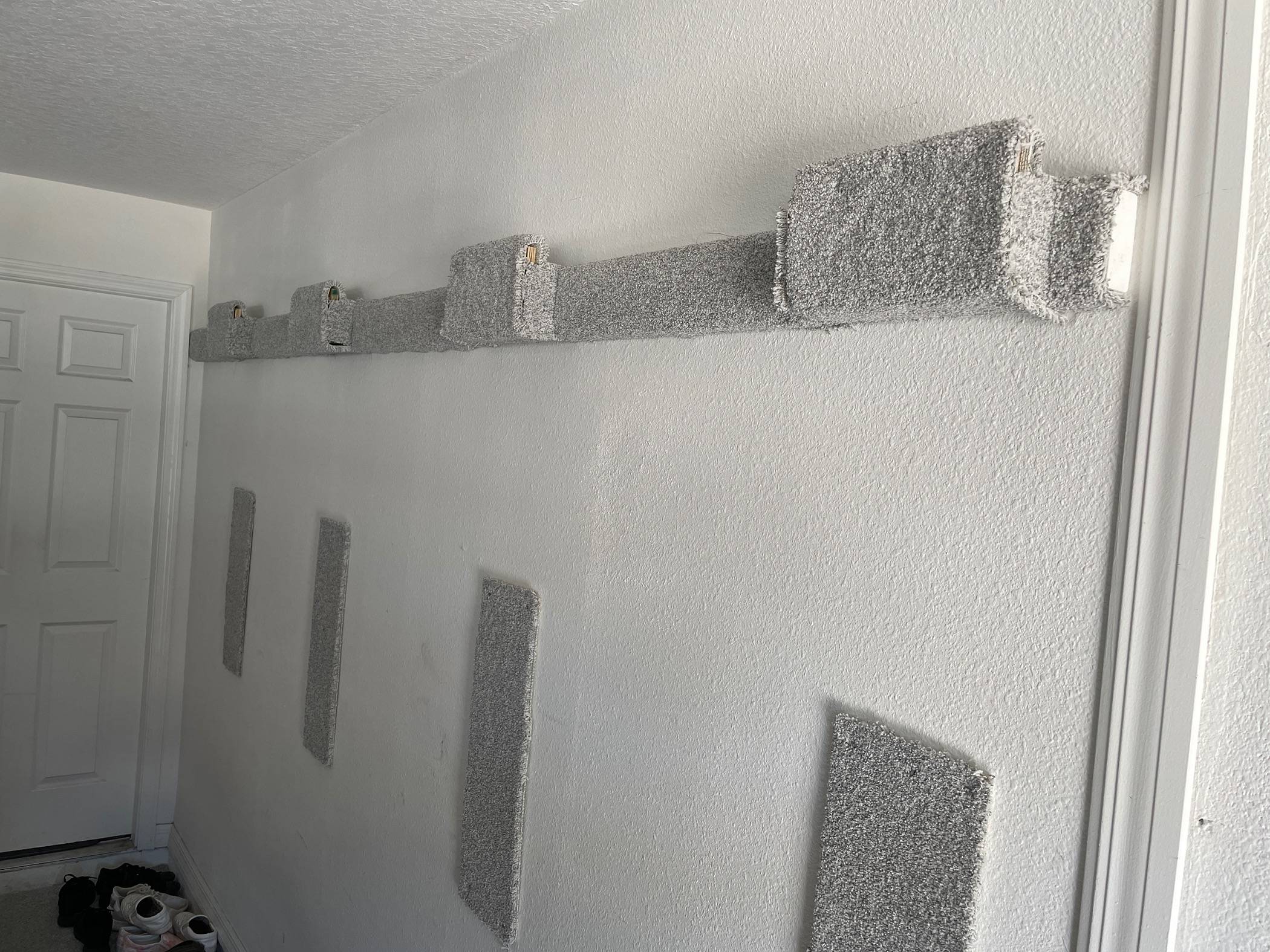

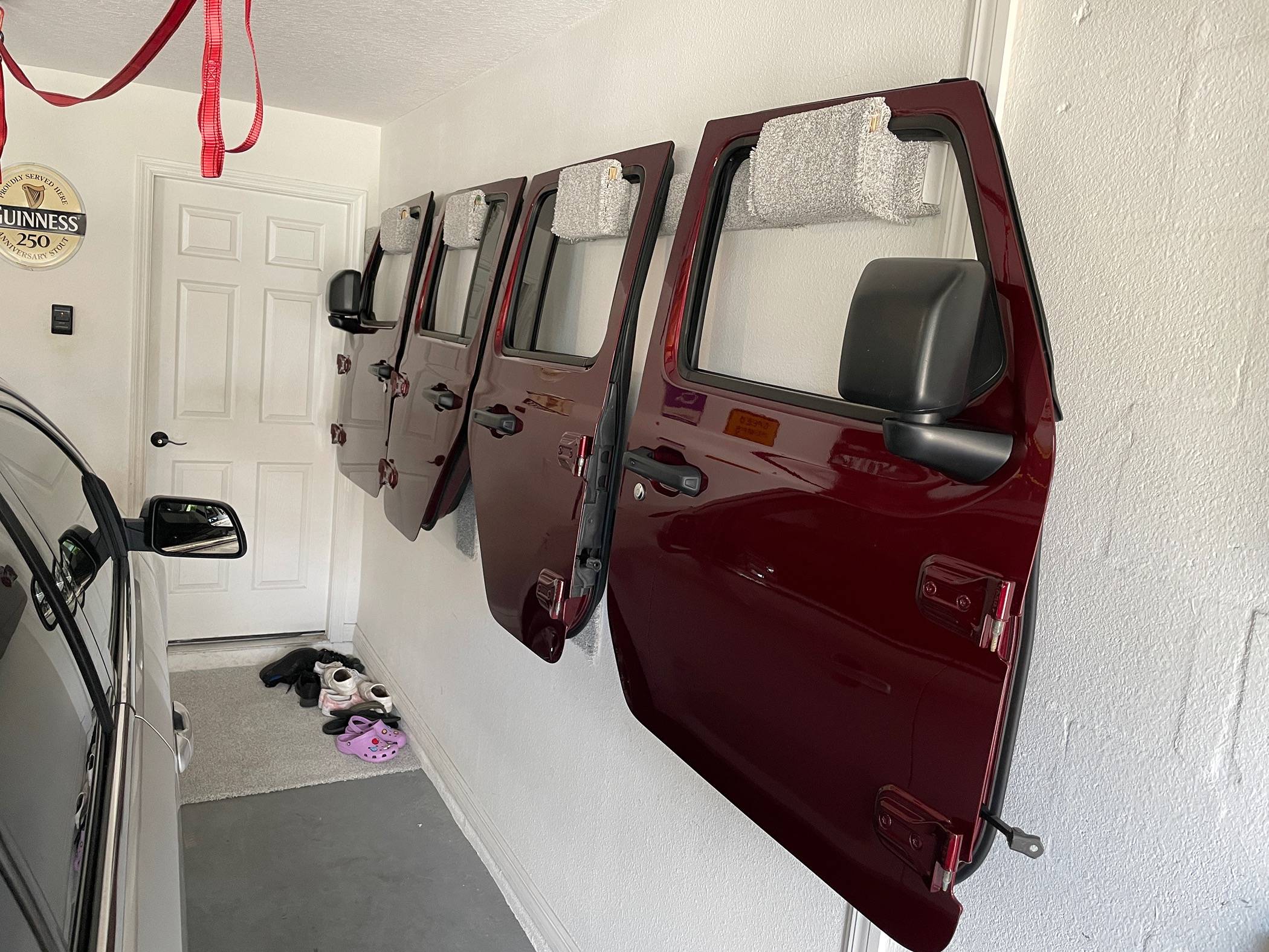

I took some 2x4 and made a rail then used small pieces of 2x4 and plywood to make hangers. This allowed me to use the studs to mount the rail and space the doors out to my liking with the hangers. Just used 3 1/2“ wood screws. The weight gets distributed across the 2x4 then to the studs. Super solid. Not coming down. Painted it initially but ended up covering it in carpet remnants.
Ditto, works great for full and half doors.
