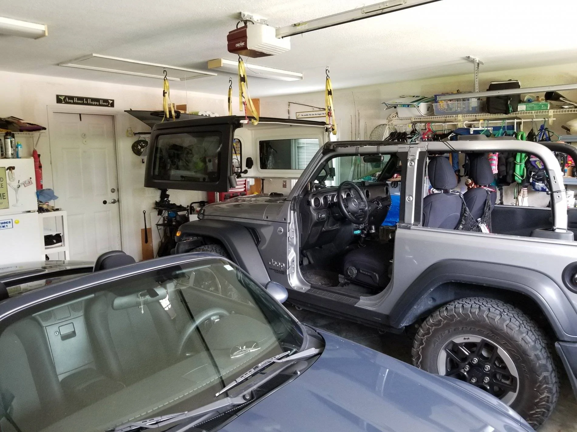

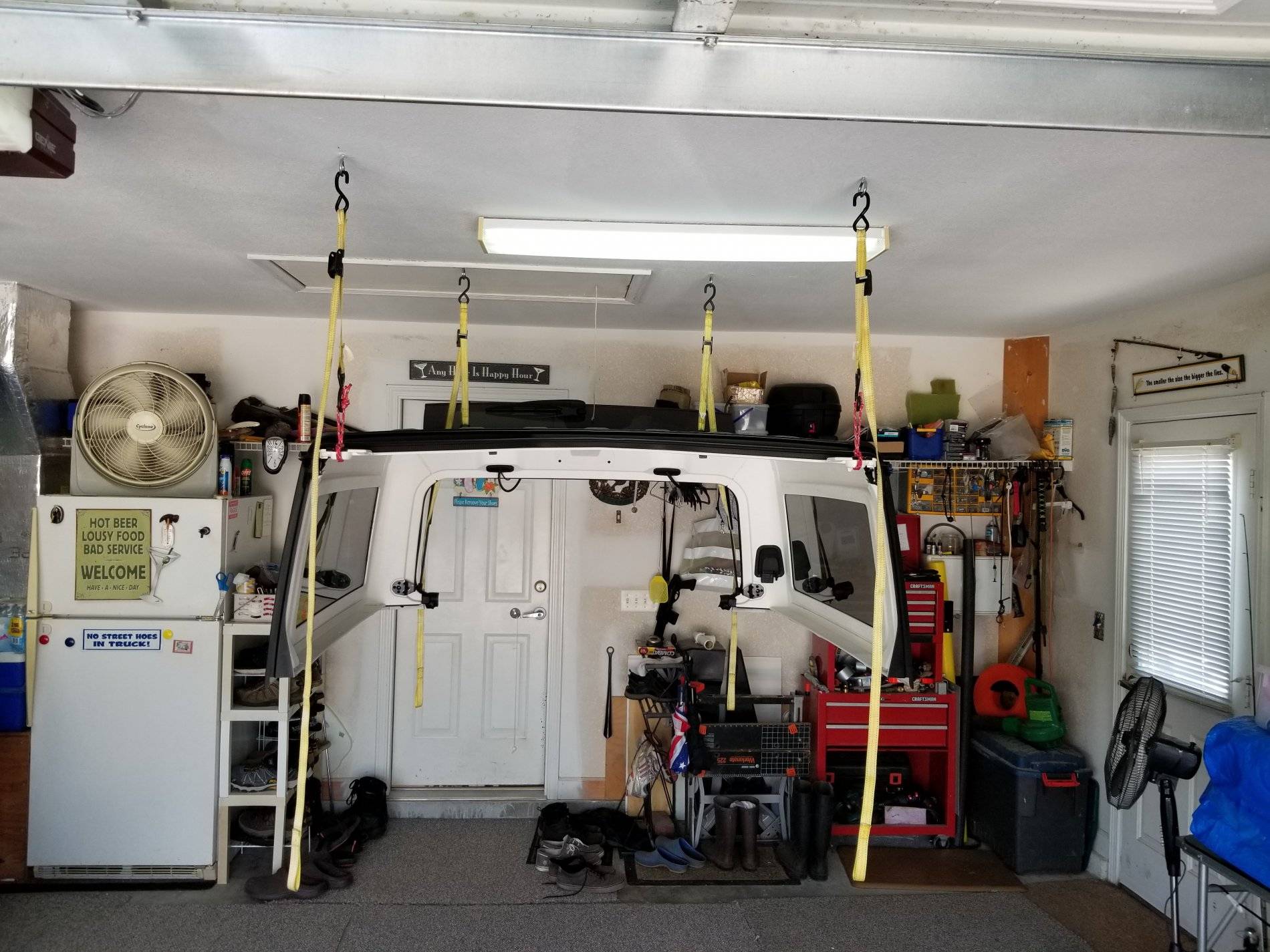

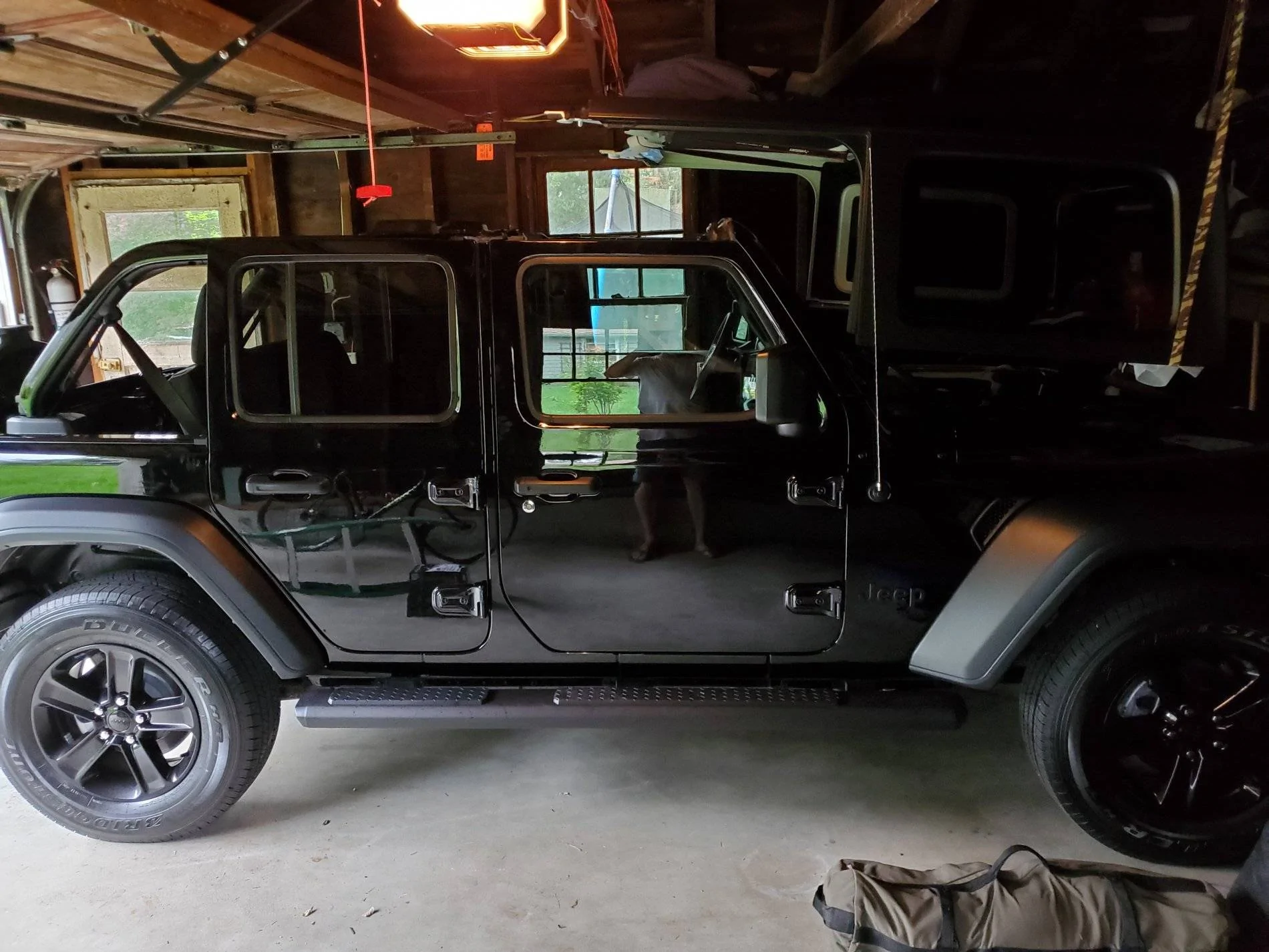

I dont hang the whole thing off those.
I do lift and hang it using them, splitting the load with Topsy brackets in the back.
Jeep Wrangler JL Hanging top from garage ceiling. 20200329_112313
Jeep Wrangler JL Hanging top from garage ceiling. 20190525_130331
