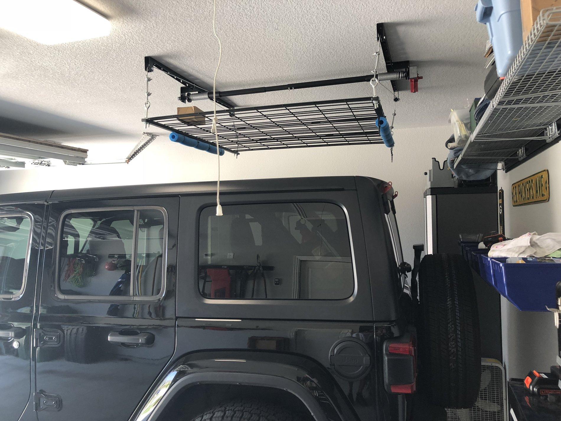

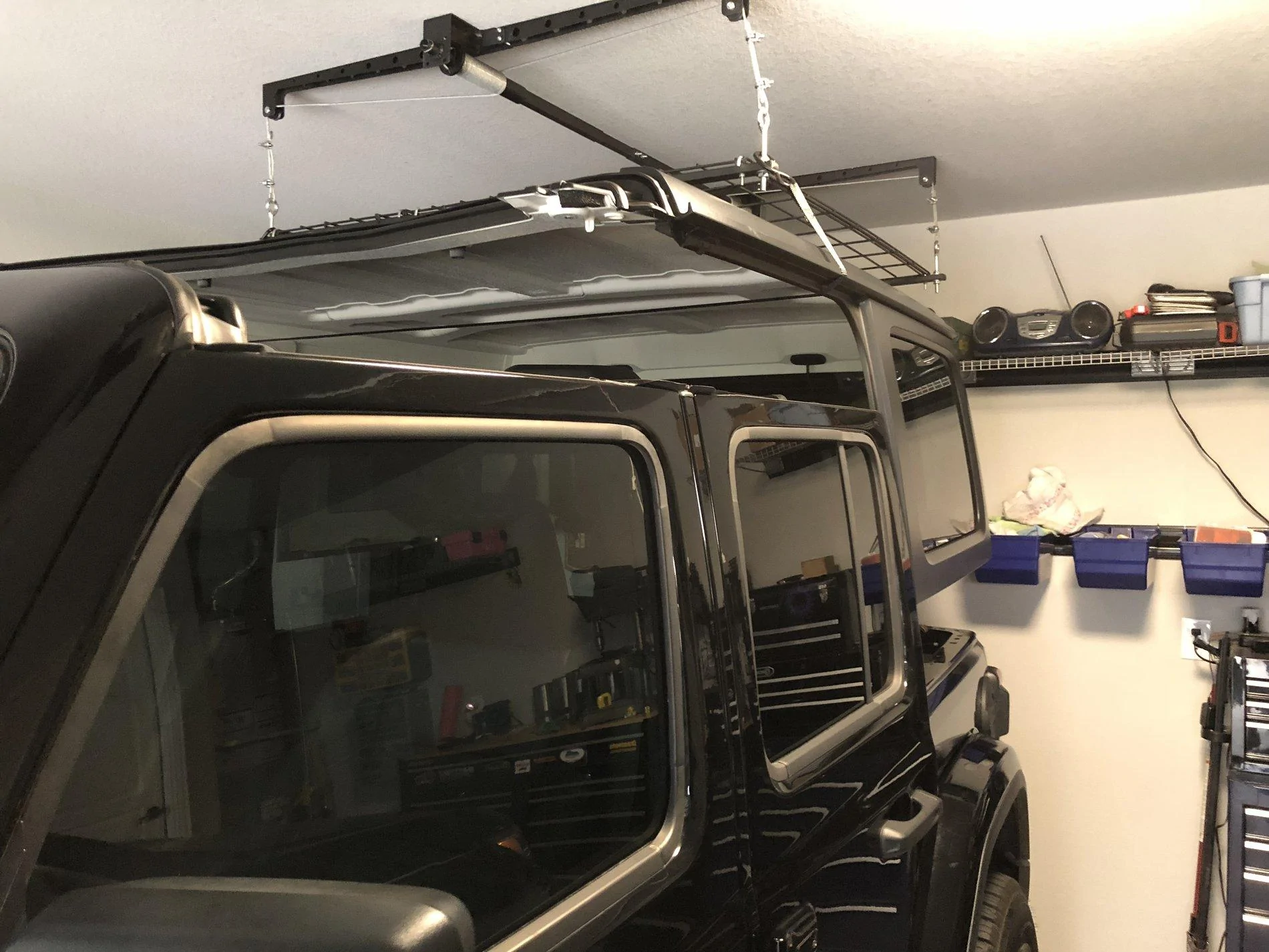

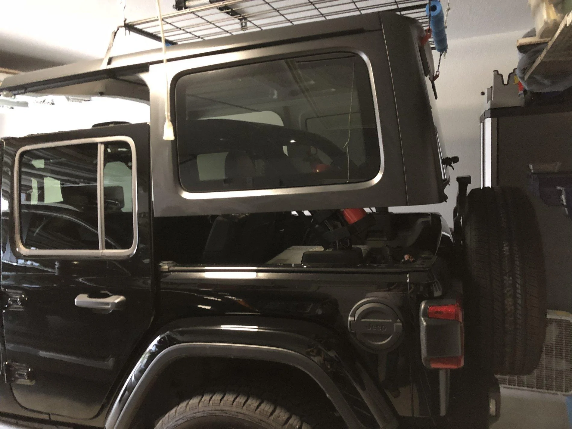

Harken Hoister with Topsy lift brackets on the back. Works like a champ, easy 1 hand lift. Definitely recommend.
Put an X on the floor directly below hitch ball and I can line it up perfect using the backup camera.

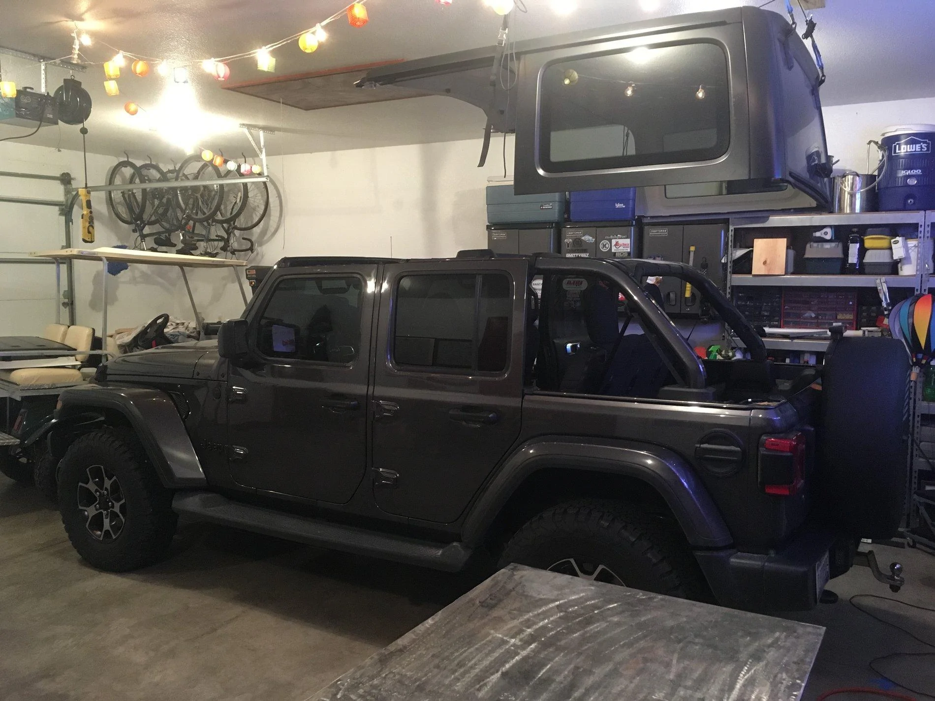

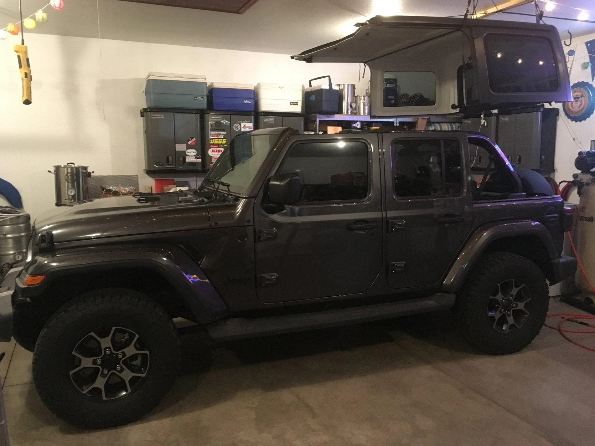

So, I went on amazon and bought an electric hoist for $90, went to Lowes and bought a couple more pulleys, and hopefully this coming weekend, get the hoist and pulleys mounted, and cut and rebuild my lines.
I am going to build a box frame to lower down on top of the jeeps top, then strap the top to the frame and lift. I did not like the rear window hook that came with the kit, and especially did not like that you have to leave the window open to use it. I may look into some of those rear window hinge hooks, I think those would also help stabilize the top when lifted.

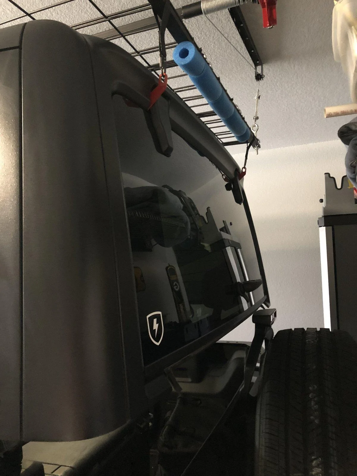

I have the hand crank version of the Lange hoist. Forget cranking by hand, just remove the crank along with the square crank locking bracket. Tighten down the lock nut on the crank and get yourself a deep socket that fits the nut (I forgot the size). Then use a cordless drill to raise or lower it, it works great!
I agree the Lange rear hook is terrible. I used the Topsy brackets along with their T-Bar adapter (http://topsyproducts.com/products/hinge_hook_hoist_bracket) and it’s way better then the Lange hook. I can not take credit for this as this idea came from TXRUBICON. His original post can be found here https://www.jlwranglerforums.com/fo...-a-top-into-something-usable-on-the-jl.21562/
