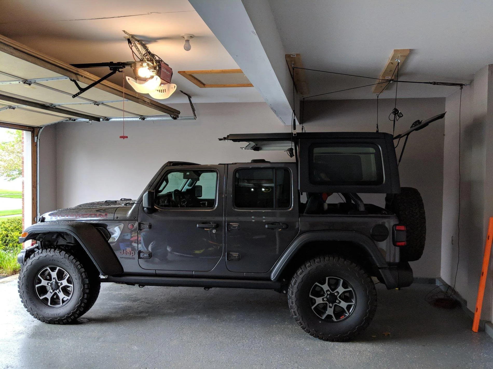

This setup was $150, harbor freight electric hoist was %20 off with coupon. Top is going to be off for 6 months so i did not want it hanging. Another reason i did not go with racor, along with their stupid price fluctuations.
