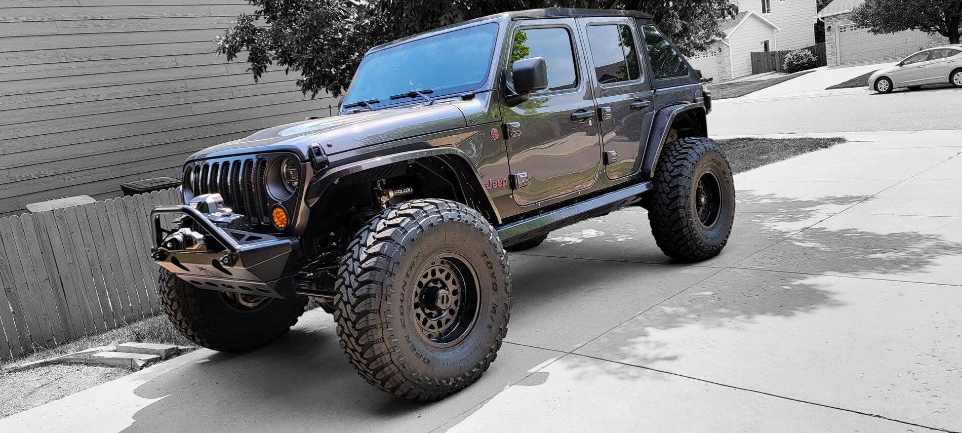

Bored. Painted my wheels solid black. Thinking about changing out my shocks. The RK springs with the Falcon shocks are starting to wear on me.
What are some decent bolt on shocks without spending $3k on custom tuned BS?

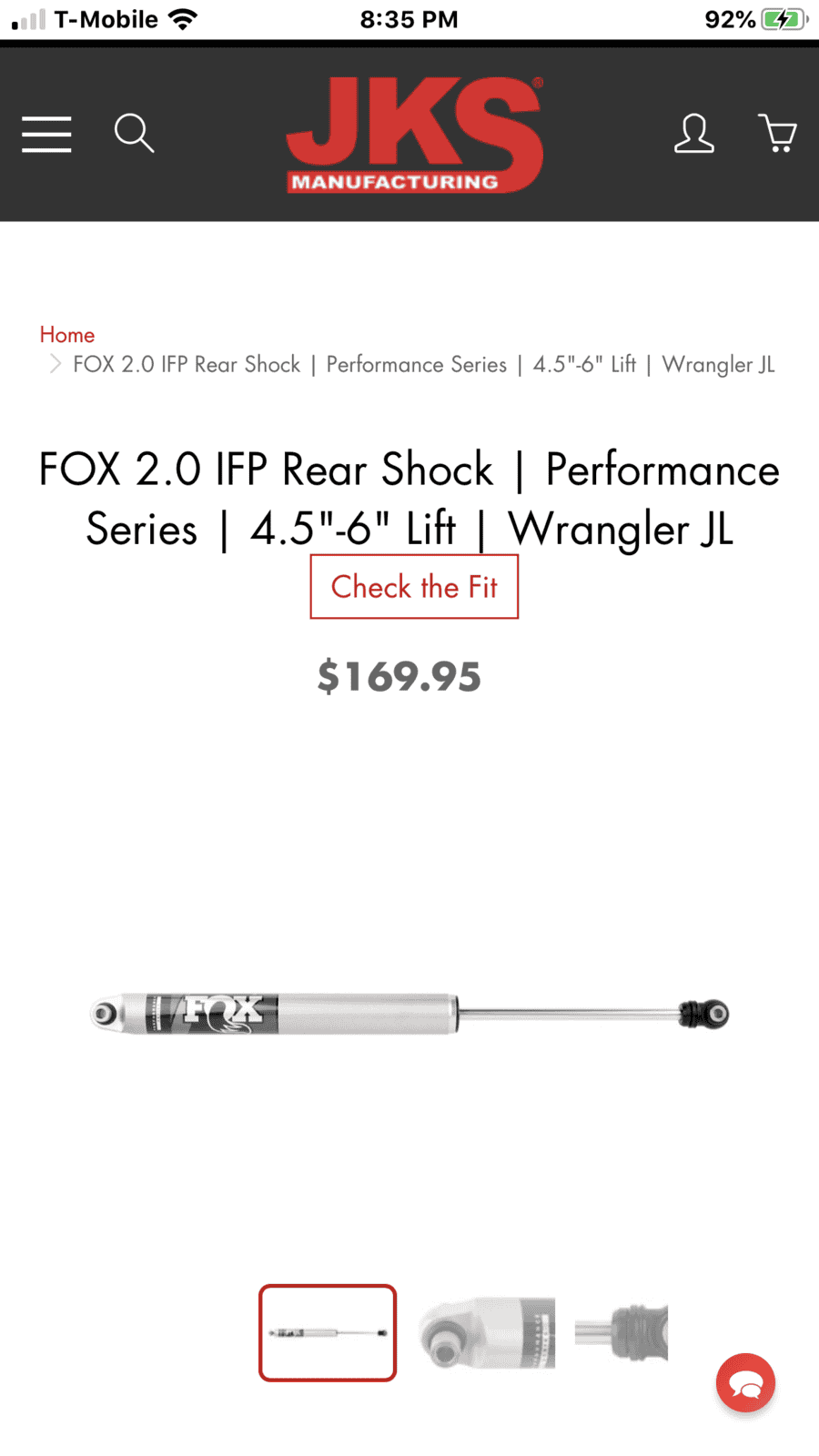

Just meant the Fox 2.0 shocks. They are roughly $150=$170ish depending where you get those from.
So.... thinking this direction to get me over the ride hump. There are some other options coming up next year or so that really peak my interest to make a full change. So let's talk the Fox2.0's.
The JKS setup seems to be for their dual rate coils. How would they pair to the RK Triple rate springs? Because I can also change the springs to Teraflex to get a desired result.
Choices suck. :LOL:
